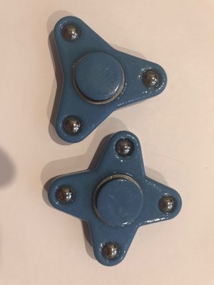

I have printed several objects now using the .35 and .5 nozzle at .2 layer height. I found that with higher layer heights the filament blobs together and looks sloppy. I have not calibrated it. I simply copied the PLA settings in Simplify 3D. Dropping the support resolution down to 2mm fixed the problem of the supports not popping off. The transparent filament must have to printed in vase mode or thin walls, if not, all you see clearly is the the infill.

- Polished Fidget Spinner
