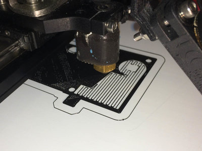

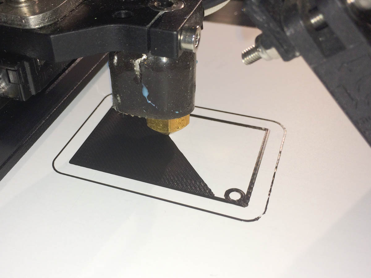

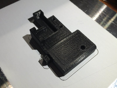

I picked up a can on my way home from work tonight to test out. I print a lot of black so I figured white would be better to see what was going on with the first layer.
The first layer went down nice and stuck pretty well. I had a slight bit of corner lift by the end but my z height was not set perfect so it's not a perfectly accurate test yet.

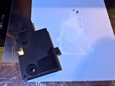

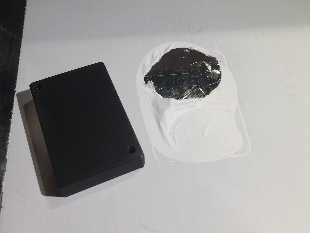

When I tried to pop the part off unfortunately the paint came with it as seen here. Again this was just a quick test.... I only let the paint dry for maybe 2 hours before printing on it and the bed still might have been a tad bit warm when I popped the print. I'm going to respray it in the morning it let it dry for 12 hours and give it another test tomorrow night.

Bummer to see that. Did you clean the surface you were spraying on to before you sprayed? I did 3 coats - fairly thickly and allowed each one to dry about 30 minutes between recoats (very warm here so quick drying to the touch). I then allowed the whole thing to set for at least 6 hours.

I'm not trying to be negative, and you stated it yourself, but that Z is way to close, very very smashed, hence the trouble getting it off.
