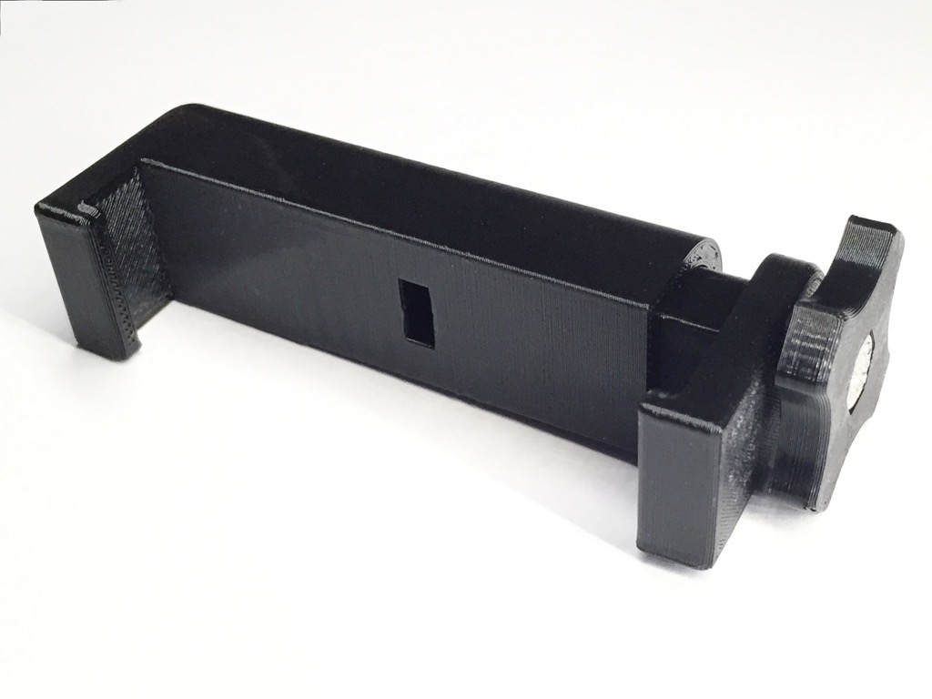

I designed and made this thing: http://www.thingiverse.com/thing:918608/

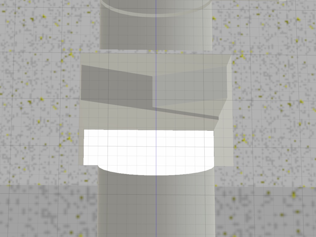

A cutaway view of the model from the back, looking up:

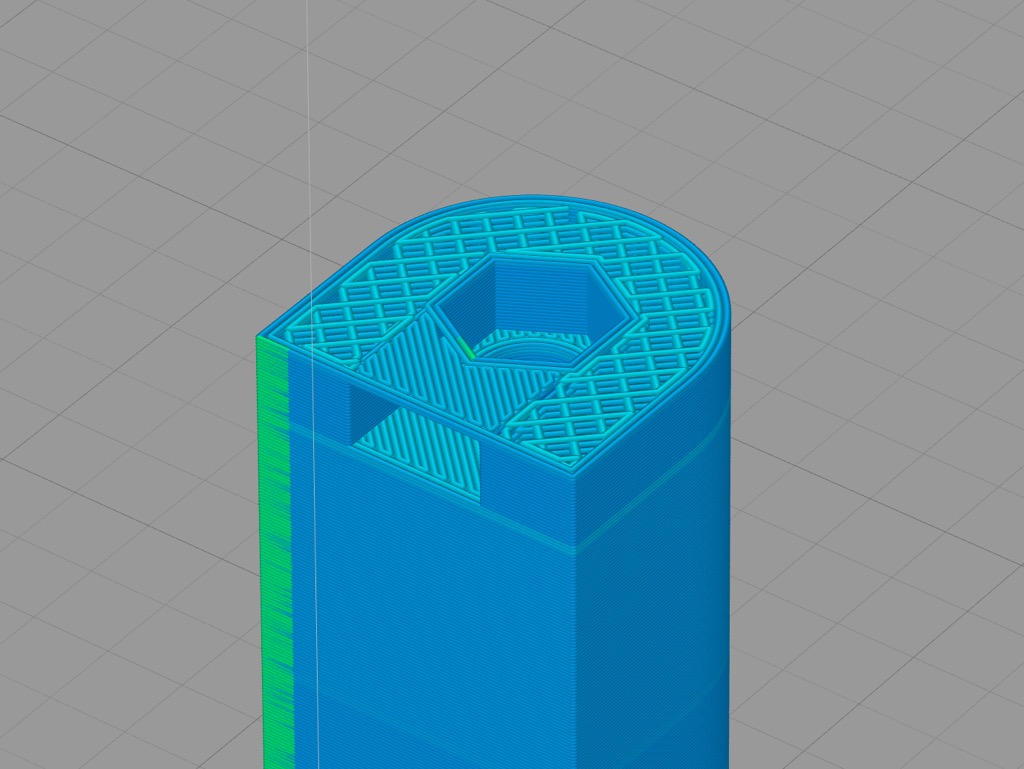

First bridge layer:

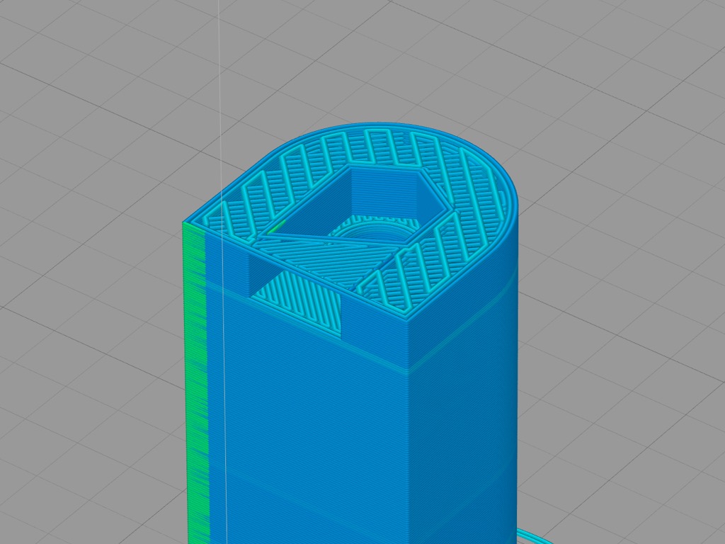

Turning the corner in the second layer:
