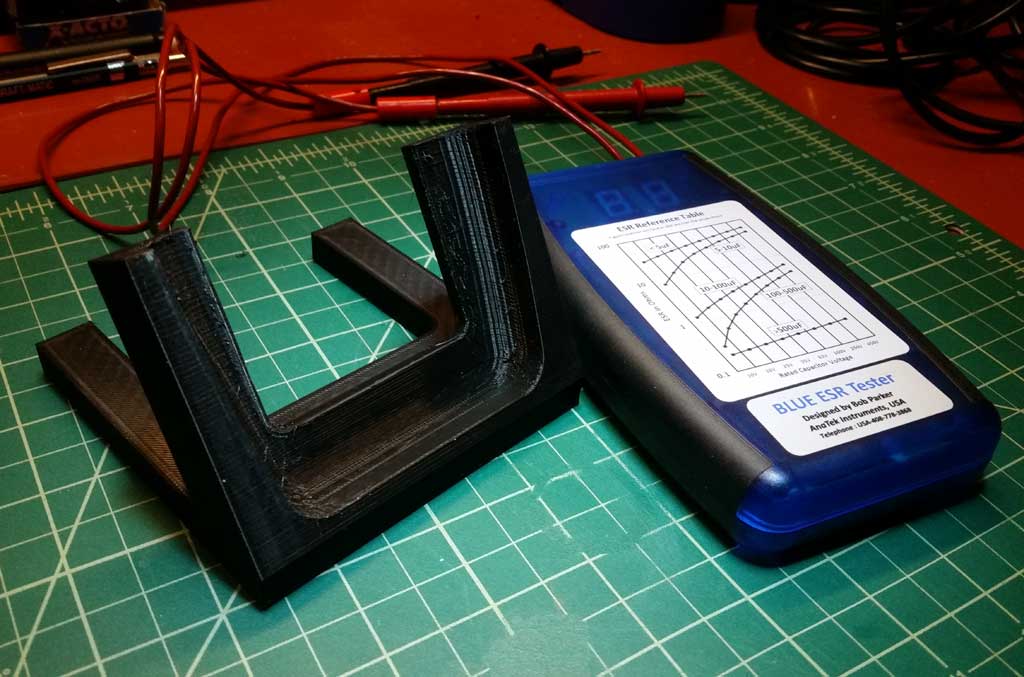

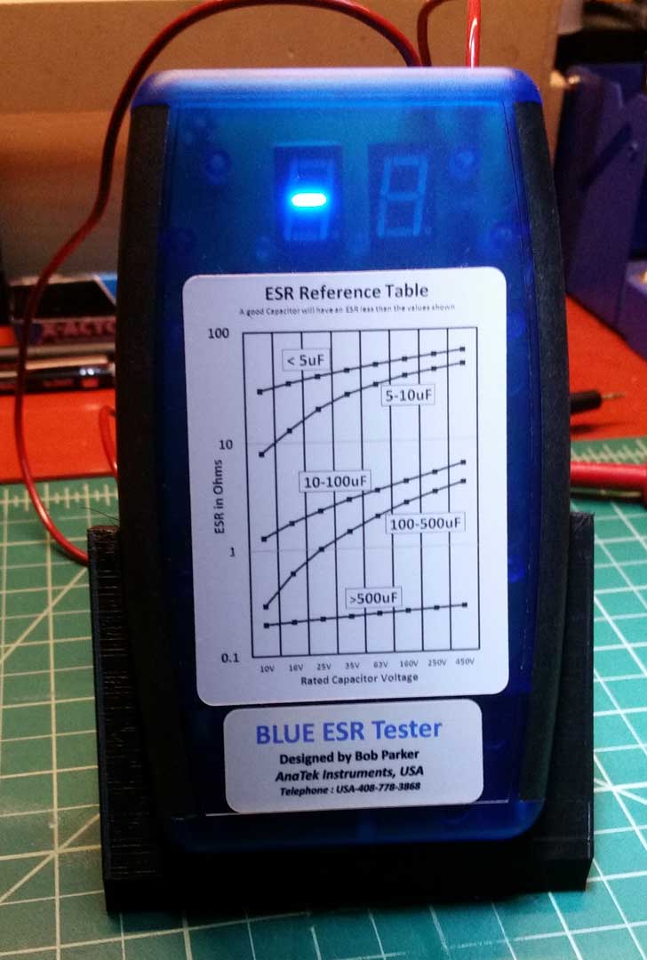

Thought I'd share another one for anyone that has this meter.
Printed in eSun black PLA+:

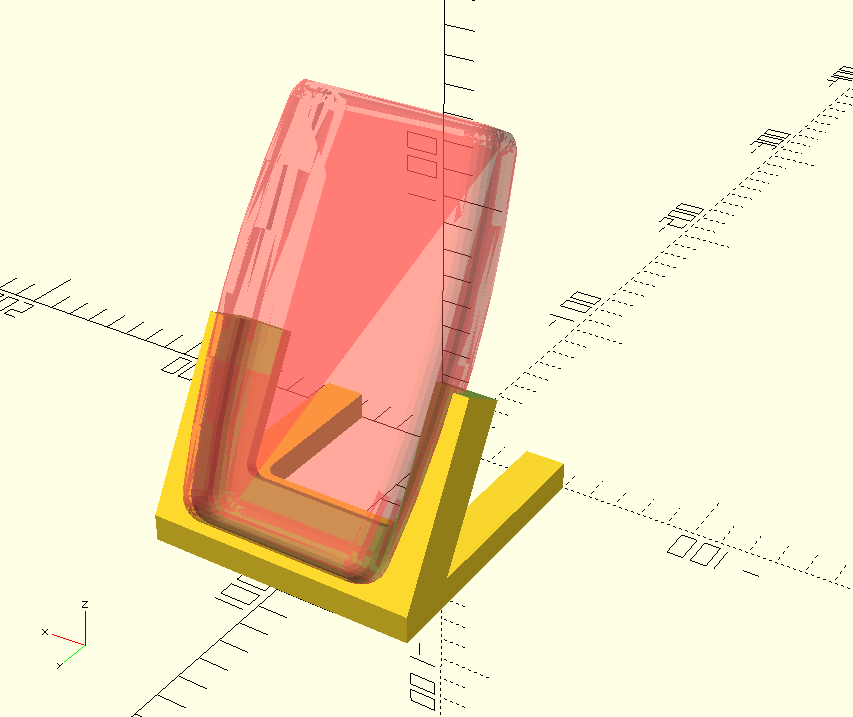

The case is one of the 1553 series from Hammond Manufacturing and they helpfully provide the .IGS and .STP files. So I ran the STEP through 3D Transform's online service and generated the STL.
Then I used that model as a "negative" to hollow out space in OpenSCAD.
OpenSCAD file including the STL for the case:

I'm not sure if it comes across in the pics but I did have some stringing issues with PLA+. The surface finish is gorgeous so the clean-up isn't really worrying me (plus it's my new right-hand extruder and I'm super pleased being able to switch between the dual extruders for single-filament prints).
As it's nothing I can't clean up with the X-Acto, my first course of action will be messing with retraction settings in Slic3r. I'm using 215-218 hot end temp as per a few of your and Insta's posts here.
Any thoughts about stringing with PLA+?

I haven't tried to print something that has that large of a gap between the posts in PLA+, so I haven't run into it myself. (That shape would be one prone to stringing.) Definitely tweak the retraction a bit...it should help. Maybe a slightly lower temp.... just a few degrees. And you can up the print speed some to give the nozzle less time to be inactive and drooling.
Oh, and rotate the shape on the bed so that the fan points at the nozzle all the time while it travels from one post to the other....(orient the holder along the Y axis instead of the X axis). Keeping the fan pointed at the nozzle path as much as possible can really help with drool strings. :D
