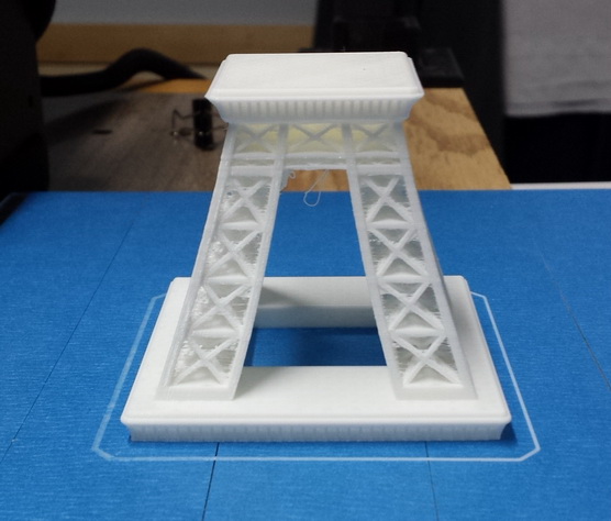

Just a quick update. Level 2 came out as the others have, needing lots of hand finishing to remove strings.
Level 2

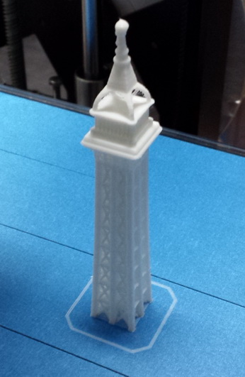

However, the top level needs some fine tuning as the very top, which is supposed to be circular, came out a bit lopsided. I was there when it was printed and slowed the feed down 40%, but no luck. I'm going to modify the S3D process and run it again tomorrow.
The top Level

If it were me, I'd split the top spire at the last platform and just print the top with many skirt layers to form a shell to allow the thin bits to cool between layers.
What temperatures are you running at? I've found very little stringing at 225 for PLA with 1mm retraction at 3000 mm/min. Lower temperatures: less stringing, worse layer bonding, higher possibility of a clog if you drop too low. Higher temperatures: easier flow for fast print speeds, maybe better surface finish, increased stringing.

Thanks for the suggestion jsc, I did indeed drop the top level down (in S3D) so as to print only the very top spire. As an added measure, I printed two spires, one 20mm behind the other. My thinking, as novice as it is when it comes to 3D printing, is that while the back spire is printing, the front spire is right under the 50mm fan getting all the cooling it can. I was thinking of adding a dwell between layers, but I didn't want the molten plastic staying in the hot end and clumping when it finally started flowing again (if that makes any sense). The twin prints seemed less problematic.

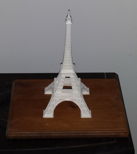

So now the printing is complete and I have just two days to deburr, assemble and mount the project. Don't you just love how time flies when your on vacation or have an important project to complete. Here's a pic of the tower on the base.
Mike H.
