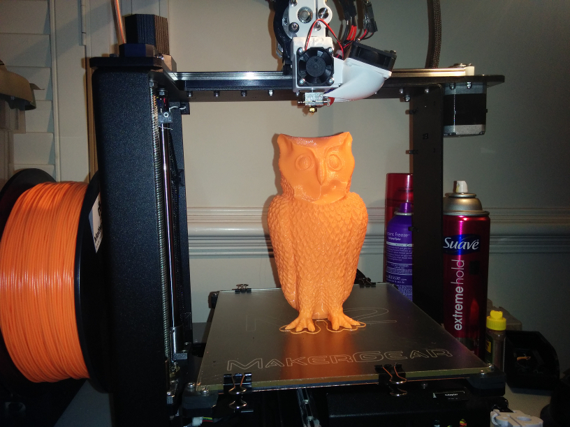

Post by Dale Reed » Fri Mar 27, 2015 10:29 pm
Should get the full 200 with the V4 single. I took off my V4 dual and mounted the single, and I had to adjust the Z screw to bring the bed up about 8 mm higher at home. The model clears the bottom of the screws holding the X rail by about 2 mm.

Post by Bratag » Sat Mar 28, 2015 3:49 am
Had plenty of room in the end.Now if you will excuse me I need to go drill a 5/64th of an inch hole in something .... :D

Post by Dale Reed » Sun Mar 29, 2015 2:43 am
You can tell a lot about an M2 user by the hair spray he/she uses... How do you like the Suave? I know jimc is a fan of Garnier Fructis #5. I need to finish off my can of Aqua Net extra super hold #3 first.
It would be fun to set up a camera in the hair care aisle at a grocery in Silicon Valley and see how many 3D print nerds buy some. I wonder if Fry's Electronics sells hair spray in the 3D printing aisle...

Post by jsc » Sun Mar 29, 2015 3:23 am
I tried Suave Extreme Hold in a pump, #8. They had #10s, but they came in an aerosol can, and I wanted to try to stay away from that. I am not impressed. Very limited adhesion. Aqua Net on the other hand works quite well, but I have to dismount the bed, give it a coat, wait to dry, repeat... And then you don't want to repeat that process every print, so it turns into a gamble of will it hold or not.
