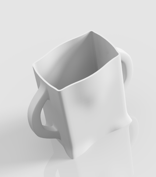

I decided to bite the bullet and learn Autodesk Fusion 360 for real. There's no better way to learn a tool than to use it, so I used it to design a juicebox holder (holds juice boxes/bags, which prevents kids from squeezing them and making a mess). My first attempt is at http://www.thingiverse.com/thing:474487, but I just finished a redraw as a single T-spline form:
Fusion 360 looks to be very powerful, and is free for hobbyist use.

For example, my juicebox form has solid handles, and the inside surface follows the outside at a 1.6mm (4 perimeters) offset. I tried several attacks before I got something workable:
Create a cube of the appropriate dimensions with three way symmetry.
Crease the top and bottom.
Draw an arc for the rough path of the handle on the XY plane using a circle, project, and trim tools.
Bridge portions of the left or right side along the arc to form the handle.
Sculpt the handle to make it look okay, and make sure that no overhang is much more than 45 degrees.
Clear symmetry and re-establish it for length/width.
Sculpt the body to get the mouth flare and foot corner bulges.
At this point, you could just shell off the top and be done, but that leaves you with holes through the interior of the handles, and that's not what I wanted. The solution I came up with was to remove the top off the box, leaving you with a 2D surface and thicken up that surface. Now you have the same thing as the shelled surface, but it is still all in the same form object, so you can unweld edges around the handle holes so you can then delete them. Then you have to patch up the holes left in the interior surface, and I found that you can either use "fix hole" in the sculpt environment, or create patches in the patch environment. The second route ended up with a smoother surface, so I went with that.
