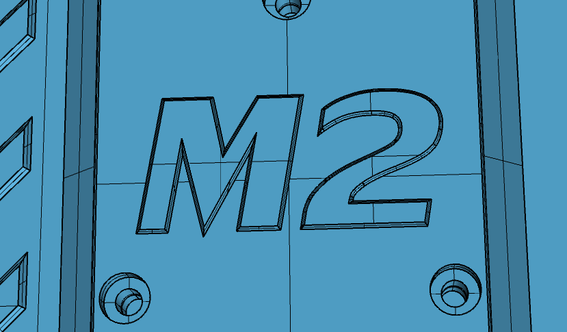

tim, i put the m2 on a few of my parts like the electronics box, e3d cover and fan guards. i am messing with fonts and 2d design software almost on a daily basis and out of 1000's of fonts i have, i could not find a matching one. for either the m or the 2. i have a feeling its not a font and its a drawn logo. perhaps it started with a font and was tweaked to some degree. the m2 i use for my parts is close. it looks similar but a little more crisp with some sharper corners. i can give it to you of you want it. not sure in what format you would like it in and either 2d or 3d. let me know.

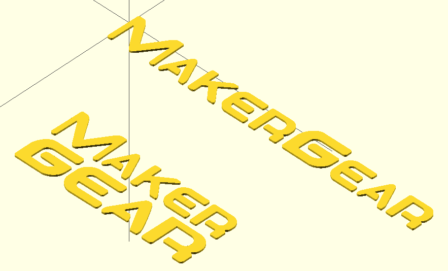

Well, that was considerably less painful than I expected. Plus, now I know the flow for turning line drawings into STL files. . .
For anyone interested:
(1) I took a photo of the MakerGear sticker
(2) I imported the photo as a background image into xcircuit (a tool I like a lot, because I wrote it. . .), then did a line drawing over the character outlines.
(3) Exported the file as an SVG from xcircuit
(4) Imported the SVG file into Inkscape (if I were better at Inkscape, I probably could have done step 2 in Inscape and skipped steps 3 and 4)
(5) Used the nifty method at http://www.thingiverse.com/thing:14221, which sets up Inkscape with an extension to write OpenSCAD-compatible DXF files
(6) Exported OpenSCAD-compatible DXF from Inkscape
(7) Imported the DXF into OpenSCAD
(8) Compile and Render in OpenSCAD
(9) Export STL from OpenSCAD
Complicated, yes. But it works!!
The attached zip file contains all the files generated except the original photograph.
MakerGear logo!
maker_gear_logo.zip
Set of files for the MakerGear logo
(130.54 KiB) Downloaded 863 times
