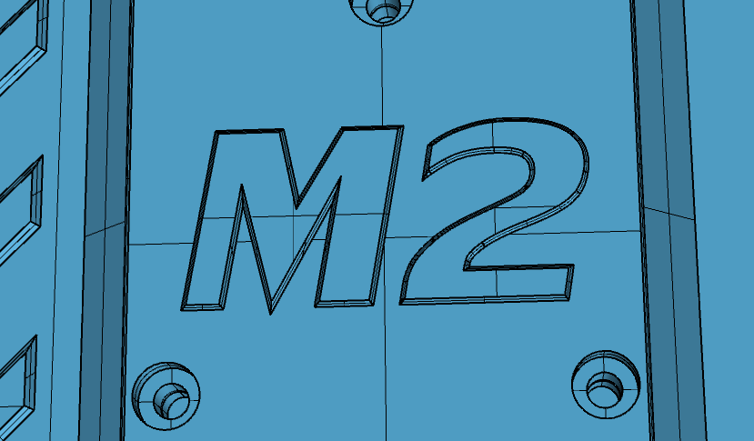

tim, i put the m2 on a few of my parts like the electronics box, e3d cover and fan guards. i am messing with fonts and 2d design software almost on a daily basis and out of 1000's of fonts i have, i could not find a matching one. for either the m or the 2. i have a feeling its not a font and its a drawn logo. perhaps it started with a font and was tweaked to some degree. the m2 i use for my parts is close. it looks similar but a little more crisp with some sharper corners. i can give it to you of you want it. not sure in what format you would like it in and either 2d or 3d. let me know.

That's okay; I think I will go the route with a photo and a bump map. It's a good technique to learn how to do well, anyway.
