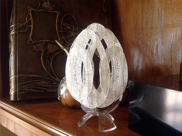

Just in case anyone (besides me) has trouble coming up with ideas, I knocked out a quick-print Lace Egg and just uploaded it to Thingie.......
Print it with the following settings to get the lace effect:
Top Layers: 0
Bottom Layers: 0
Perimeter: 1
Infill: 20%
Layer Height: 0.2 mm
Extrusion Width: 0.4 mm
And I threw in an assembly diagram. (You guys probably don't need it, but I put it in for beginners.) :)
http://www.thingiverse.com/thing:788001
(The one I uploaded has a slightly flat bottom, and does not need a stand....I just happened to have one around.)

Post by jereywolf » Thu Apr 23, 2015 11:45 am
That's really cool! A great gift for Mom.

Post by jimc » Thu Apr 23, 2015 3:13 pm
Came out really nice

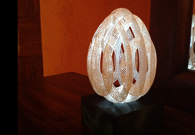

Post by Jules » Sun Apr 26, 2015 3:02 pm
I got my LED tea lights in yesterday, they don't put out a heck of a lot of light, but I do like the effect....
This is the little egg sitting on a rough shell base...
Egg Lamp.jpg (207.53 KiB) Viewed 19982 times
I need to fiddle with attaching it to the base somehow, and definitely need to thicken the sides, (or go with a solid), since the Rhino shell default is a bit thin, but it gets the idea across, and I wanted to print a quick base first to see if I even liked it before spending a lot of time on it.

Post by lem » Sun Apr 26, 2015 3:57 pm
Plug for MakerGear.
Upgrade to dual V4, print the base, switch extruder, print lace :roll:
Actually, looks pretty good to me.

Post by sdigs » Mon Apr 27, 2015 6:05 pm
This looks great. I am going to make this and see how it works. I do think it looks great with a base, might look for some colored LED's
