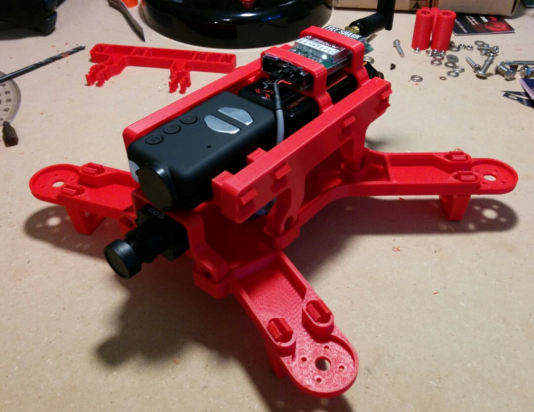

These were all prototyped and developed using my M2. I love it!
T4 Quadcopter
T4 Quadcopter Mini 250
T6 Hexacopter

I REALLY like the T4 design. I've started printing with the latest version of Simplify3D using the PLA and medium quality settings. As the parts print out, I can "see" the time and effort you have put into the design and modeling.
I however, am having a bit of difficulty getting the large parts to print properly. I did not change any gcode or fff settings (total noob), but I did start with a nice clean (and I think level) glass with good coating of aquanet. When I import the file they came in with the aft portion of the large parts toward the front of the M2 bed, I did not change them.
The main body took 10:45 to print and was looking really good, flat, and well adhered before I left it to print. This morning when I took it off the bed there was some distortion on the forward part of the body (from the aft portion of the print bed). The aft arms fit perfectly, but there is enough distortion in the main body that the forward arms do not fit at all.
So I have a question or three: Did you make any mods to the S3D print settings before starting to print? What is your technique for bed adhesion for large prints? Do you think spinning the file 180 degrees on the bed would help?
Any advice you have would be greatly appreciated!!

For large prints, try glue stick. With PLA, it is super super strong. To make it easier to unplate, I would suggest maybe giving it a very light coat everywhere (rubbed lightly with a damp paper towel), then give it the beans at the corners and ends of long beams. Using Toby's M2 logo bed background thing makes it a lot easier to visualize where to do it.
I've attached my settings if it helps. You may need to tweak the extrusion multiplier to suit your PLA. I make sure the glass is clean and then apply a layer of budget hairspray. I've printed a quite a few bodies now (prototypes) and haven't had any need to rotate the object.
Did the forward part lift of the bed? Perhaps you could post a photo that shows the "distortion". Some of the gurus here might be able to offer some suggestions if they can see the problem?
BTW. Thanks for choosing to make a T4. I've been hearing from lots of happy makers out there so I'm sure you'll enjoy it once you get it completed :-)
