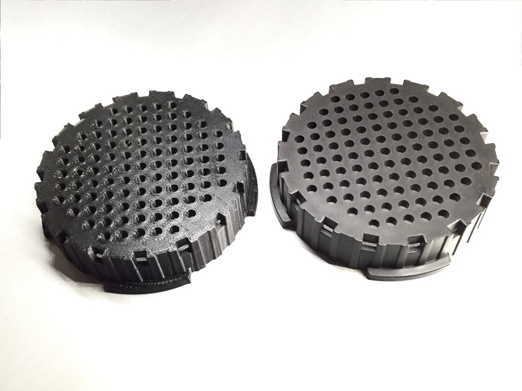

I recently got my second aeropress coffee maker, after having lost the filter cap to my first one years ago. That trauma prodded me to model a replacement
top
Admittedly, I didn't really think this through when I started, about the whole "nearly boiling water and plastic" aspect of its intended use. Looking at glass transition temperature tables, it could conceivably work in nylon, and possibly with ABS, HIPS, or PETG. Nylon and PETG would probably be the best from a food safety perspective.
http://www.thingiverse.com/thing:802915
Oh, and here's a replacement filter holder that can take a double stack of filters. Not nearly as complex to model:
http://www.thingiverse.com/thing:792350

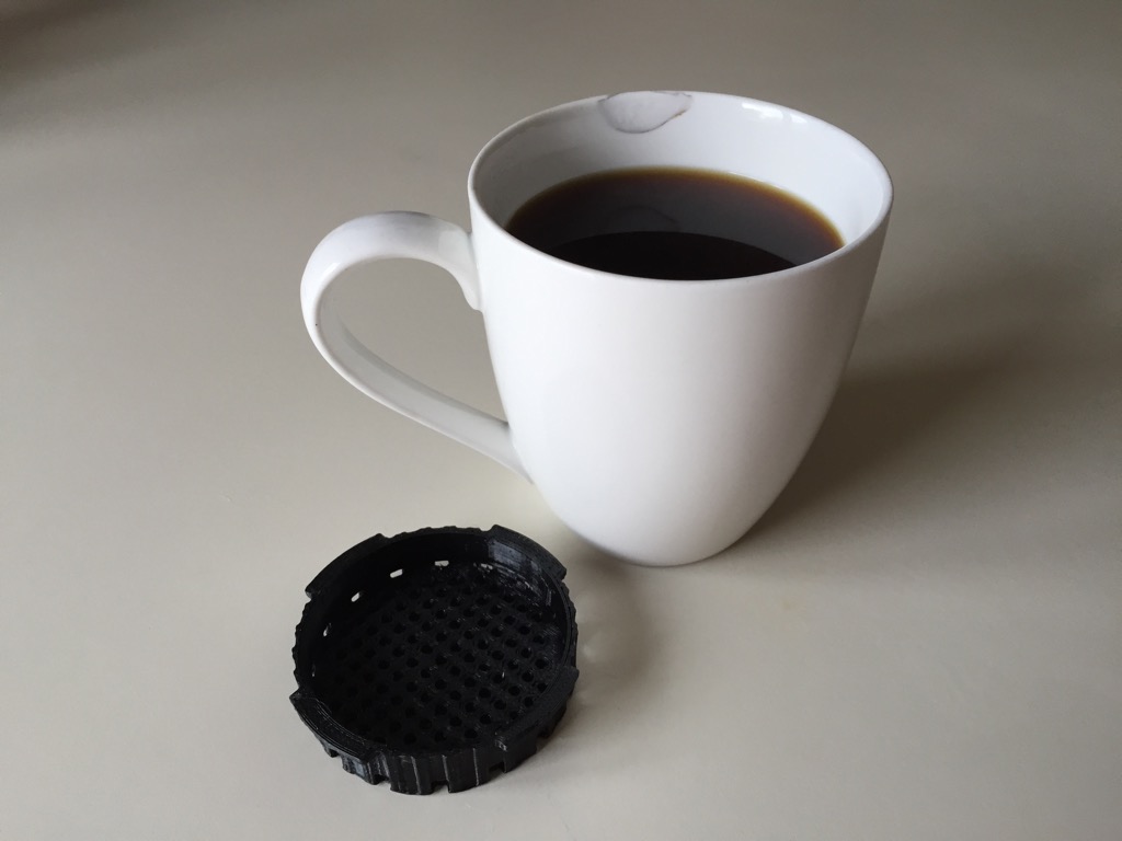

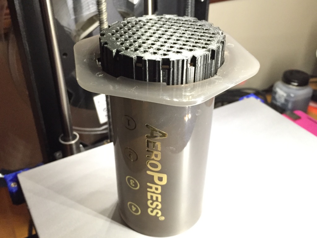

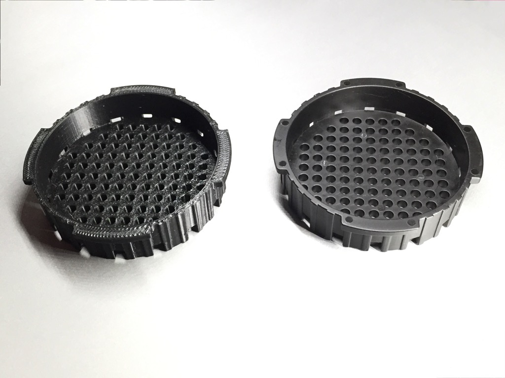

rsilvers printed me one in polycarbonate. Here's the print, along with the delicious mug of coffee it made. I'm still alive....
