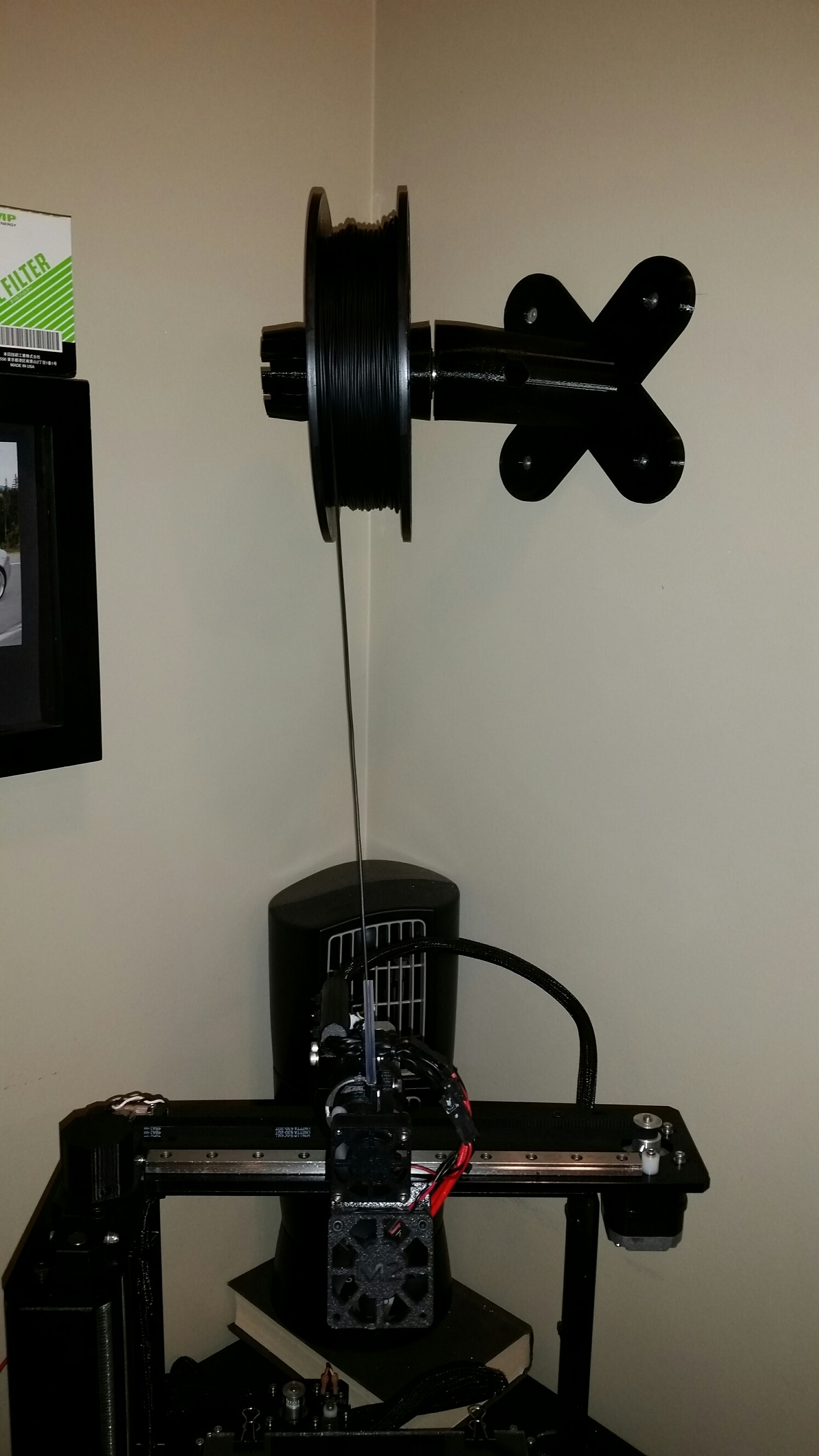

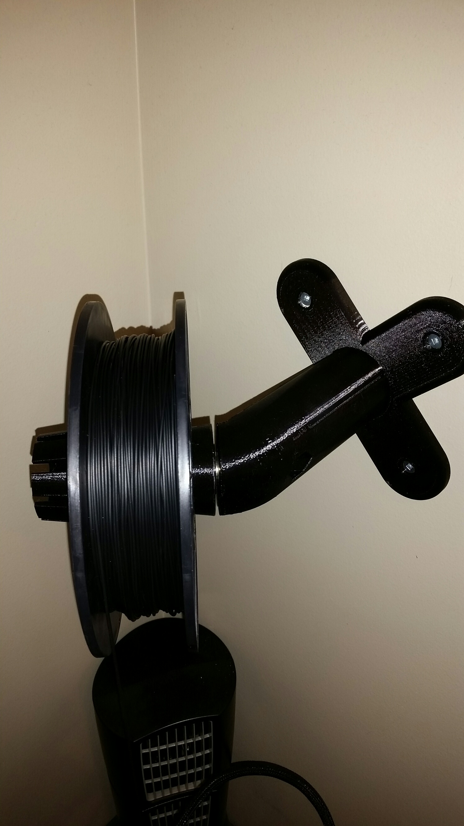

it was driving me nuts having my ninjaflex dragging so hard in the guide tube that it pretty much prevented it from printing, so I took Dale Reeds idea and ran with it (thank you sir!)
My M2 is in a corner so I make it at a 45 degree angle and made it compatible with many different types of spools, they slide easily on and off but wont come off unless you're removing them.
Thought I would share

Nooice! If you have printed it and have it mounted and working, please post a photo of it in action here (or in Printed Object Showcase) and/or add the photo to your Thingiverse page. Just because the pictures on that page don't make it clear what the final orientation would be. (I think I have it figured out, but best to be Captain Obvious in this regard!) I assume it mounts on one of the walls near the corner above the M2, which is sitting at a 45-degree angle to the two walls forming the corner. Is that right?

the printer is at a 45 degree angle in a corner and yes the spool holder will go above it, between the corner and the printer, I wanted it to be back a bit from the printer so that there wouldnt be as much issue for occasions when the print head was on the far opposite side of where the filament was exiting the spool. its gonna be a 10 hr print so I'm gonna start it pretty quick here and I will try to get it assembled and mounted tomorrow evening. I already have the spindle portion printed, just need to print the base. once its up I'll post some pics

Got it assembled and mounted today, it actually rotates a bit too easily so I had to put a bit of drag on the bearings to prevent it from unwrapping the spool unintentionally

Yep, that's how I thought. A shrunk version of that last photo would be good to include on your Thingie page. Perfect! Takes the friction in the tubing out of the picture entirely.
