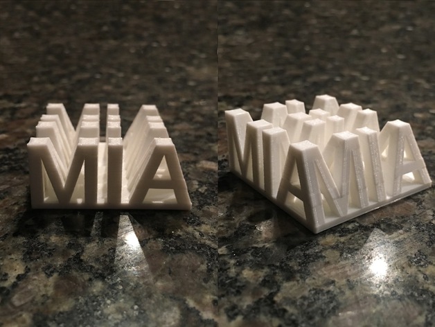

Every once in a while I get a simple idea and play the "win Thingiverse" game. OpenSCAD is good for that since it stays on the front page slightly longer under the customizable section. Here's my latest attempt: http://www.thingiverse.com/thing:1250852
The idea this time was to take two text extrusions and take their intersection (and plop it on a base to hold it all together). This was made easier because Thingiverse appears to have updated their OpenSCAD version to be reasonably up-to-date.
Actually printing one is an enormous challenge, because any support at all and you will never be able to dig it out. Thus, you are restricted to a very limited set of capital letters, of which, happily, my example print is made out of entirely. This is a good test case for dissolvable support.

That is a cool effect. Wonder if you could tweak it to use other two dimensional shapes other than just text. Might help with that win thingiverse :)
