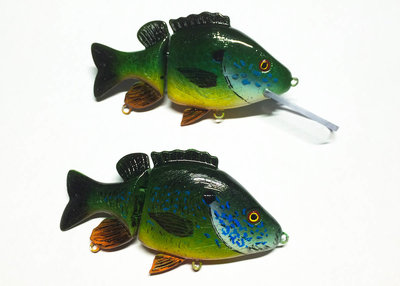

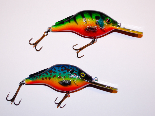

I am an avid fisherman, and buy unpainted crankbait blanks to custom paint them. I would like try printing some blanks, but new to printing and design software. Thingiverse has a few. Does anyone have stl files for lures they would be willing to share? The following links show examples of both an unpainted blank and finished lure. Thanks.

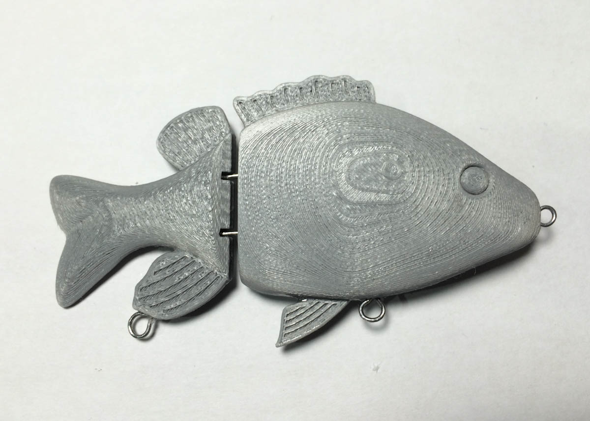

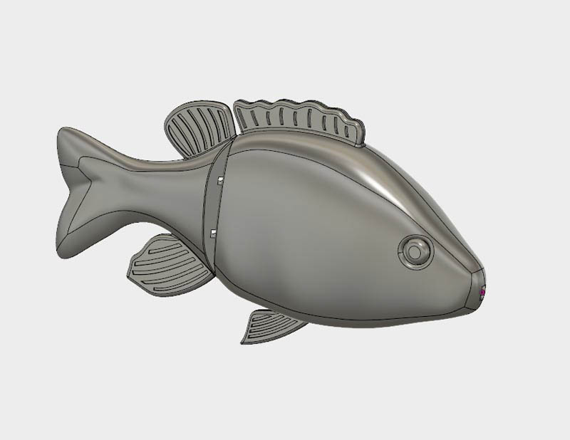

Here's another lure from concept to completion. This was my first go at using Fusion360 and while I found it a bit limited compared to Solidworks it's a very impressive program especially the sculpting environment.
I started with a picture of a actual fish I caught.
Using the sculpting environment of Fusion360 it was surprisingly easy to get the basic shape. Adding the other features just evolved basic sketches and extrudes but this is the basic lure design so far. I wanted to add more features like fins and gills but thats where the limited part of Fusion came in. I can't figure out how to do offset extrudes.

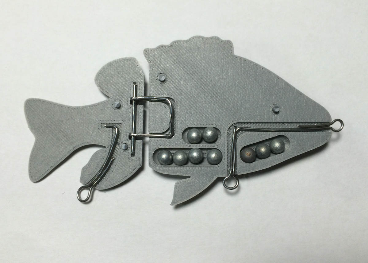

The lure is printed flat in two halves (well four pieces because it's jointed) then glued together.
The finished print....
...and the completed project after a bit of airbrushing and sealing. I just need to add hooks and test it out.
STL's coming soon to a Thingiverse near you...............................
