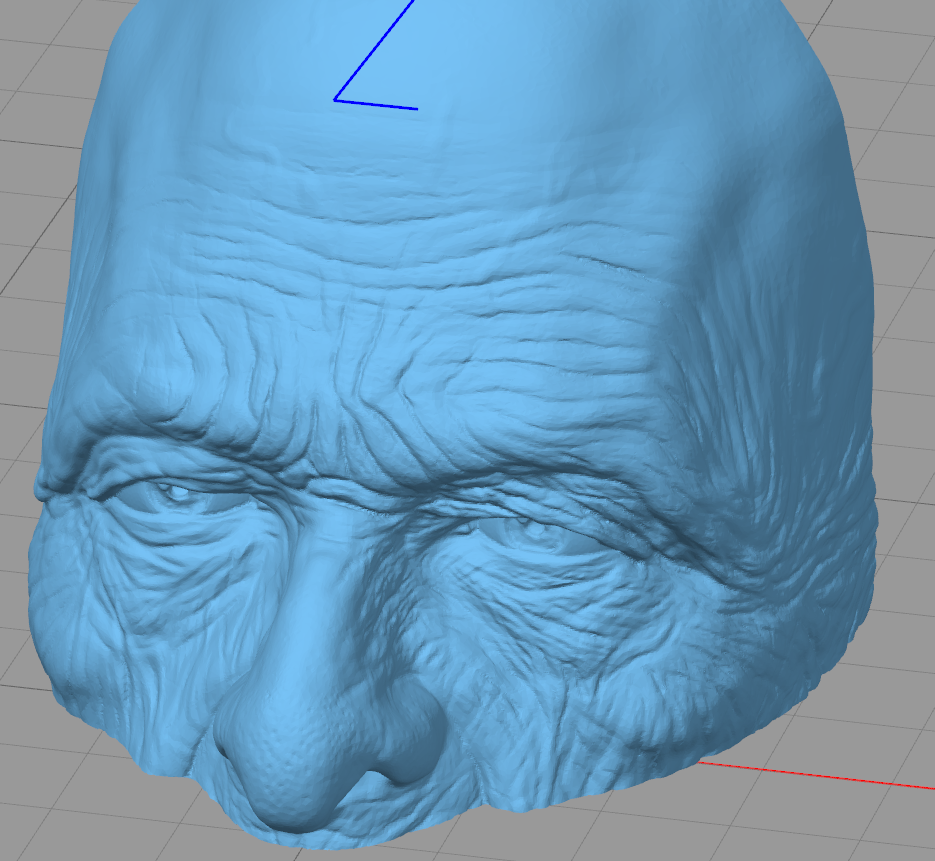

Yeah, I don't expect to eliminate ringing with the M2, just hoping I can reduce it vs my current printer. Here is a screengrab of the model. You can see there are some prominent wrinkles along the cheeks, but obviously the print has ringing issues as well.

Post that STL (zip it to attach) and then say you don't think the M2 can print it well. You'll get about 17 people trying ;) (Cunningham's law)

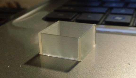

This was a test cube I was working on in the 100 micron arena.
TEST CUBE

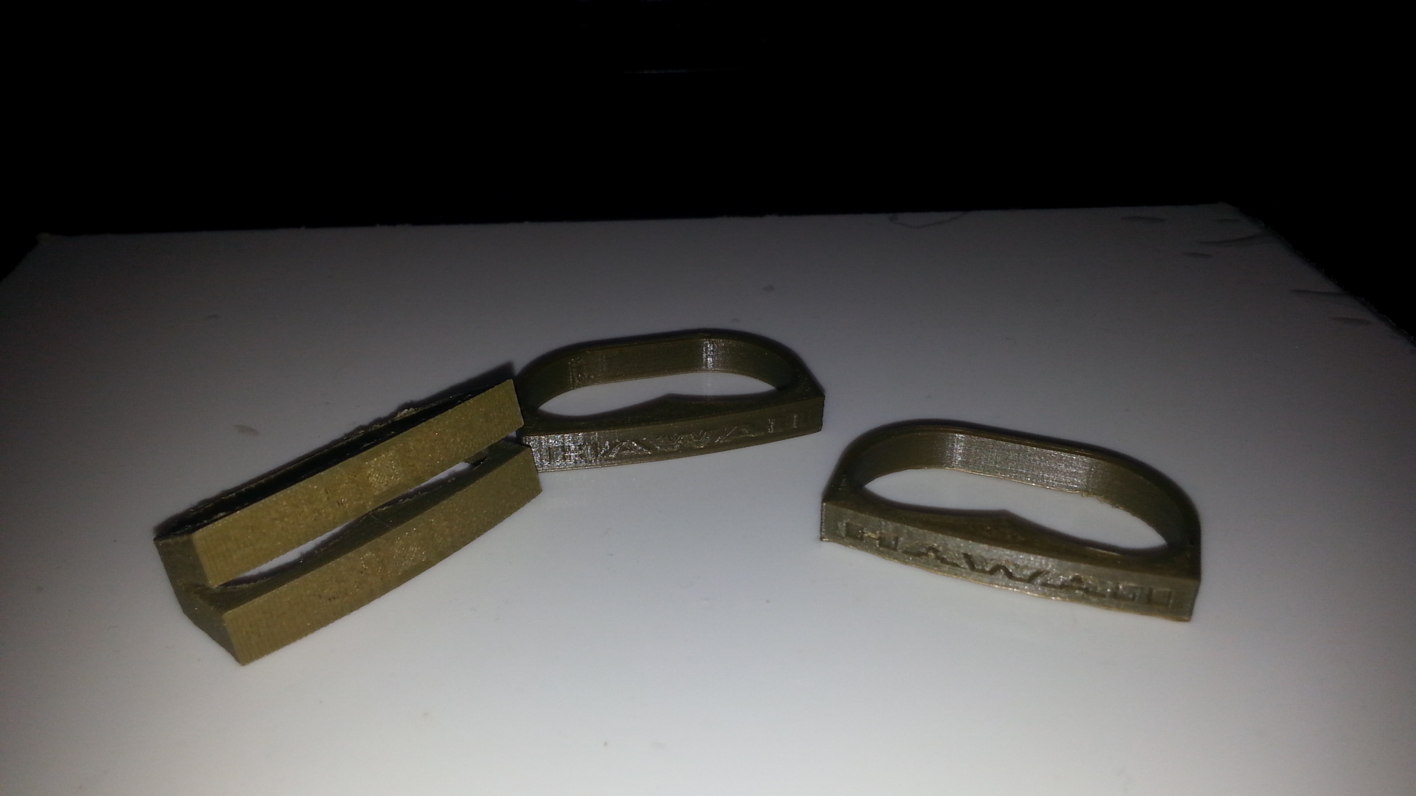

I'll play, here's some 0.08 on old Ultimachine PLA
(371.02 KiB) Downloaded 341 times
