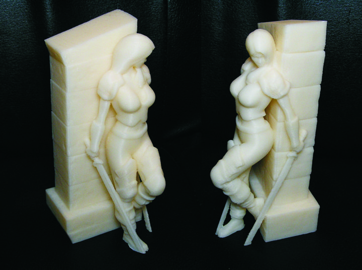

Post by Slipshine » Tue Apr 21, 2015 5:54 pm
BAD GIRL
Re: Fantasy Statue
Post by Jules » Tue Apr 21, 2015 8:52 pm
Nice bookends! :lol:
PcS
Posts: 667
Location: Michigan
Re: Fantasy Statue
Post by PcS » Tue Apr 21, 2015 11:40 pm
They look awesome !!! What's the material ??? Settings ????
rsilvers
Posts: 185
Re: Fantasy Statue
Post by rsilvers » Wed Apr 22, 2015 1:27 am
I will guess - natural ABS.
PcS
Posts: 667
Location: Michigan
Re: Fantasy Statue
Post by PcS » Wed Apr 22, 2015 1:43 am
rsilvers wrote:I will guess - natural ABS.
I thought natural...but was not sure if it was pla or abs. :D
Slipshine
Posts: 182
Re: Fantasy Statue
Post by Slipshine » Wed Apr 22, 2015 6:07 pm
Natural ABS - Was the correct guess.
The print is from awhile ago so I went and looked up what I was doing back then.
Layer thickness .15 - I note I took from the taulman nylon guys where they said don't print a layer thicker than 1/2 your nozzle diam.
I also try and have a extrusion rate high enough to keep the diam being extruded at about .6 mm this makes for good layer to layer bonding.
Printed on Kapton Tape. - When the Heated bed is warming up to 105° C at about 60°C I wipe it down with 91% alcohol so it is squeaky clean.
I haven't had to print in a box as I am only using about 30% fill and the model has enough open areas to relive the stress to keep it from cracking.
(along with what is mentioned above). It is in a room in the corner with a shelf overhead and the door closed when printing to keep drafts down to a min.
I hope I didn't miss anything.
rsilvers
Posts: 185
Re: Fantasy Statue
Post by rsilvers » Wed Apr 22, 2015 11:05 pm
Thicker layers are stronger. Thinner layers tend to look better. So not sure about that 1/2 nozzle diameter thing.
http://my3dmatter.com/influence-infill- ... n/#more-95
rsilvers
Posts: 185
Re: Fantasy Statue
Post by rsilvers » Fri Apr 24, 2015 4:25 am
ABS looks waxy - like Ivory - with more diffuse reflection and with less visible layers.
PLA has more specular highlights, more visible layers, ringing, and zits.
