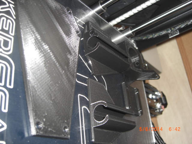

is that a 90 degree overhang printed with no support?
Re: tricopter prototype
It's bridged. That's allowed!
not accusing. i'm being impressed! that came out very clean. nice work.

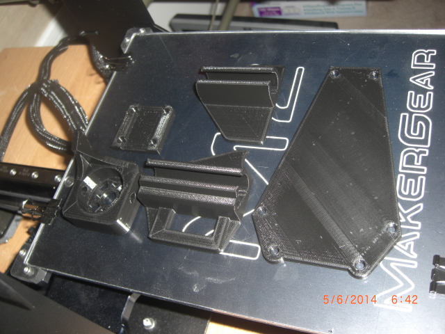

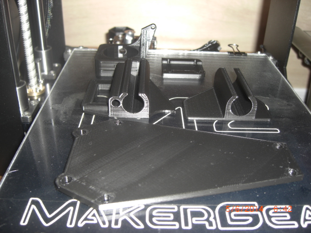

kosal850,
Nice adhesion on the corners for such large area prints! What's your bed prep? Also, if you start having problems with the corners lifting (big "IF" from what I see, though!), if you can round them off a tad without compromising the fit into the design, that helps a lot. Not sure what you're using for design, but using the "minkoski" operator in OpenSCAD with a cylinder whose radius is the desired curve radius at the corners is a great way to do this.
Very nice quality! Can't wait to see your pictures/videos of this bird flying!
