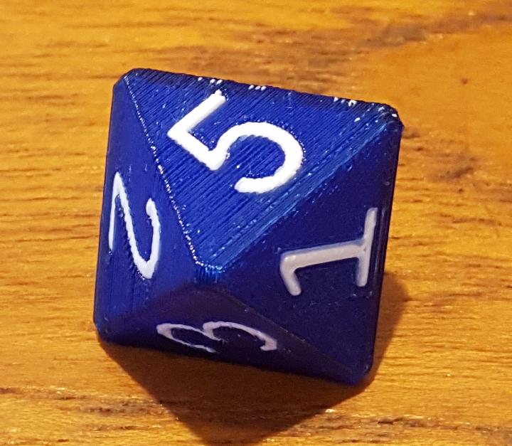

For a long time, I've been wanting to print a dual extruder piece using an opaque white PETg core under a few layers of translucent PETg in any of the available colors. I finally got around to doing that, and the result is just as fantastic as I hoped it would be. This is something that hybridprinter talked about a while ago---printing digits that connect from the surface all the way down to the core of a print so that they cannot be rubbed, filed, or sanded off.
Octahedral die, dual extrusion PETg translucent and opaque combination

I found one trick, which is that if the part you are printing is smaller than the distance between the two extruders (31mm), then the extruder that is inactive is always dripping outside of the print, and always wipes itself off on the ooze shield as it comes into position, which makes for a much cleaner two-color print. Unfortunately that doesn't work with large prints.

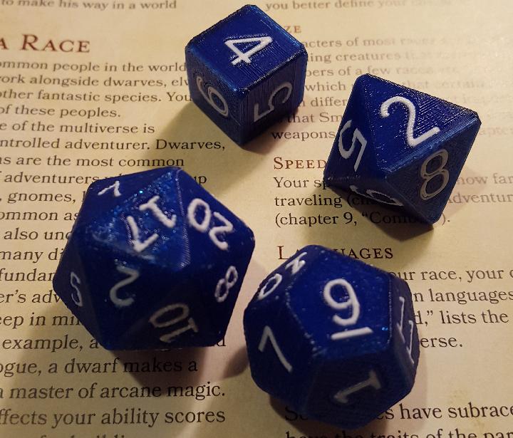

I mentioned hybridprinter, but maybe it was you that first mentioned the dual extrusion keys. It was a while ago. The printing for calculator keys would probably be no more than one filament width wide, which would make it quite tricky. On my 20-sided die, though, the lettering is about 4mm tall and quite legible. Even the ones that were printing upside-down at the most severe angle, which is more than a 45 degree lean. That's bigger than the traditional HP calculator keys, but not unreasonable for a calculator, in general.
