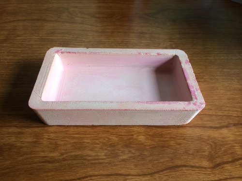

Funny you should mention food coloring:
It works, not brilliantly. Google "plaster sidewalk chalk" and you will see people having good success with tempera paints.
