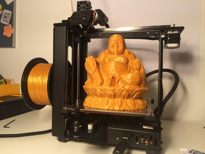

Buddha Sculpture
Buddha Sculpture
Re: Buddha Sculpture
That's big!
Great job as usual!
Great job as usual!
What type of filament did you use and how much of it did it take?
Really good job.
Really good job.
Thank you!
I used 380g of normal PLA filament.
First layer 0.2mm, other 0.1mm
2 shells
10% infil
4 bottom solid layers
5 top solid layers
outline direction was inside-out
no support
2 shells
10% infil
5 top solid layers
no support
No support! (she squeaked!)
How long did it take?
Took 28 hours
