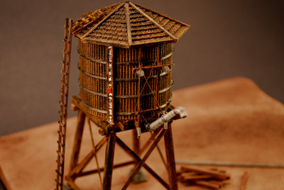

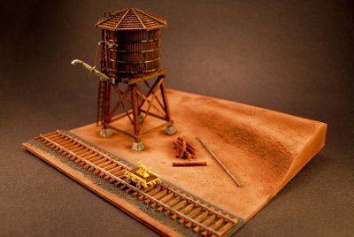

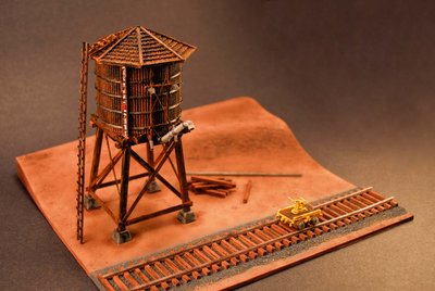

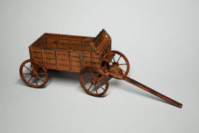

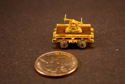

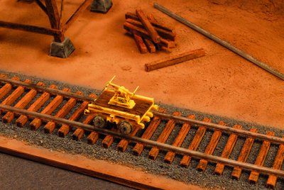

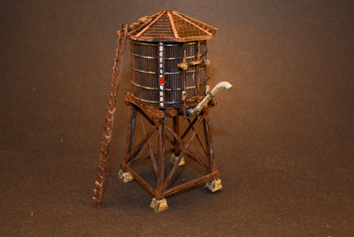

This started out as a quick little project to play around with the Hatchbox Wood filament after trying it out on this little wagon I found on thingiverse and after I started I just couldn't stop.
![Laughing :lol:](./images/smilies/icon_lol.gif)

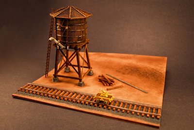

After about a week of design, printing, and painting..... This is the result.

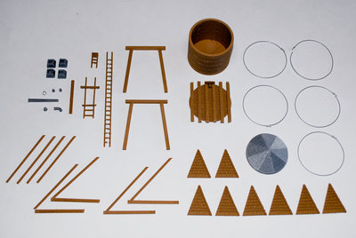

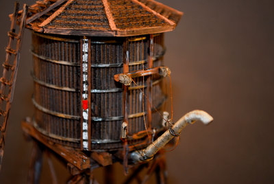

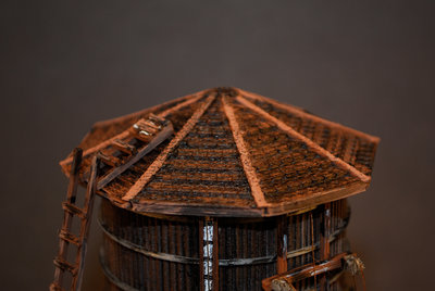

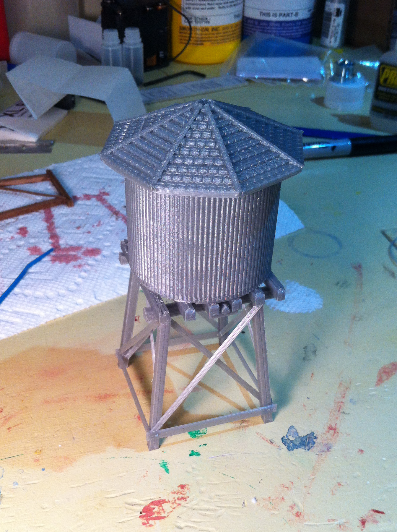

With the exception of the texture on the base and some wire bits and thread everything on this was printed.
Anything that would be wood was printed in Hatchbox (mostly with a .25 nozzle) and then stained with a gel stain and distressed by dry brushing on some black paint. All the other bits where printed in Silver PLA.
The Handcar was also printed in PLA. (the wood deck was painted on this one.)
Details of making the base can be seen HERE if interested.
