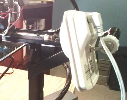

This is a camera holder for the D-Link DSC Series of IP cameras with a bracket that fits on a Makergear-M2. It may be placed in 2 positions (Vertical or horizontal) and slides in and out to "zoom". It replaces the standard camera bracket and screws into the back of the camera, which provides for swivel. The base of the bracket could also be adapted for other mountings.
On thingiverse here: http://www.thingiverse.com/thing:1002351
Also shared on Fusion 360, here:https://fusion360.autodesk.com/projects ... d-link-dcs (First experiment with Fusion)
Bracket on M2
