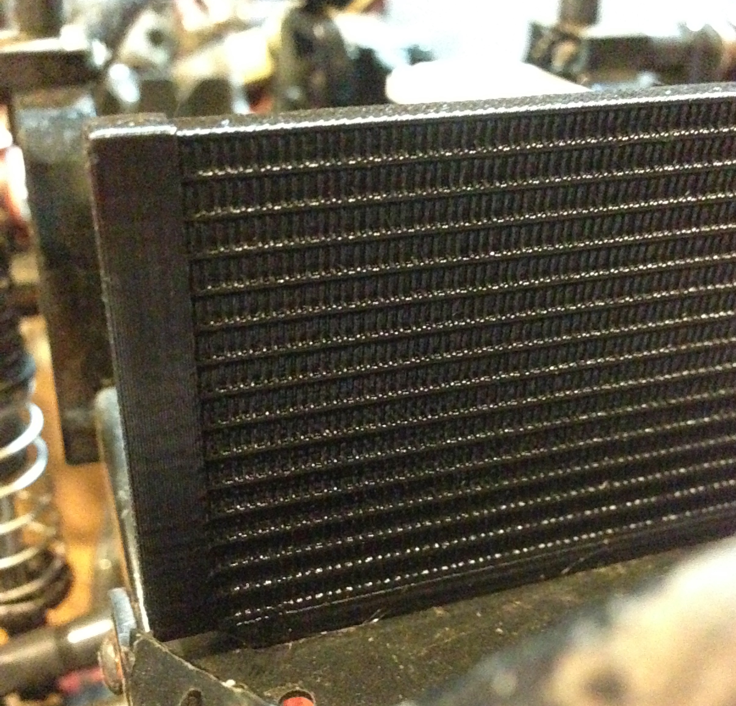

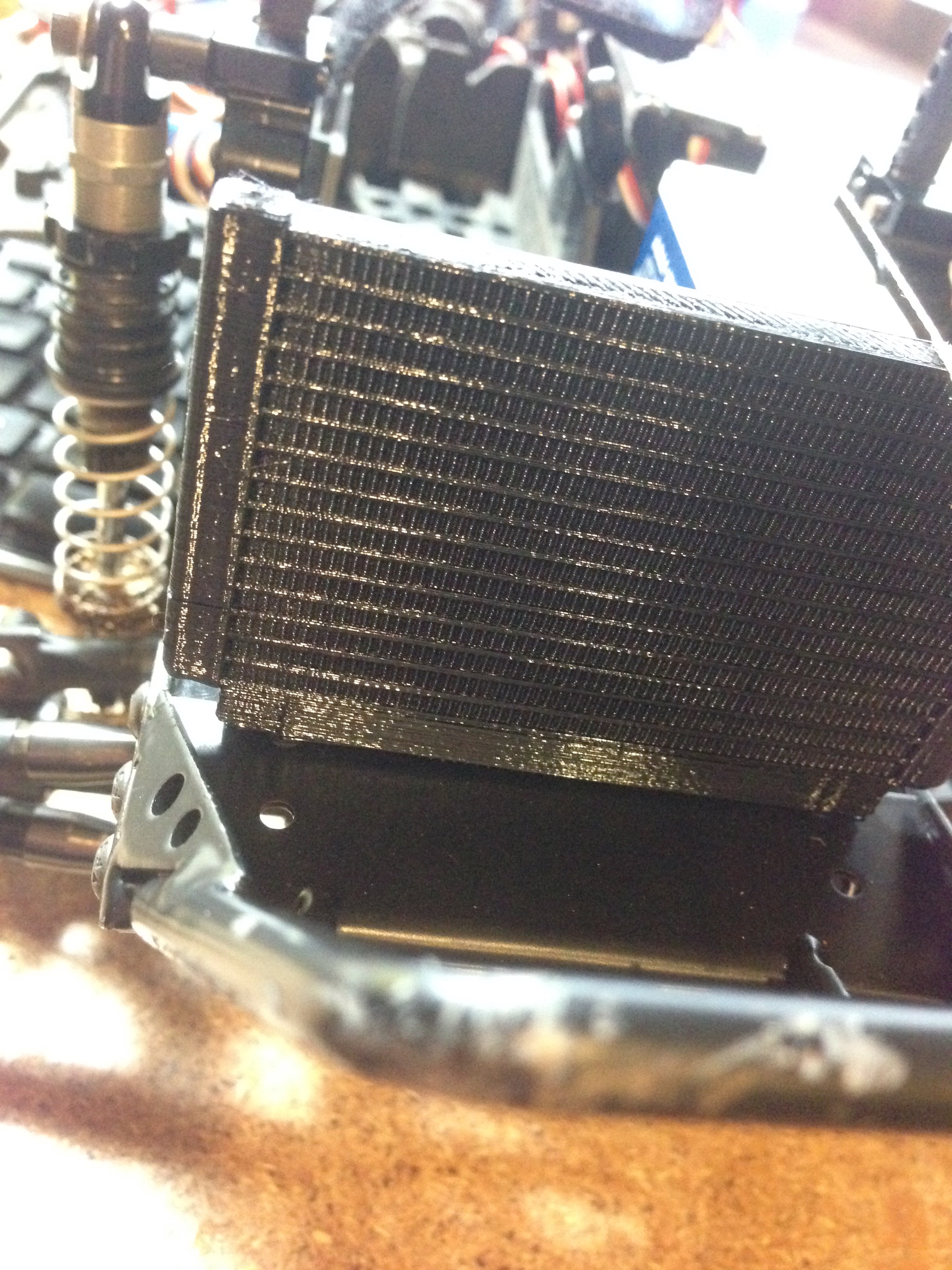

Hi, just wanted to share my radiator I designed and printed. Took me a little while to get the dimensions to print correctly. These are .4mm vertical fins, .6mm horizontal fins, and .3mm depth difference between each. Standard .35mm nozzle at .2mm layer height on petg black. I can probably get better detail going with a smaller nozzle, but I'm really happy the way this turned out. Let me know what you think.

If you build it standing on one side, rather than the bottom, you may see better results with the 0.35 mm nozzle.
The 0.4 mm vertical fins are about one thread wide, but you really need two threads to get a good peninsula in the XY plane: one thread out, one thread back.
Flipping it 90° puts the thinner fins parallel to the horizontal (XY) plane: they become exactly two layers thick (in Z) with crisp overhangs. The 0.6 mm lines become vertical and wide enough (in the XY plane) for good detail: set the slicer for two perimeter threads and they'll be solid.
Building it "sideways" may require a brim or, perhaps, mouse ears on each end to get enough footprint for good adhesion.
Nice work!

So I printed it standing up and the results were unexpected. In theory, it made sense and looking at the gcode rendering in Octoprint, it looked alright too. The print however, didn't seem to improve.
Re: Radiator for toy car.
Post by ednisley » Sun May 14, 2017 11:48 am
Quark wrote:didn't seem to improve
Hard to tell from the pix, but the whole affair looks smoother: those thin fins (vertical in the normal orientation) aren't as ragged and seem to have nicer joints with the thicker bars. Might be wishful thinking on my part, of course.
That model sits right at the limit of FDM resolution, with features about the same size as the nozzle, so you can't get vast improvements by changing orientations: hot plastic goo just can't produce sharp corners.
Building smaller details along the Z axis gives you about twice the resolution, although a factor of two seems not to make much difference. Reducing the nozzle diameter by 25% (0.35 mm → 0.25 mm) would probably have about the same (lack of) visible effect in either orientation.
Perhaps it boils down to "what looks better" for a given solid model, material, and printer.

I looked at the path it takes when the radiator is printed upright, and what seems to be happening is the small .4mm vertical fins get a single pass starting on the inside and ending on the outside, kinda like an L shape. I wonder if that is causing the filament to get more pointy, rather than making a turn for another layer thickness. Anyhow, this is probably chasing that last few percent of print quality, but I'm very satisfied with how it is.
