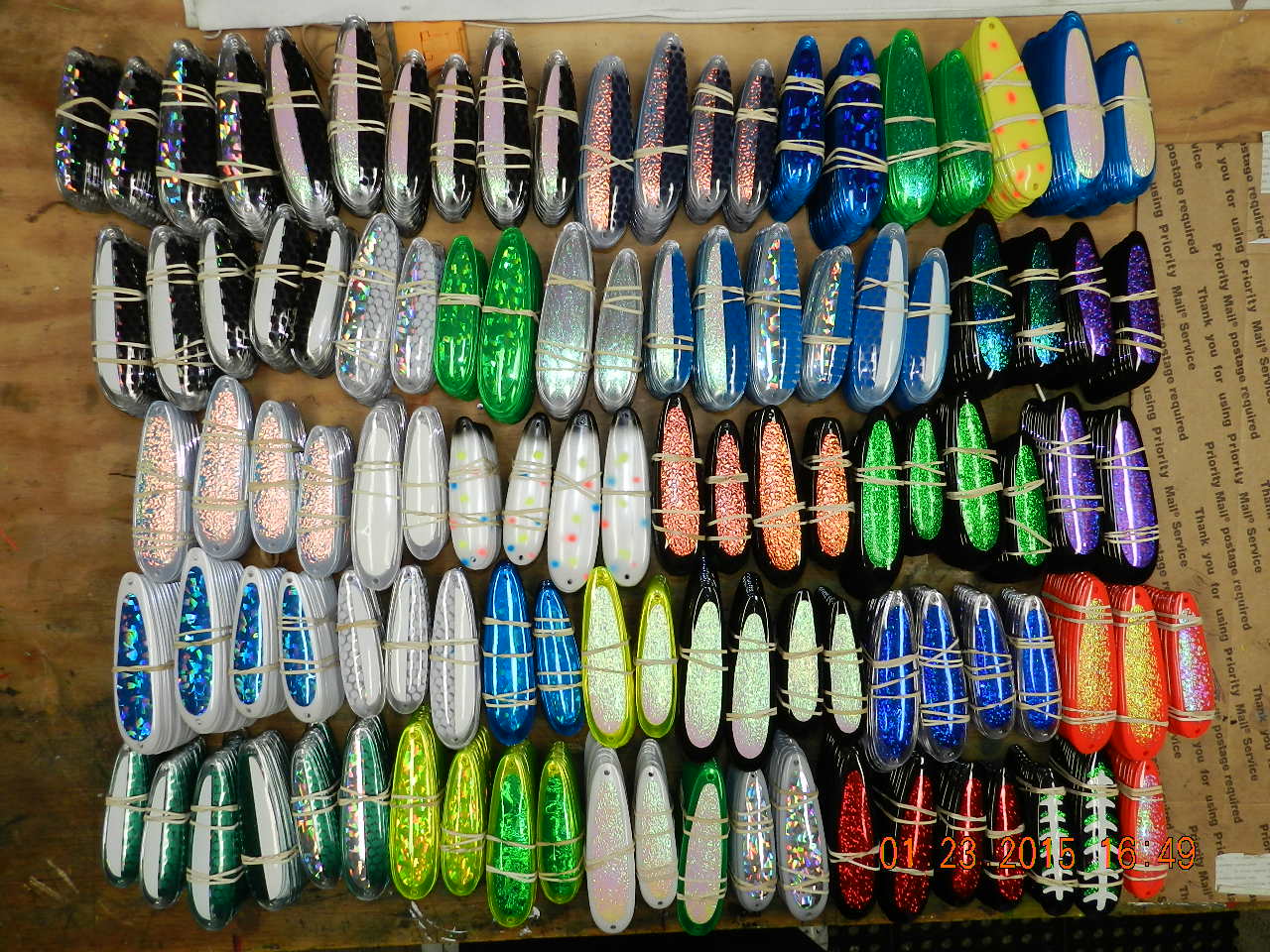

2200 spoons in production, project has come full circle made possible by
learning how to make 3D prints with the help offered here, on this board.
Thanks all for your advice!

oh man are you sitting there putting all those decals on yourself john?

Jim, got help installing the die cuts, about 3rd are my work. Will be sending you some spoon blanks soon,
just too busy for the time being.

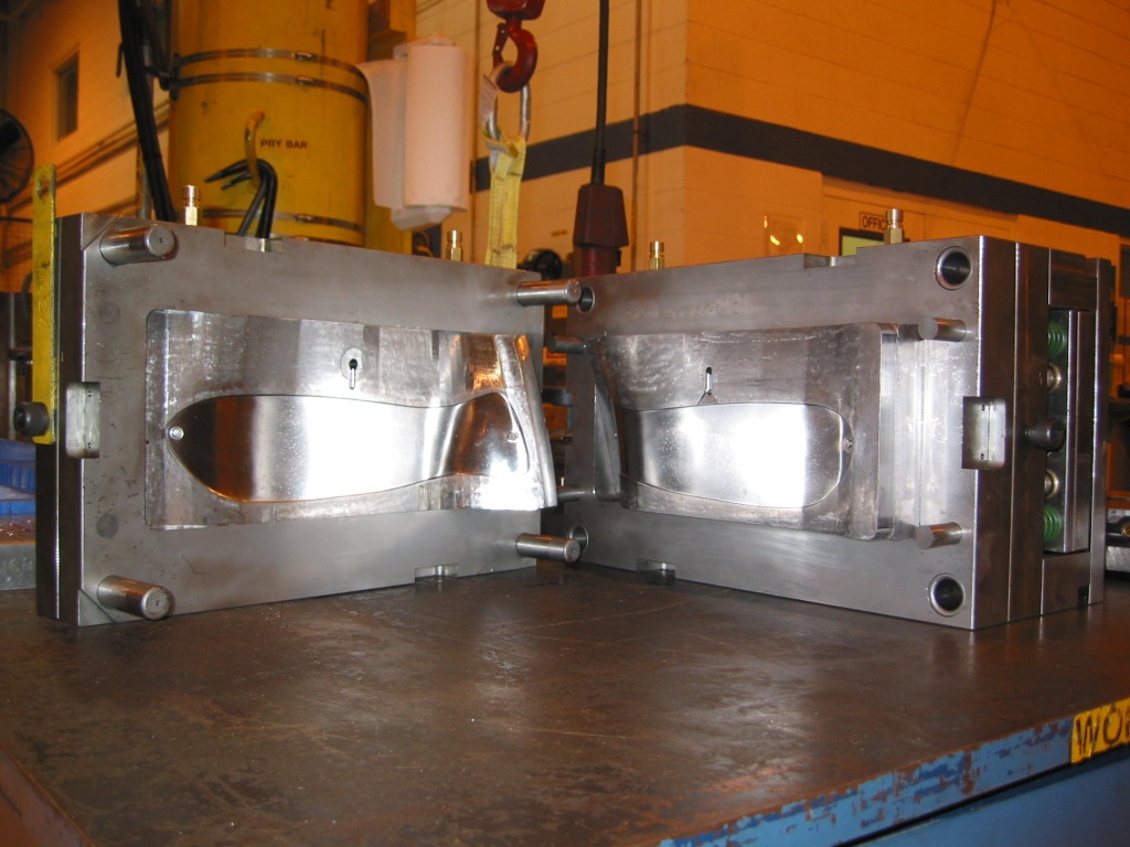

9.5-10k is dirt cheap for 2 cavity injection molds that will make 1000s and 1000s of parts.
There's a lot of engineering that goes into the water courses to cool the mold between shots.
Have one tool that pushes 30k to make boxed-in on 3 sides parts. Tool steel alone can run 3k
or more depending on tool size. Injection molds are highly complex tools built to run/cycle
parts fair clip, then cool all at once so the mold can open and eject. 9.5k is chicken feed
for a tool that has the potential to make a millions dollars in product over time depending
on your target audience's acceptance.
Salmon_Symposium_3.27.04 011.jpg (210.57 KiB) Viewed 24193 times
12" flasher single cavity mold

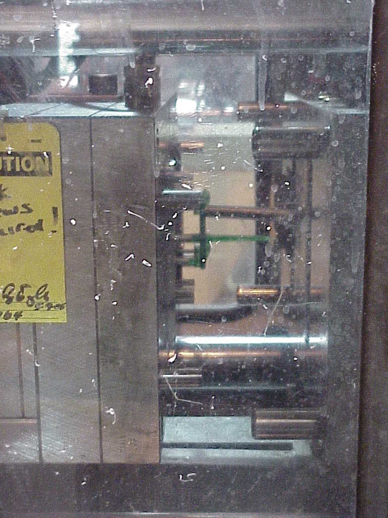

Bait head, multi tool with 4 slides, makes 3 types of parts.
This tool is in action making bait heads, green thing sticking out
is the parts tree that aids in ejecting the heads.

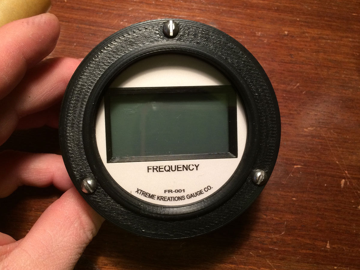

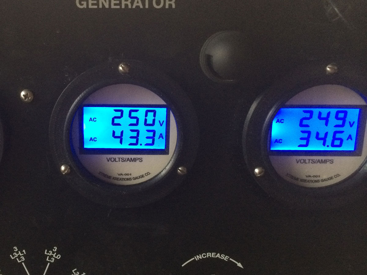

I use my m2 to make small production runs if parts. I make digital replica volt/amp and frequency meters for old military diesel generatirs. I have made 260 of them so far in the past maybe 8 mos. without 3d printing there is no way these could be produced and actually be worth buying. Too much in production cost that would need to be overcome.

Geez, that's almost one sale per day! I'm surprised there is that much demand for something that obscure. Definitely a good 3D printer application though. I'm curious what they look like, do you have a link to some pics?
Do those require electronic parts or is it all just pure printed plastic? I have several ideas for print-on-demand products, but the problem I run into is they all require a fairly expensive collection of parts in addition to the printed parts and I don't want to have to inventory that stuff. But then if you don't have the parts on hand and someone orders one, there's going to be a big delay waiting for parts to arrive. I guess as long as the customer understands there's going to be a delay up front, but having to wait too long might impact sales.

yes there are electronics involved. i have a company produce the guts for for me. each gauge requires 4 printed parts, 1 laser cut lens for the bezel and the faces are printed. then there is the assortment or hardware. some screws, nuts, etc
