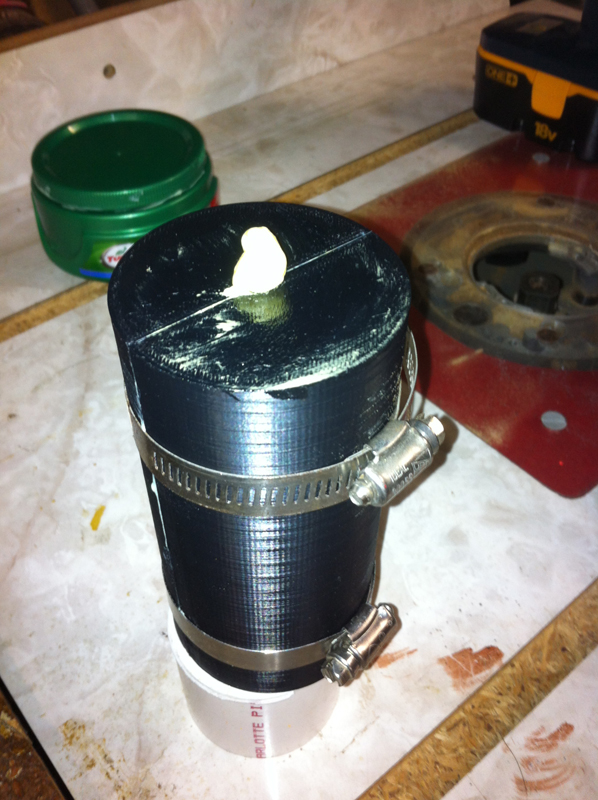

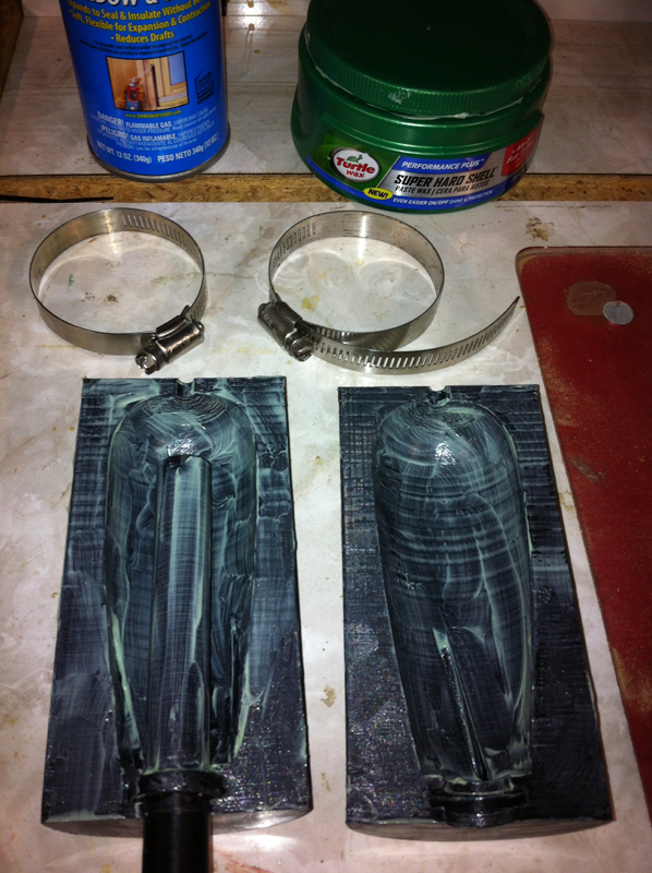

jsc wrote:One suggestion on your mold: from my previous attempts at mold making, I've found it very handy to model in registration keys with .2mm clearance on the holes. It is super annoying to try to clamp two smooth faces together and keep everything aligned.
I didn't even think about making registration pins until AFTER the print was done. I think it's a pretty simple mold though so not really necessary. The pipe clamps will keep the cylinder halves aligned and the removable pin for making the hollow bore in the middle of the rocket will act as a registration pin too since it locks into a slot on both mold halves.

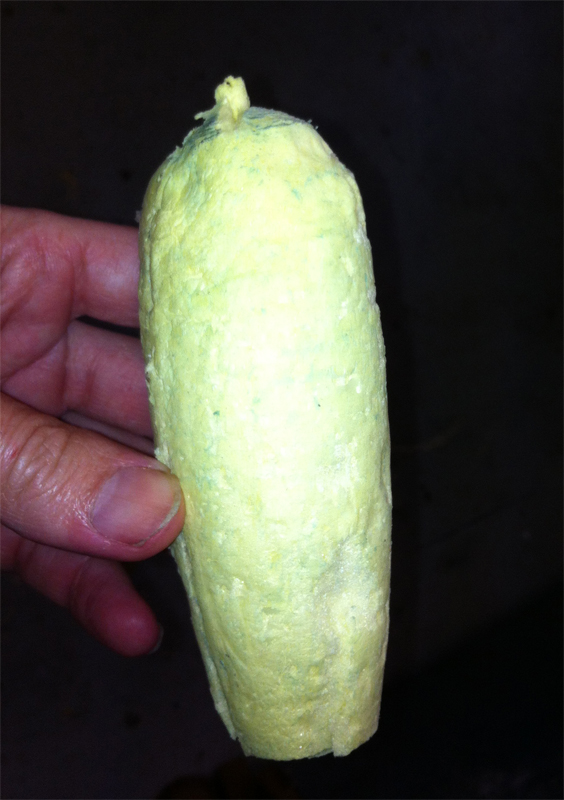

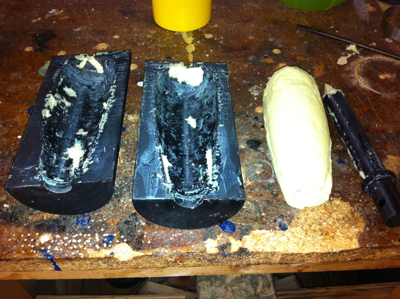

Well, the Great Stuff did not work out too well. It does set up in the mold and the mold does release from it using Turtle Wax, but the problem is that it shrinks when drying and creates a lumpy surface. So it's really only good for creating lumpy organic surfaces like rocks, skulls etc. There are about four versions of Great Stuff, and I used the flexible one for sealing windows. Even with it being flexible the fins still tore off when removing from the mold because it just tears too easily when pulling on it. It's tensile strength is pretty poor. So to get this to work would probably require using the two part foam like what Smooth-on sells. The other option might be to cap the fill hole and let it expand under higher pressure to create a denser foam that might not tear or shrink as bad. The other problem with using Great Stuff is there is no way to measure how much you are squirting in, which you can do with the 2-part kind that is poured in as a liquid.
