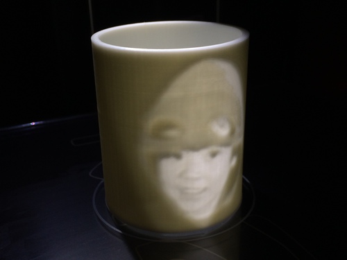

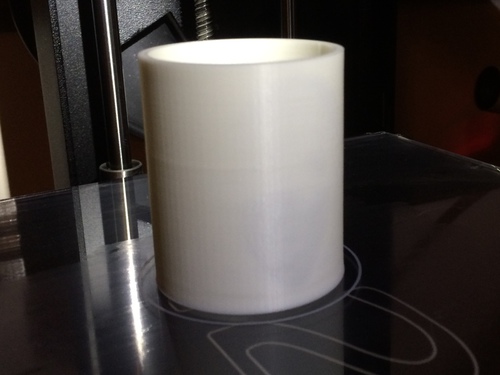

More "lithophane" experiments: I took my previous model and tried to figure out how to morph it onto a cylinder. At first, it seemed like meshmixer could do it, but the spare documentation, confusing UI, and continuous crashes finally turned me away. There's some guy selling some Windows software to do this sort of thing, but I didn't want to spend the $40. So I figured out how to do it in OpenSCAD:
I took the flat panel and embossed it onto a cylinder to get a negative, by recursively differencing it and rotating/translating them two millimeters at a time, like a rack and pinion. Then I differenced the result with a shell to get the original surface, but as the inside surface of a cylindrical pipe. Worked pretty well, but takes 3.5 hours to render.

wow thats a cool idea too jin. this is easily done in rhino too. never really thought of it. you could just put one of those led tea lights in the cup to make it glow...if its bright enough. ill have to mess with it.

Platform height was 0.3, but I effectively beefed it up during the wrapping process to 0.4, to make sure it was at least one extrusion width thick all the way around. The platform height will turn into the outermost shell.

Post by jsc » Wed May 07, 2014 6:00 am
I've cleaned up the code and made it customizable by dropping the resolution:
http://www.thingiverse.com/thing:322720
