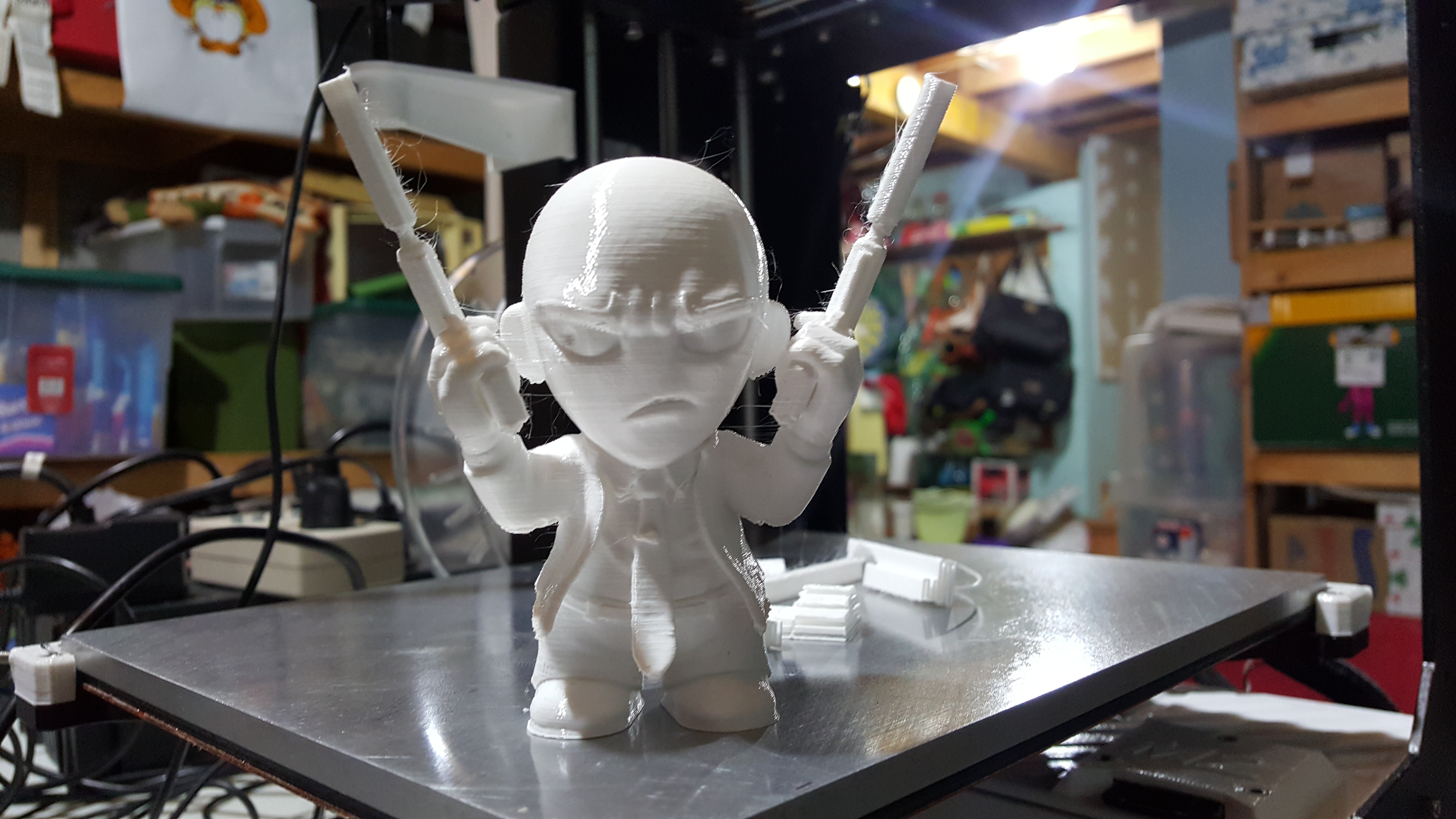

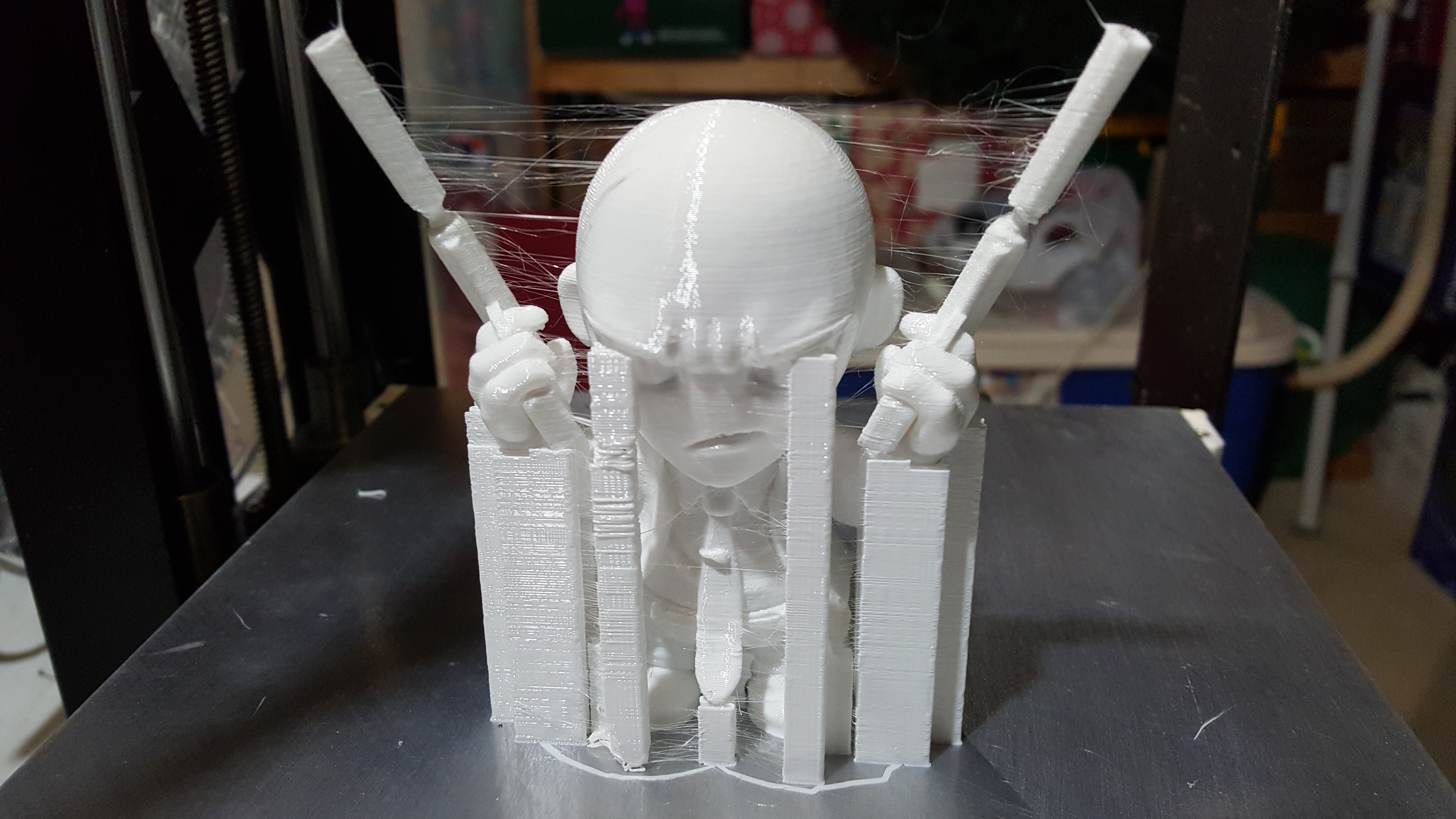

After reading this whole post my take is at a .98 multiplier I can say I would bet your z is still to wide. The higher the multiplier the thicker your first thread. And as you said you have had bed adhesion issues. Most can be attributed to not getting a good first layer. I used .89 for my print at 30 mms only retract when crossing open spaces .2 coast no wipe no z hop no cooling .2 layer 2 perimeters 4 bottom and top layers and 40% infill.This was my first attempt and sliced with s3d. I did Auto generate the supports and remove a few and add others.

I really don't have bed adhesion issues that I'm aware of - the only time I had issues was when I reduced the extrusion multiplier. Or do you mean that the toppling of the supports is indicative of the multiplier being too high? The thin wall test is still checking out for me with my current set up (modified E, diameter 1.75mm, multiplier of 1, extrusion width 0.4).

Yes your extrusion multiplier is really high for any layer height. If you set it at .90 and run a print it probably does not stick. The M2 comes set with spot on steps for the extruder and almost all users hover within a point or two of .90. I have in the past when I have set a too tight Z gap lowered it down to .80 to make up for it. In other words there is a direct correlation between your extrusion multiplier and thread thickness. You can use a caulk gun at .25 and keep it the same distance across an object but if you push too much you get fatter lines and it will also fill a larger z gap. I will attach Hitman as I ran him. I noticed Chazared does not sit flat when dropped on the build plate . At least at a .2 layer height. I noticed it never started to print his feet until layer number two. I will upload that file as well with that problem fixed.
