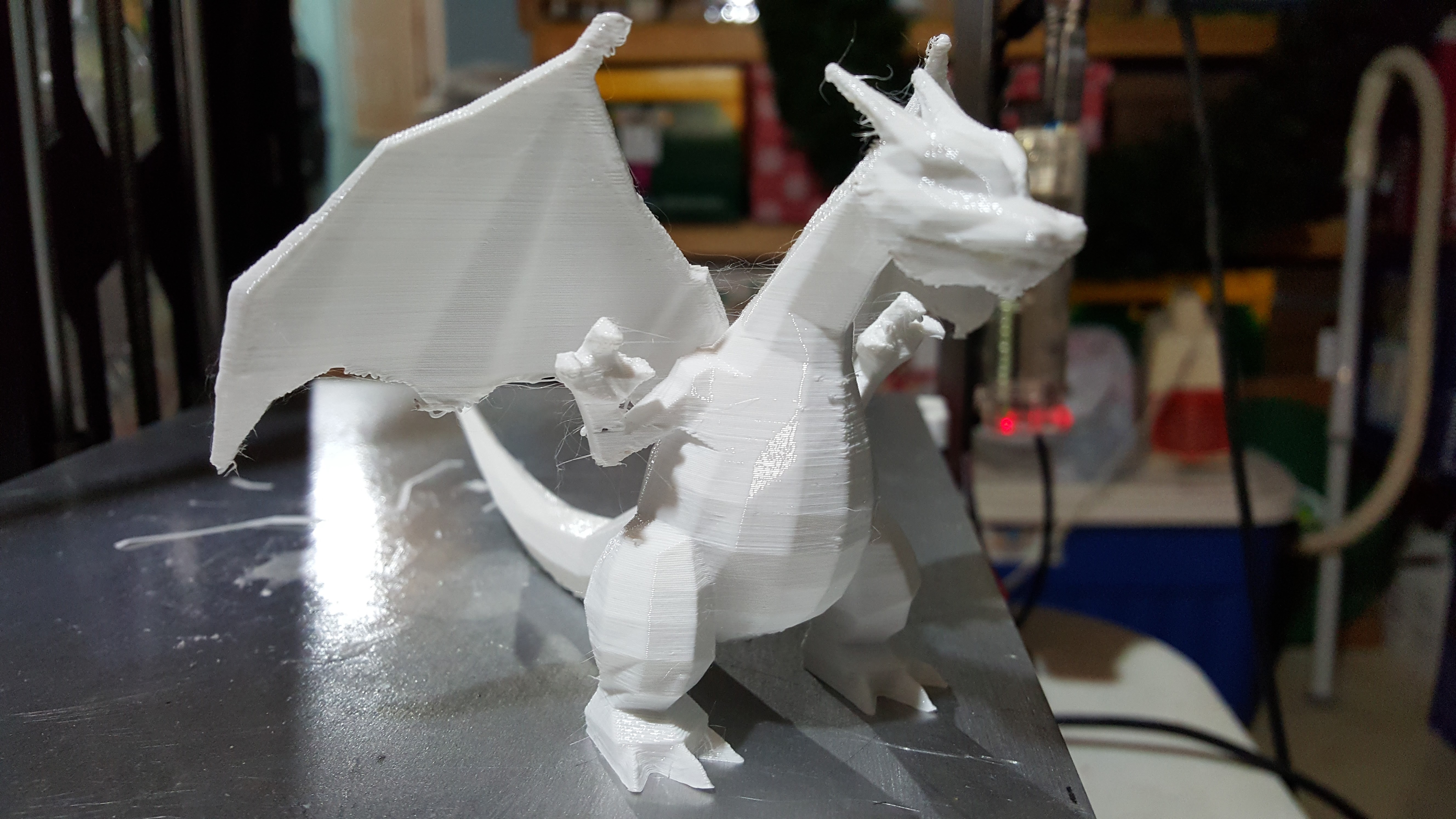

Although not a perfect print . Not bad for a first try.

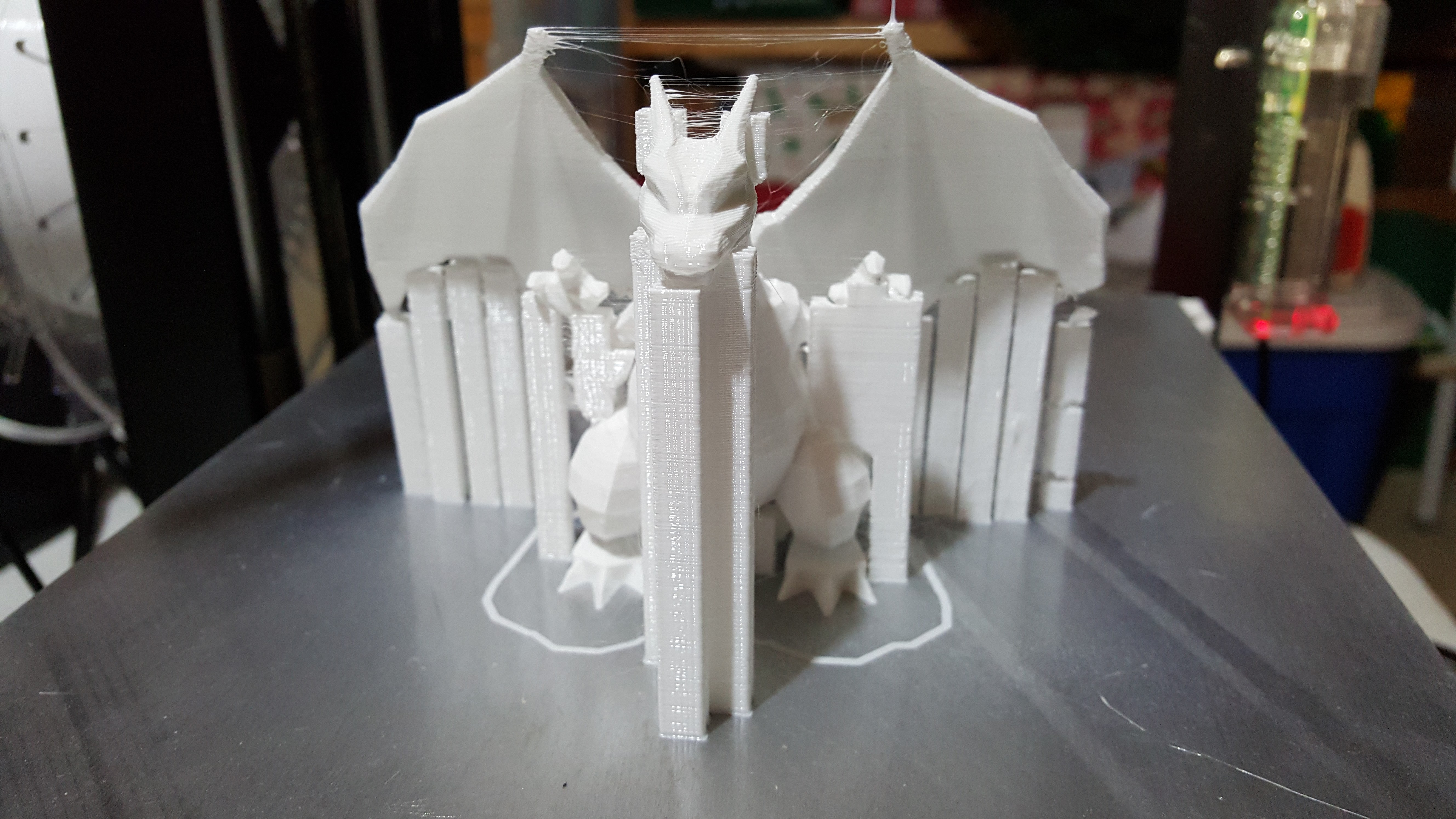

The one with support looks like he's trying to eat a building. :lol:

sthone wrote:The one with support looks like he's trying to eat a building. :lol:
Now that you mention it ... It does !!! lol :D
Re: Hitman
Post by Jules » Sun Feb 28, 2016 1:34 am
Ohhhh noooooooooo....it's.......Godzilla!
