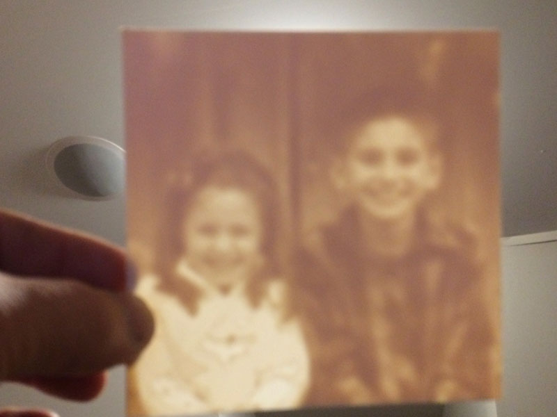

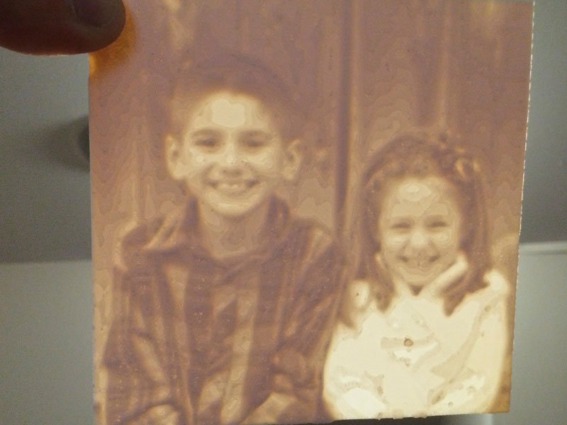

on another not i thought i would post up these pics to show the same litho viewed from both sides. you can see one side it looks alot more crisp and detailed.

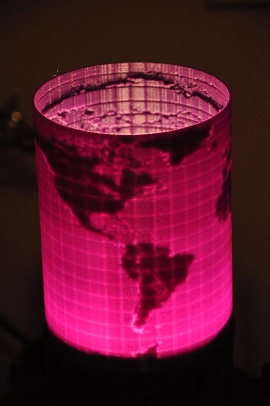

And here we go. . . Thingiverse thing #326214, the "World Cup" cylindrical lithomap!
Source code included!
- The "World Cup" lithomap!
- world_cup_west_a.jpg (98.33 KiB) Viewed 18218 times

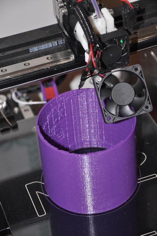

- Building the World Cup. . .
- world_cup_making2a.jpg (126.88 KiB) Viewed 18218 times

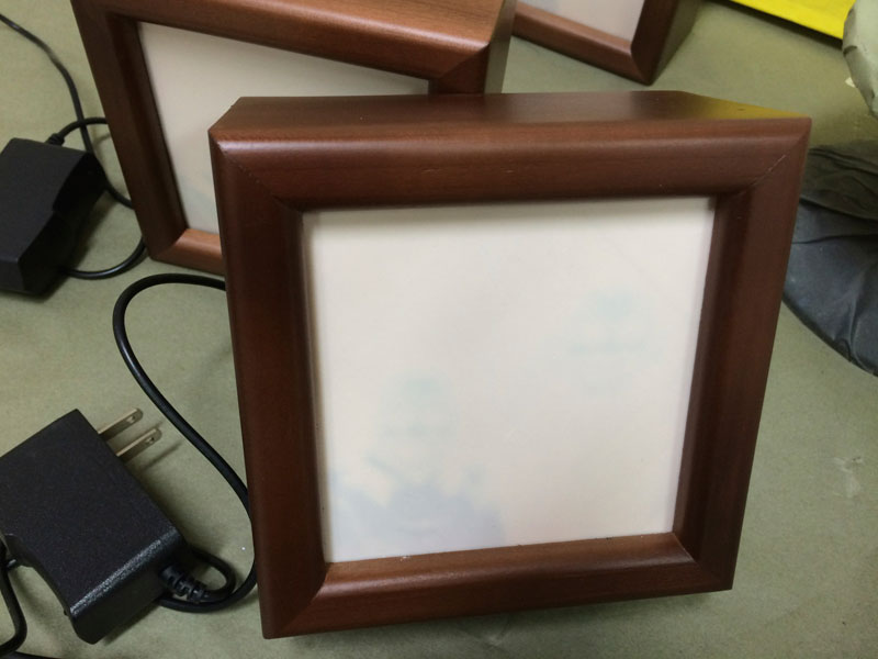

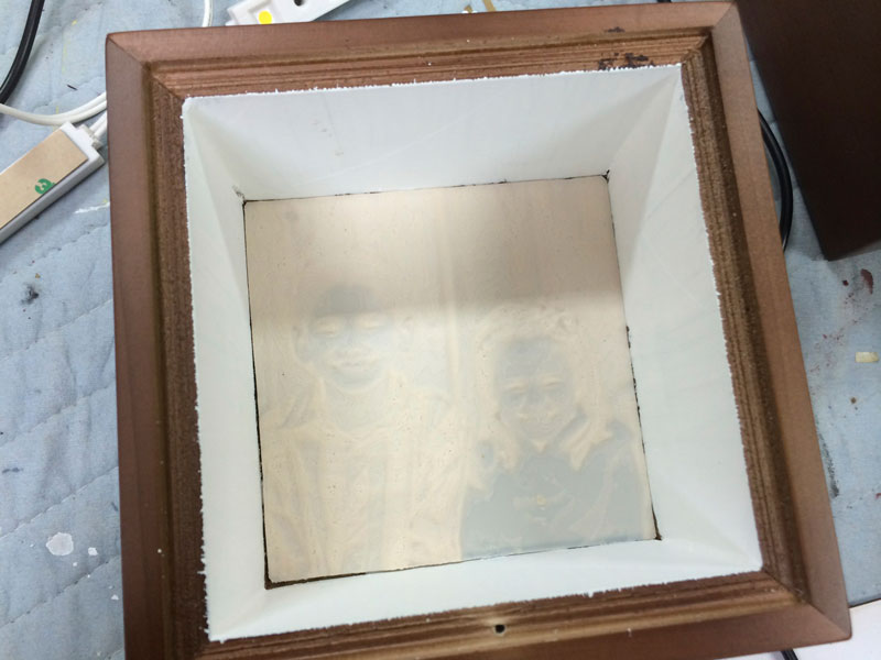

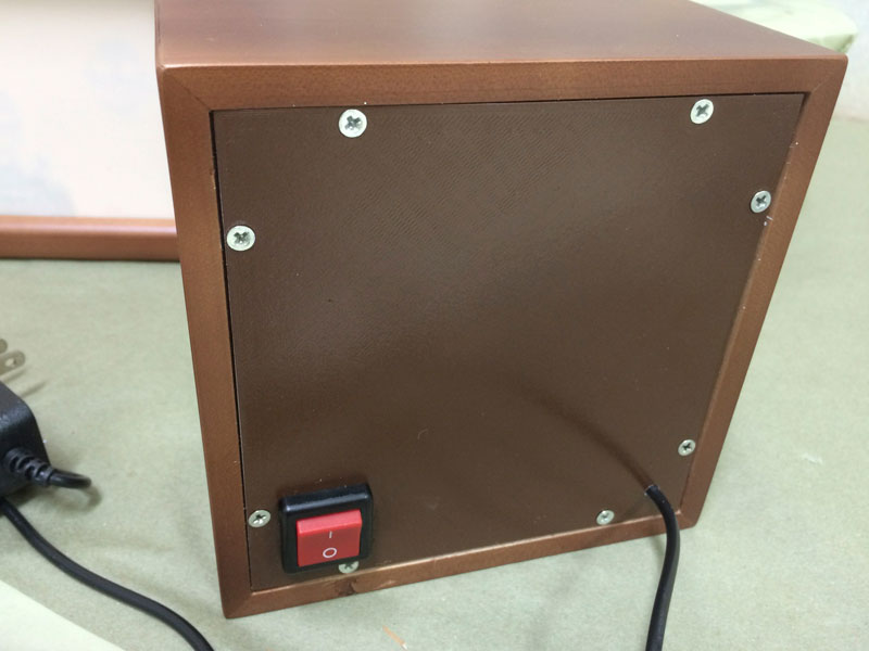

ok here are some pics of the light boxes i whipped up. had to get these done so the kids could give them out for mothers day. i made 4 of them. i threw together the boxes and put a finish on them, painted the inside white. the back panel is printed in abs then painted white on the inside and a matching brown on the outside. the leds are made for backlighting signs, channel letters etc. i have used these on a ton of projects in the past. they are waterproof and dont dim out over alot of hours of use. i originally had 2 of them in each light box but it was way too bright. one is just right.

Did you have boxes that fit already, or did you make those?
Re: Easy lithopanes with Simplify3D
The boxes are really nice, Jim. You always do a great job. . .

no jin i made the boxes. it helps to have a full wood shop here at the house and thanks tim.

Jim---Do you have a part number/supplier for those LEDs?
