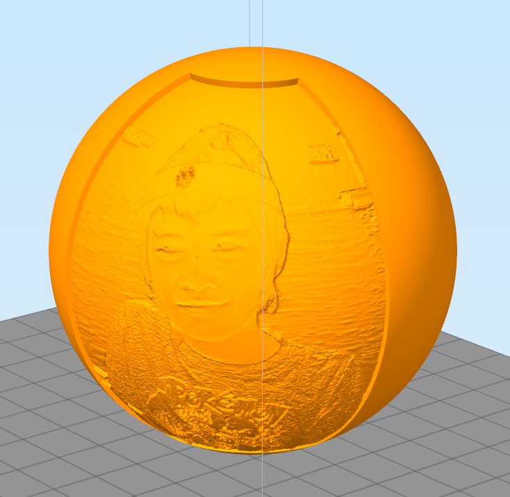

I finally got around to writing the "lithosphere" generator. It will create lithophanes on spherically curved surfaces, with options for partial wraparound, holes at top and/or bottom, margins and top and/or bottom, etc. Assuming that it is given sane inputs and good support structures can be generated to hold it up while it's being built and keep the top from collapsing, then it should be good for creating custom night lights, Christmas tree ornaments, etc.

That is very cool. I'd like to try out your code but before I learn it I'd like to try and slice an example in S3D- do you have one you can post for me to play with? I might find a way to avoid some of the S3D glitches.

(gzipped, it's 7.6MB). If you want any particular variation of it, let me know. This one is closed on top and open on the bottom. I don't try to flatten the bottom in the software; I was just relying on S3D to adjust the offset to give the bottom more surface area on the plate.

Got it. Unzipped it was over 50Meg- I assume that's the ASCII stl format at work.
In any case it really wasn't bad at all to slice in S3D. Only took about 30 seconds. I can't see any glitches in the preview, but I don't want to try to print this thing with (or without) supports generated. So I guess the only way is some custom gcode.
