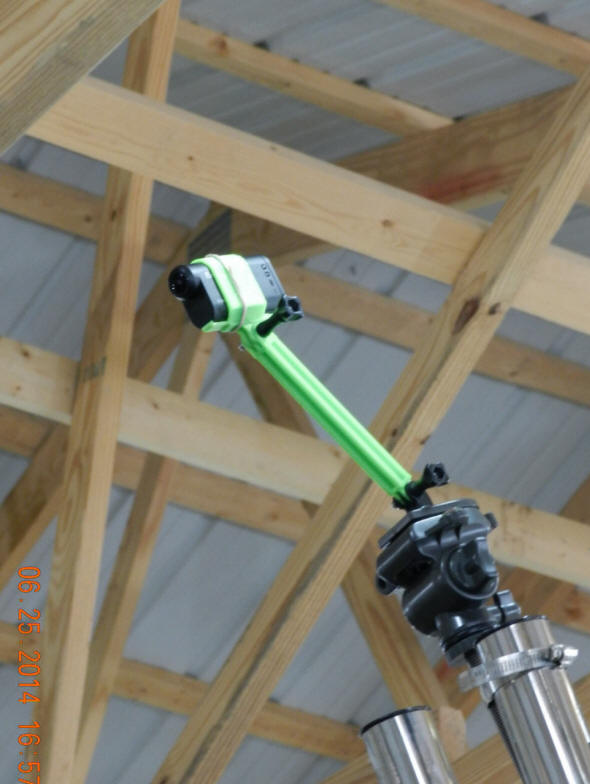

Used GoPro mounts adapted to a tripod mount for my Sony action cam. Models came off Thingverse.
Have a GoPro black, but battery life is about 1/2 of what I get from the Sony action action.
Printed in florescent green so I don't forget it's up there after I'm done shooting fishing videos.
Made it out of PLA. All it holds is a 4 ounce camera and there's no stress issues.

Capt. John wrote:a tripod mount
Something I discovered the hard way: when the camera falls, that lovely Zeiss lens will take the hit.
If you put it upside-down in the mount, turn on FLIP mode, and gimmick a bumper that protrudes beyond the lens, it may emerge unscathed.
Dunno how that would work with the mount you're using, but it's definitely worth the effort; I really wanted a ten-second Mulligan after my bike blew over. [wince]

Ed, I don't understand why flipping the camera in the mount would help.
What about extending the mount to just past where the lens extrudes, would this "shroud" be visible in frame?
Re: Action cam mount
Post by ednisley » Fri Jun 27, 2014 6:58 pm
The upper front edge of the camera always hits the ground first, so the idea is to get the lens away from that point. Here's how it's set up on my helmet:
The lens sits inside the line connecting the visor and top of the camera, so (in principle) it can't hit the ground. I've been handling the camera like it's, mmmm, made of glass and haven't made that mistake again ...
The full view is 170° horizontally, but a little shelf sticking out over the top of the lens would work; if it cut off a slice of sky, nobody would complain. I'd be tempted to bracket the lens with rugged shelves, top and bottom.
