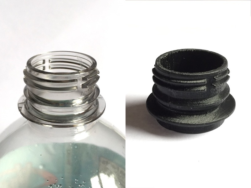

I modeled a bottle neck (for learning purposes) and decided to try to print one. The overhangs on the threads are significant and I didn't want to mess about with trying to support them, so I split it vertically and printed in parts. Turned out pretty well: you can screw a bottle cap onto it.

Wow, that did turn out great. Looks perfect!
Re: bottle neck
Yea that came out really well jin. Nice job
