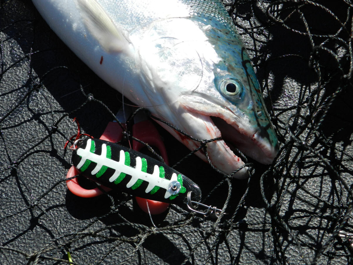

Post by Capt. John » Mon Nov 17, 2014 11:28 pm

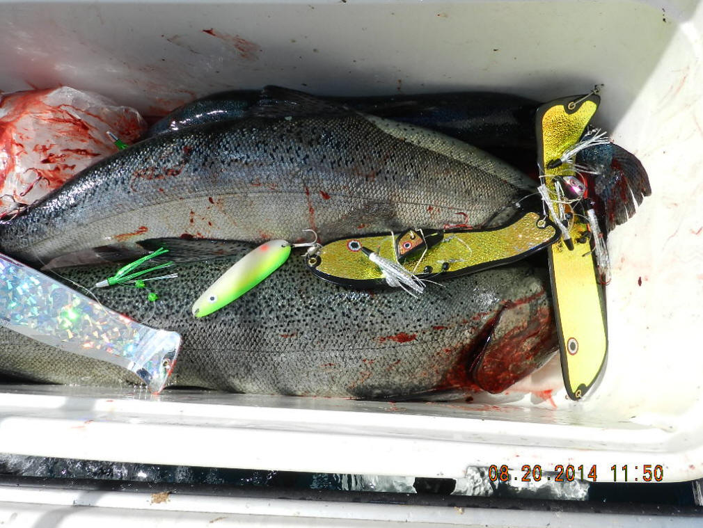

62080595 is my patent pending number for a new fishing spoon with a reinforced outer perimeter.
9.26.14_Ludington 004.jpg (100.72 KiB) Viewed 33670 times
This only was made possible with jimc's design work with my tweaks to get the lure action
topnotch. This is a huge leap forward and I have a year to file for a full utility patent.
Cost to do this was around a grand with a web based company, thoughtstopaper.com
Could have be done a little cheaper, but I selected their all inclusive pro package where
they handled the drawing and engineer geek-speak language to file.
Printed out my first spoons in May of this year, 6 month later after exhaustive water trials
with at least 5 different versions with sub tweaks, came up the winning combination.
The only way this spoon could be perfected was thru 3D printing where several sizes and geometry
to fine tune the design. I have 2 injection twin cavity molds being made, one with a 4.0" spoon and another with a 4.65".
This new concept in a fishing spoon will debut on my websites around this Thanksgiving and
just had to share this project with the member's here, who's advice brought me up to speed.
ABS was my first attempt, too brittle, pulled the eyelet hole on 3 spoons and never landed a fish.
Once again, Mr. jimc needs another thank you for recommending PET+ and settings for my 3vb hotend.
Spoons got stronger and started catching, then it was up to underwater videoing to make final checks
on the movement-action of the lure/spoons. I will post links to 2 of my soon to debut YouTube videos
where it's proven beyond any shadow of doubt these spoons are the reel deal!

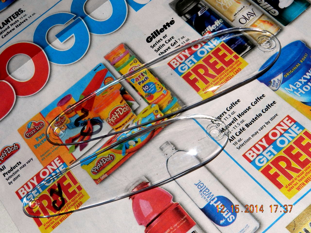

1st test run of my new injection molded spoons:
My printing efforts are at manufacturing and prototyping with my M2.
Numbers on the spoon designate which side of the 2 cavity molds the parts came out of.
Pic is outstandingly clear polycarb Lexan™ from the 1st 20 parts that were born out of my new molds.
Lens quality diamond polish is why the spoons are so ultra clear. Diamond polish
is not a standard finish for molded parts and it's a 2k cost upgrade.

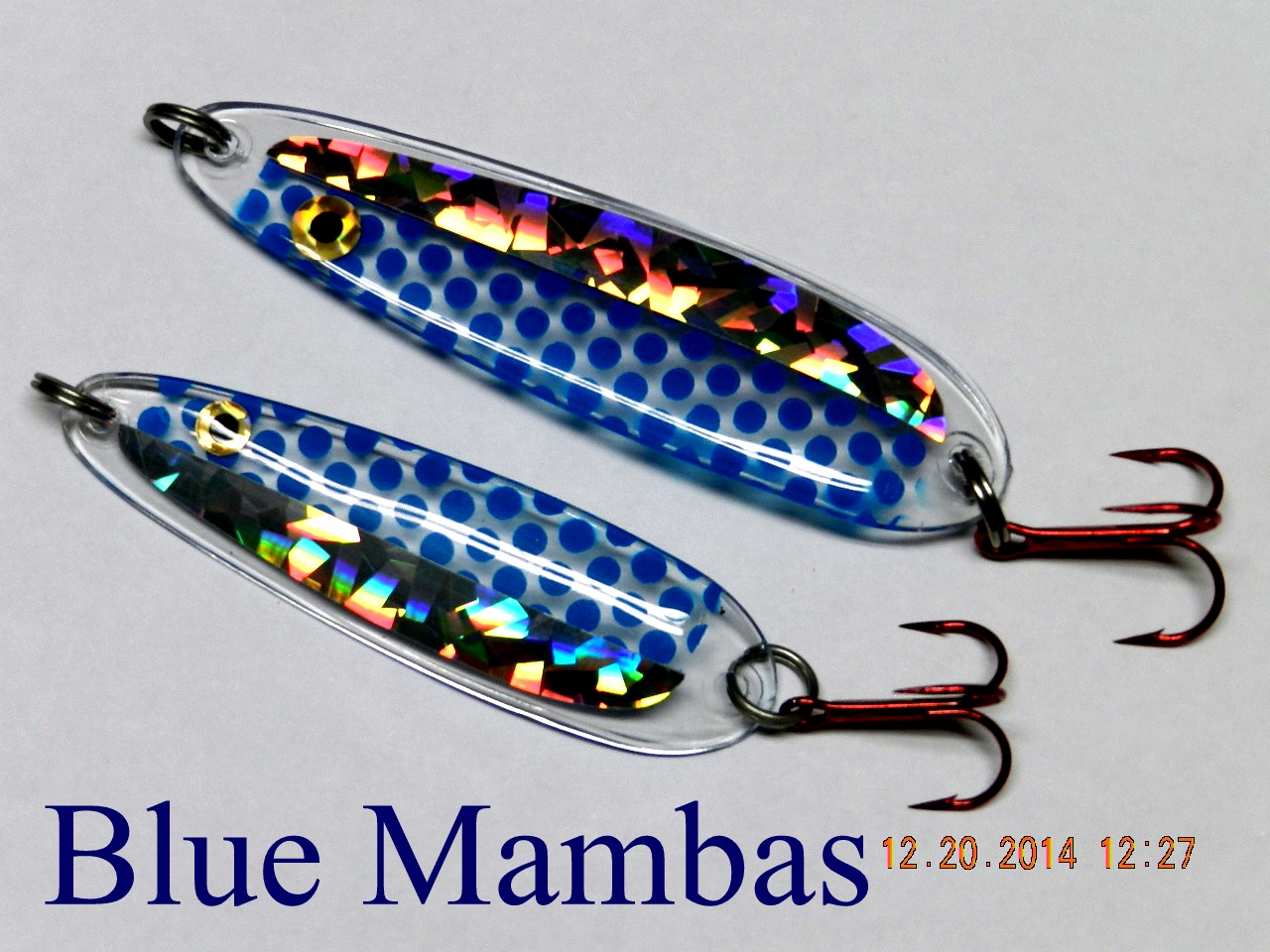

Post by Capt. John » Sat Dec 20, 2014 5:34 pm

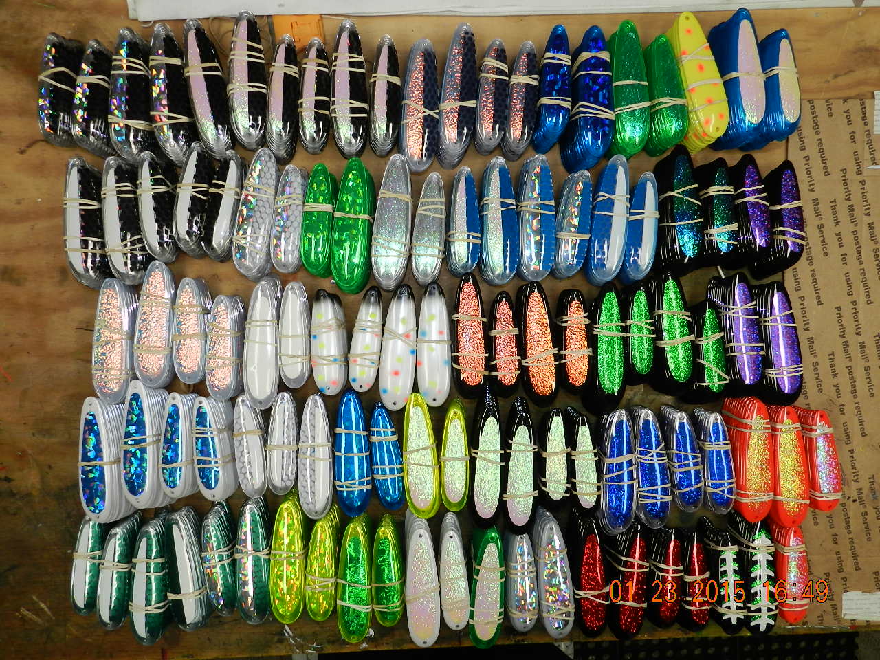

I'd be lying, if I didn't say how envious of the art work seen on this board that
blows my skills away.
My art is devoted making fishing tackle that's provided me a living for the past 32 years.
The below photo would NEVER have happened, if I wasn't able to rapid prototype
several versions of a spoon, then get an injection mold made.

Post by jsc » Sat Dec 20, 2014 7:59 pm
Very nice. Were those hand painted?

Post by Capt. John » Sun Dec 21, 2014 3:36 am
Mask was used for the dots, USA made $30 Paasche H series air brush with a 3 tip.
These are rock solid siphon fed air brushes that can hold a lot of paint for production uses.
Some of my Paasches are over 10 years old with the original parts, spraying gallons of paint.
Lure tape is USA, lure eye, and so are the split rings.
Paint is Duplicolor lacquer, pretty sure this paint is USA too.
Hooks are made in France from iron ore mined in the alps.
