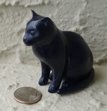

I did a test print last week of a cat in ABS. The print finished but had several surface defects. With nothing to lose, I sanded it, slapped on a coat of oil paint, and after a week sanded again and applied a coat of shellac. The oil paint stuck well to the ABS but I probably didn't wait long enough for it to dry completely. Here's the result:

Seriously, if jim (or anyone) knows how to smooth ABS without toxic chemicals, I'm all ears. Sanding doesn't help much. The oil paint was thick enough that it filled in some imperfections, but there's a point of diminishing returns when adding extra layers.
Also, I may have been hallucinating, but I think the shellac smoothed things out a bit as well. Whether it acted on the oil paint (likely) or the abs (seems unlikely but I can always hope) I don't know for sure.

The thing I found interesting about the cat was that oil paint worked well with ABS. By comparison of a sort, acrylic paints didn't work well with PLA when I tried that.
