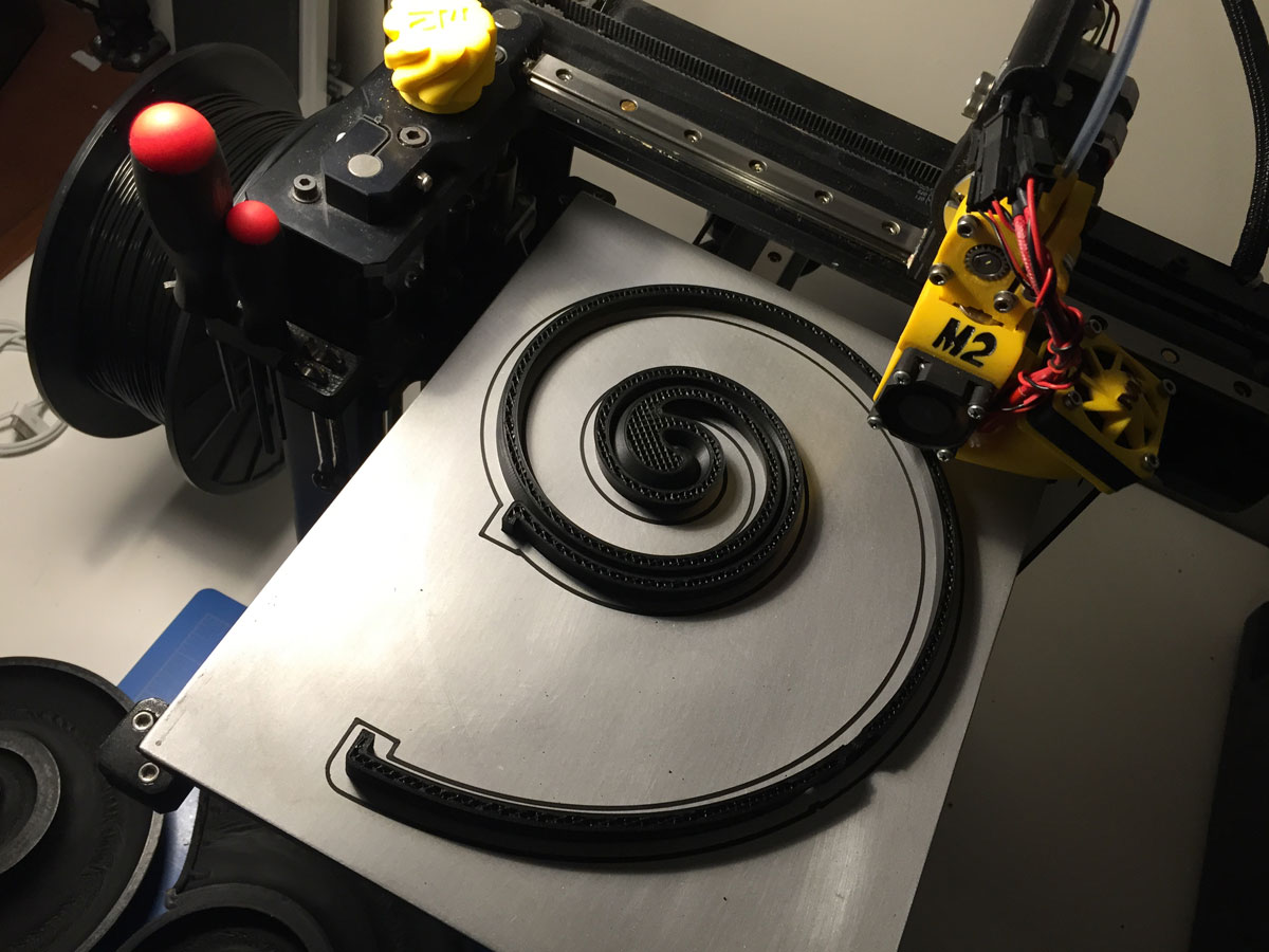

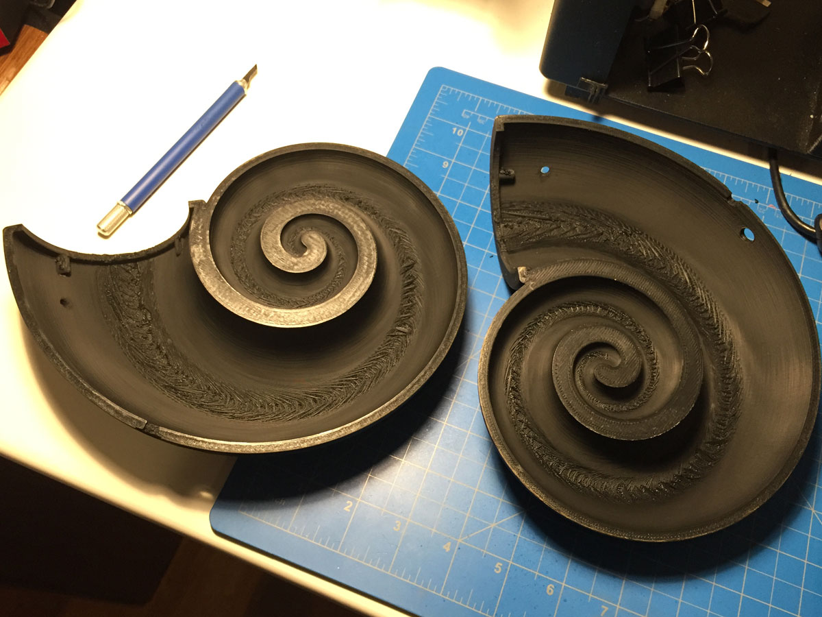

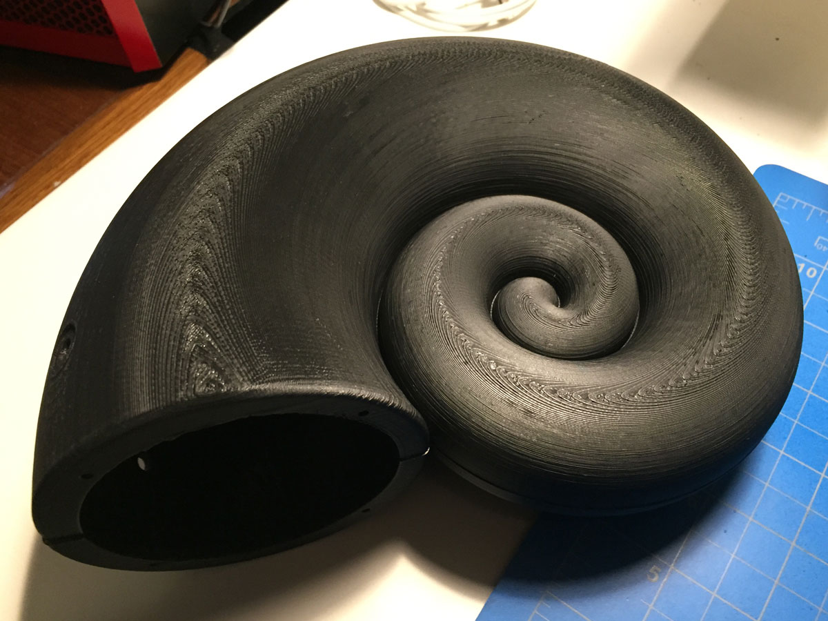

ok, i ordered all the parts from http://www.parts-express.com. here are the parts:
speaker spikes/feet: Dayton Audio DSSG-3
binding posts: Dayton Audio BPA-38G
speaker: Fountek FE85
the spikes and posts above are gold. they do have other finishes available for those. as for the amplifier, i got that from amazon. its an SMSL model# sa-36a
http://www.amazon.com/SMSL-SA-36A-TPA31 ... msl+sa-36a
erik, here are a couple pictures of it before finish and your right bryan, its almost the whole bed. this prints easily with zero support. the creator of the model designed this for a speaker that was discontinued so i scaled it a little to fit the fountek's above. if you want the scaled model that fits these just send me a pm with your email and i can send it to you. its too big to post here.
