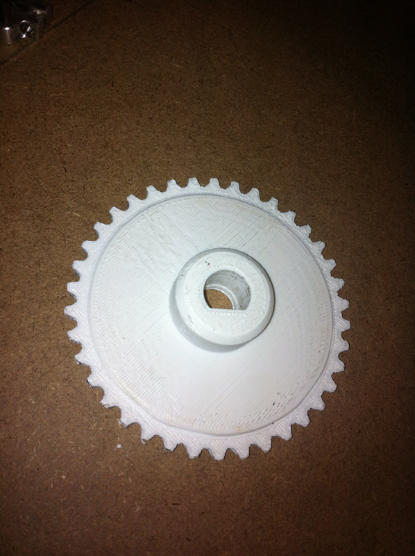

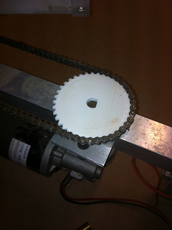

This is a chain sprocket for a machine used to wrap fireworks shells with paper. This one piece part replaced about four separate parts previously used to fasten a commercial sprocket to this metric D shaft. Being able to make a perfect fitting D shaped bore built into any size sprocket I want is awesome :)
I eventually want to try and get many other parts converted over to printed ABS in a redesign that makes everything more adjustable. The metal version is very troublesome to adjust for different shell sizes. Not having to worry about the machineability of my designs really opens up some doors to what can be done here.

Out of curiosity, what software do you use to model? And is there a standard tooth profile for chain sprockets?

I use Rhino 3D for everything. There probably are some standard tooth profile dimensions on the internet somewhere, but I just took the dimensions off an existing sprocket that I had. Rhino has a Polar Array feature that makes it pretty easy to take a single tooth and duplicate it around a center point at a given radius.
Just make sure you use 100% infill for the gears like this or the hub will rip right off of it!
