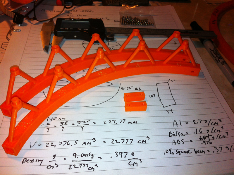

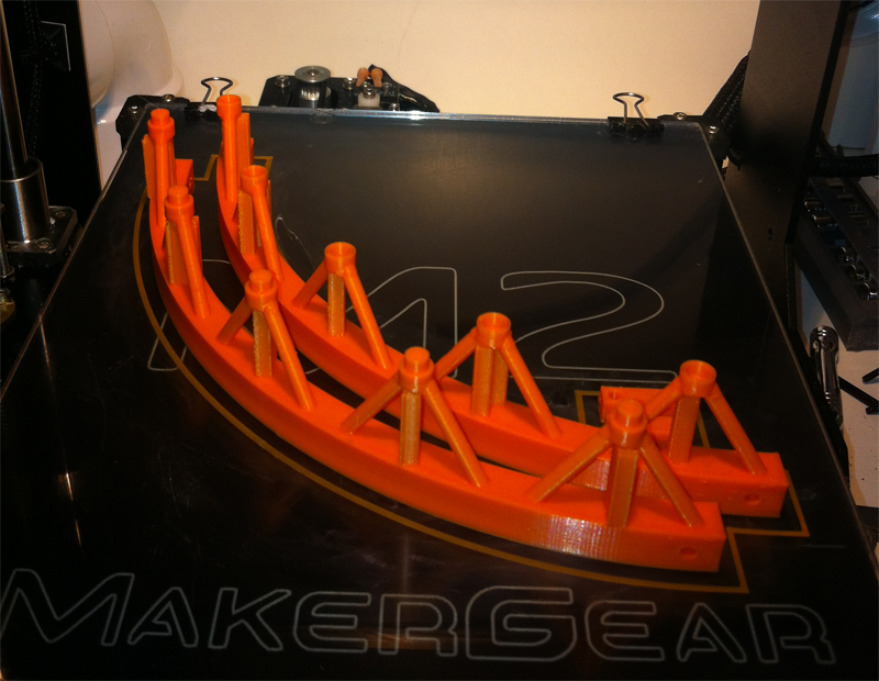

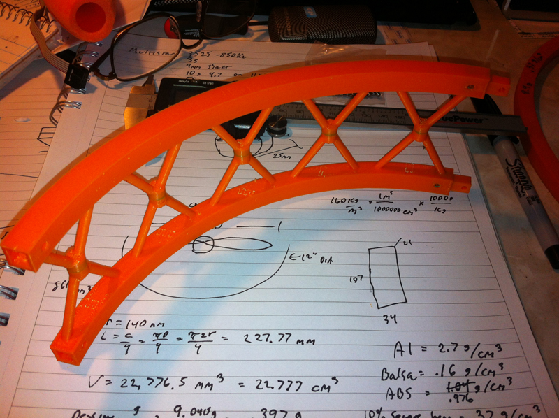

This is part of an RC blimp project I'm working on which carries two engines with 10x5.5 propellers. I used to have to make these blade guards out of sheet aluminum using a sheet metal roller, which is a big pain, doesn't look as nice and weighs more. A 1cm square ABS beam with a 1.8mm wall thickness and 10% infill has an effective density of .37g/cc relative to it's volume, which is still twice as much as balsa wood but a lot stronger. The M2's build platform being long in the Y direction really helps out with building ring segments like this, making it possible to build a 12" diameter ring in four quadrants instead of five or six. Each quadrant is printed in halves in order to eliminate the excessive amount of support material that would be required for building it as one piece. This also cuts the print time in half, which is 2.3 hours per quadrant. Coast has to be turned off for these parts, otherwise the struts come out looking like they got eaten by termites.
Re: Propeller Gaurd
Post by jimc » Thu Jan 22, 2015 2:26 am

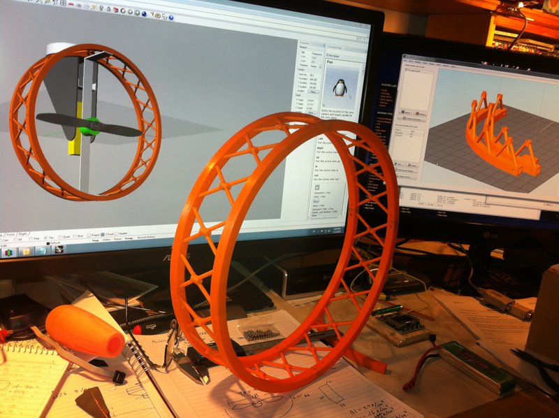

cool! that is the one downfall of coasting. on detailed prints it needs to be turned down or off. wipe feature still works well as a middle ground. on another note, i see rhino is open. what is the bar all the way on the right with the penguin?

That's the command help panel. My screen is big enough that I don't bother closing it, even though I don't look at it too often. It loads a list of steps for whatever command mode you are in, and the picture usually changes to something that goes along with the description. The penguin is the picture that shows up when you are in Pan mode in perspective view. I guess they could not think of a good picture for that one so the penguin got the role. When learning the software that command help panel really does help a lot though.

The ABS parts with low infill have a pretty decent strength to weight ratio. The ring above weighs 95g, whereas if I rolled one out of .025" thick sheet aluminum to the exact same size it would be 124g not including seam overlap and rivets to hold the two halves together. The aluminum vibrates from the motor and makes a loud annoying sound too. Carbon fiber would beat it, and maybe even regular fiberglass, but at considerably more labor and cost. There's no reasonable way to make a ring bearing out of carbon fiber or fiberglass though.
