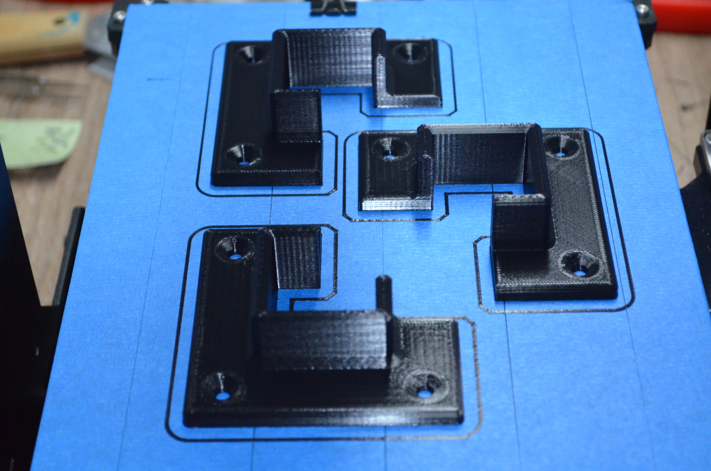

I've been printing with PLA since receiving the M2 this past October, but the time has arrived when I need to start using the ABS I've had sitting in the draw. With all of the forum topics dealing with ABS and its tendencies to warp, split and wreck havoc with novices such as myself, I decided to build a Heat Chamber. I've read that many will use cardboard to isolate the printer from outside influences, but that technique eliminates the visibility of the print.

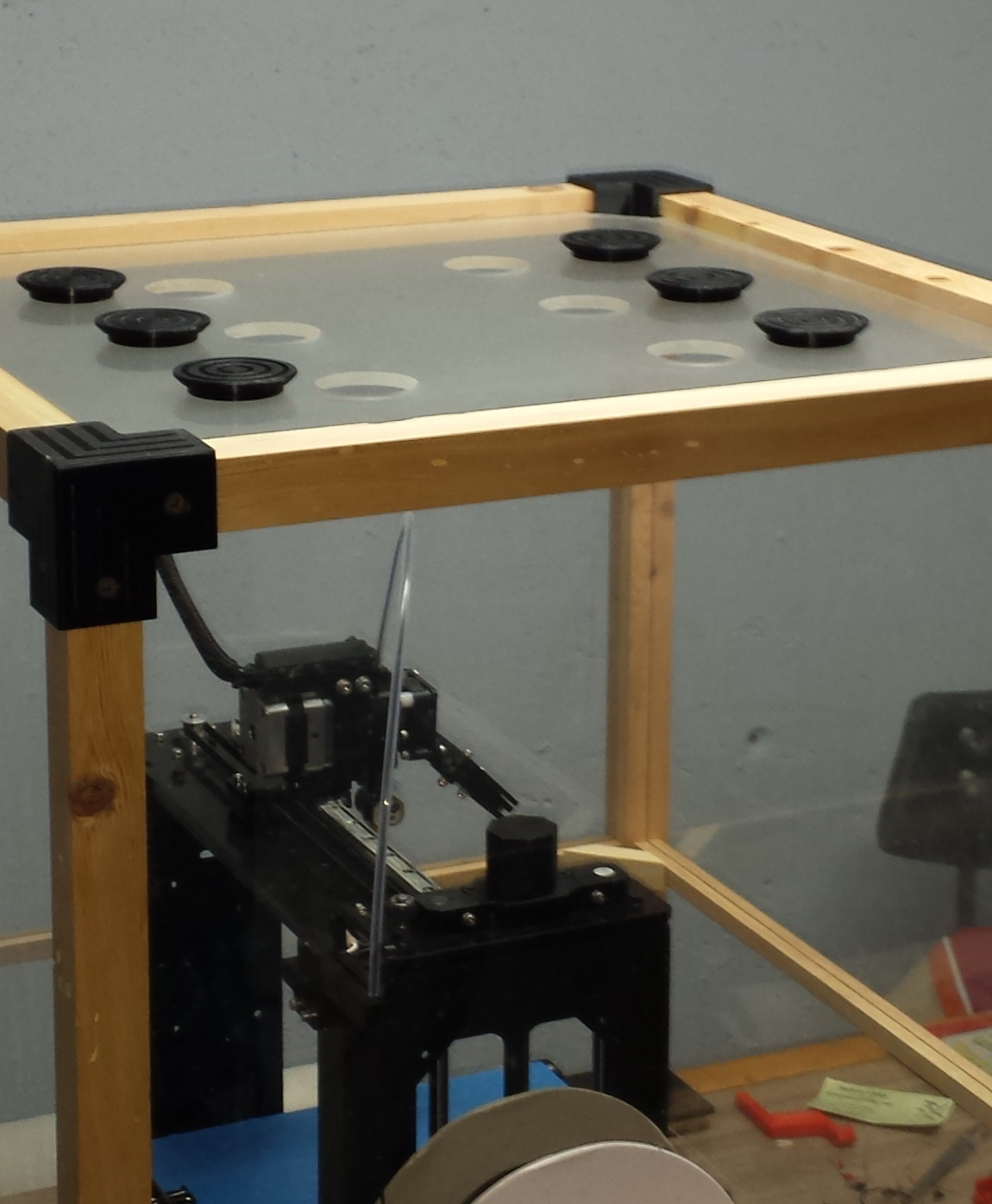

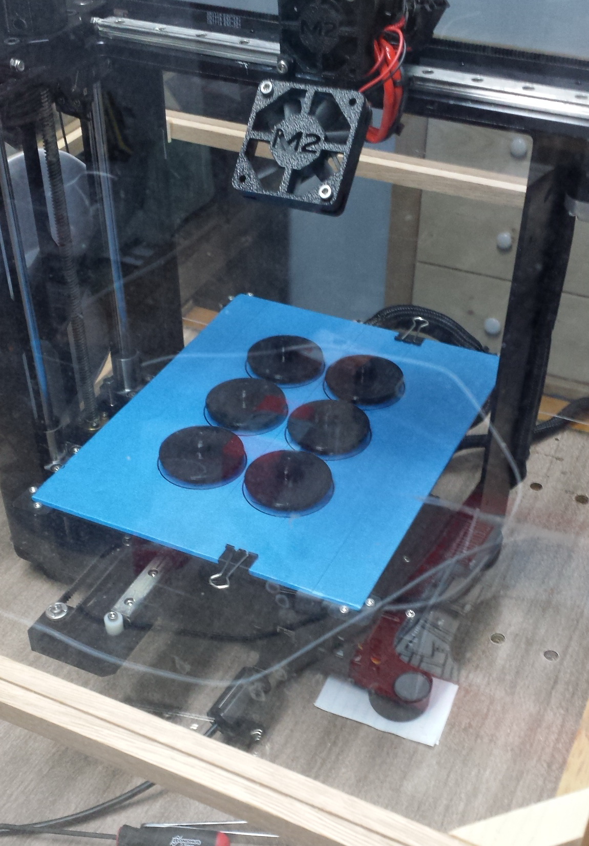

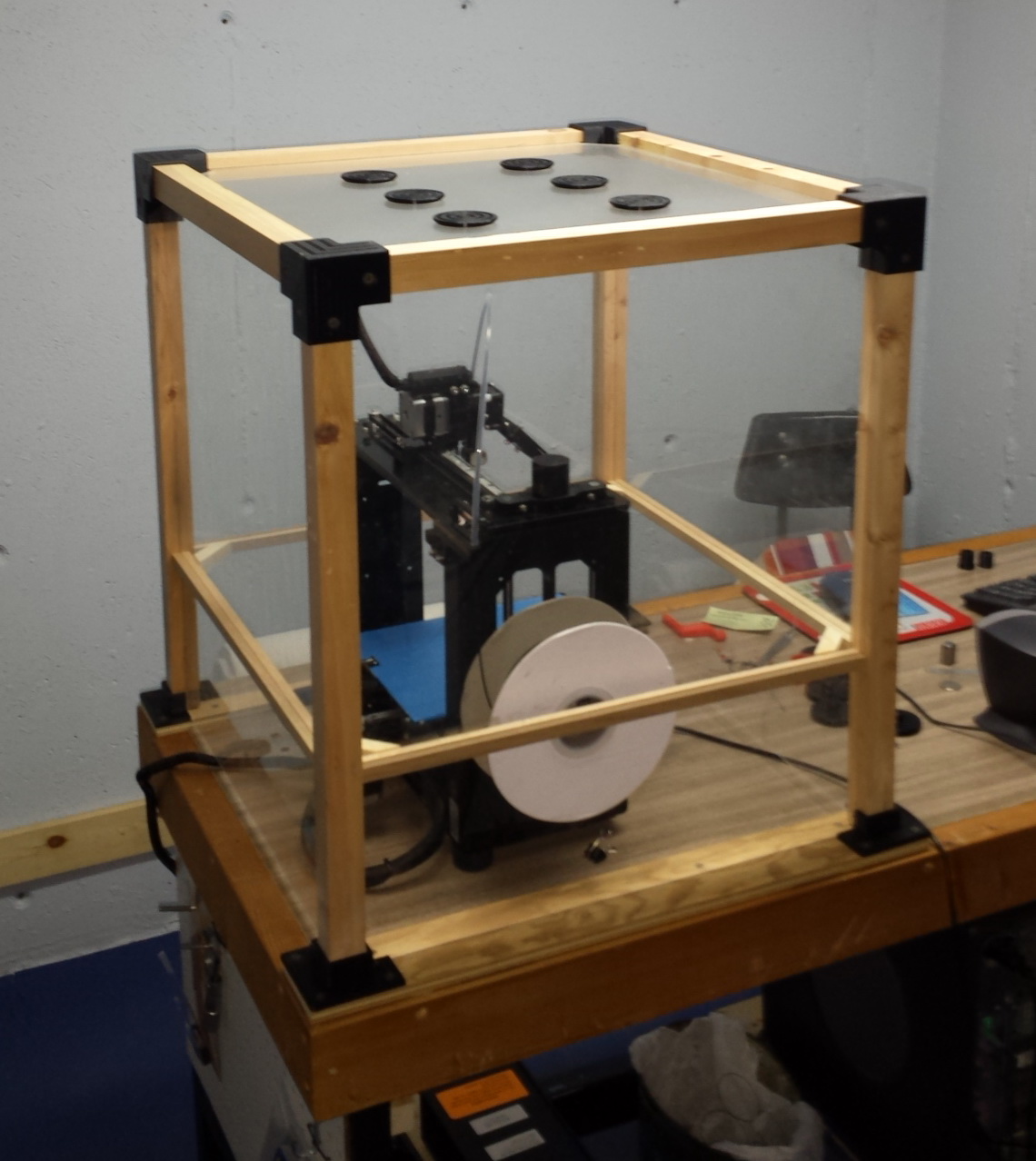

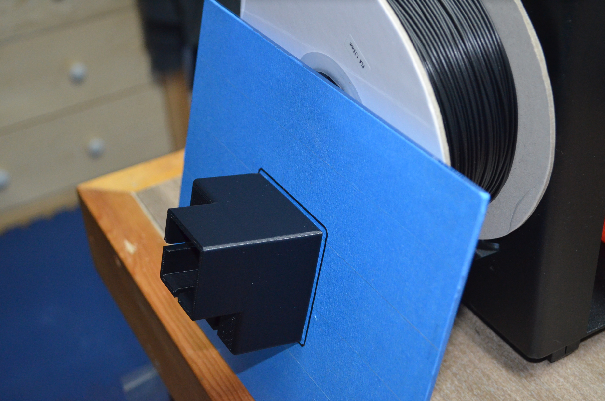

I have a functional wood shop in the basement and built the frame of the Chamber out of re-purposed wood and used plexiglass. Unfortunately I did not have large enough pieces of plexiglass to fill the sides with a single piece, but future revisions will eliminate that problem. To connect the corners and stabilize the legs to the bench, I printed connectors out of black PLA. I drilled six vent holes in the top to (theoretically) allow me to maintain the temperature in the chamber. I have yet to add a thermometer to the Chamber. These vent holes are sealed with caps made printed from the same PLA. Although the used plexiglass is scratched, the visibility of the printer is excellent. The assembled Chamber weighs approx. 10 pounds and is easily lifted off the printer for part changeover or printer maintenance. When the printer is not in use, the Chamber keeps dust and other contaminants from the printer.

Very Impressive Set up!!!
