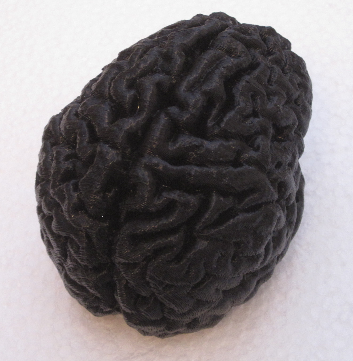

Ok, I'm pretty new to this but here is my second print. I reconstructed by brain from a fairly hires MRI scan. Some volume image processing and marching cubes to generate the input obj file.
FWIW
My Brain

Pretty cool. What did you use for the processing?

Huh! That turned out amazingly well! I'll have to try that image converter one of these days.

The S3D height map generator does not take multiple MRI scan volume data and perform marching cubes on it.

Oh I remember the "this is your brain commercials..." As for the SW, I used Brainvox for skull stripping,the tal_mcubes command line tool that come with it for isosurface extraction and a little touchup with MeshLab. Printed as two pieces to avoid the serious overhang and the need for supports.
