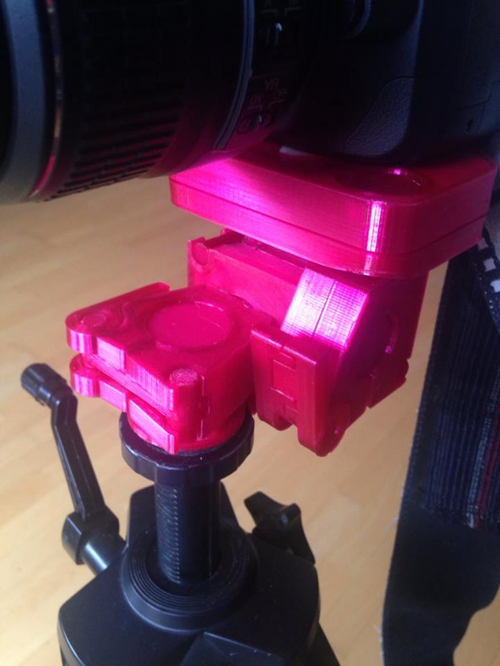

My old head from the 80's broke a while back, and numerous epoxy & gluing attempts were getting progressively less successful.
May still just design & print the one broken part, but thought this would be a fun project. It's this: http://www.thingiverse.com/thing:35682
Printed in esun PETg; 6 outlines, 80% infill.

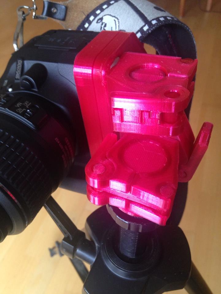

Had to make my own shorter lock pins; the ones I downloaded were too long. (Guessing the plans assume ABS & shrinkage?) Also used hot glue to hold the top part together, and keep it from spinning. (Again, loose connection.)
You can see a bit of the glue in this one -- and the bottom corner by the hole lifted up a bit for some odd reason:
