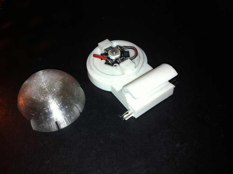

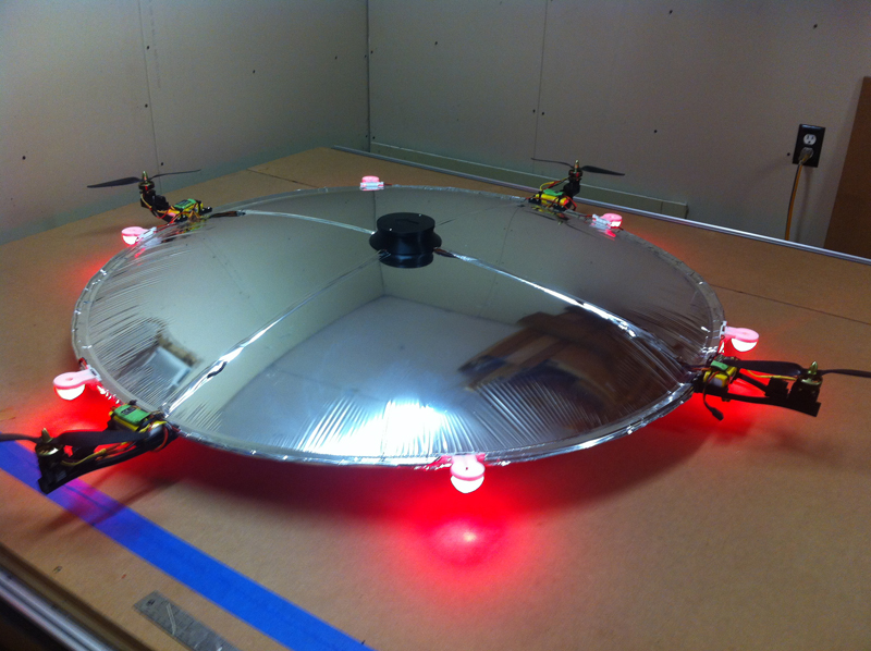

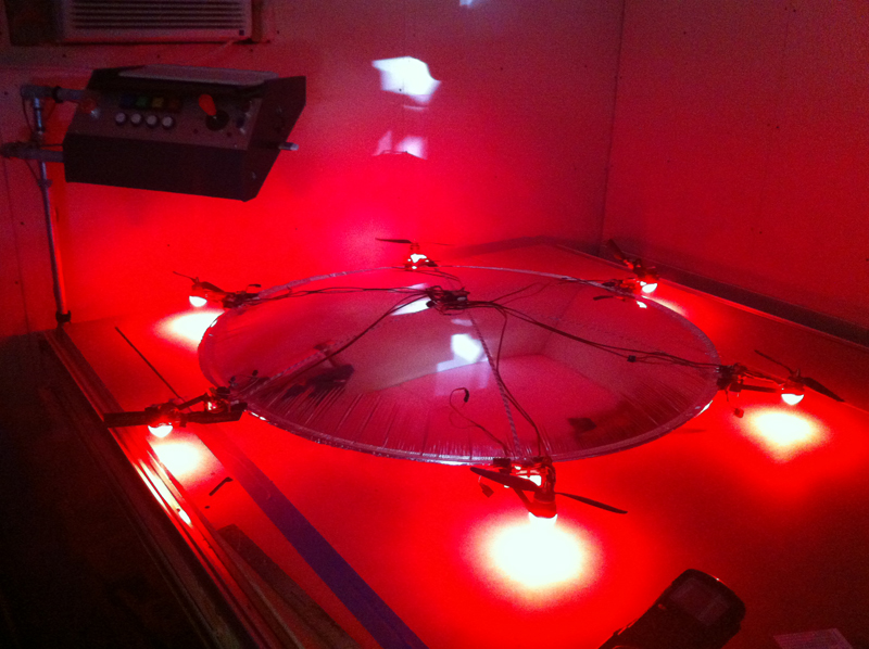

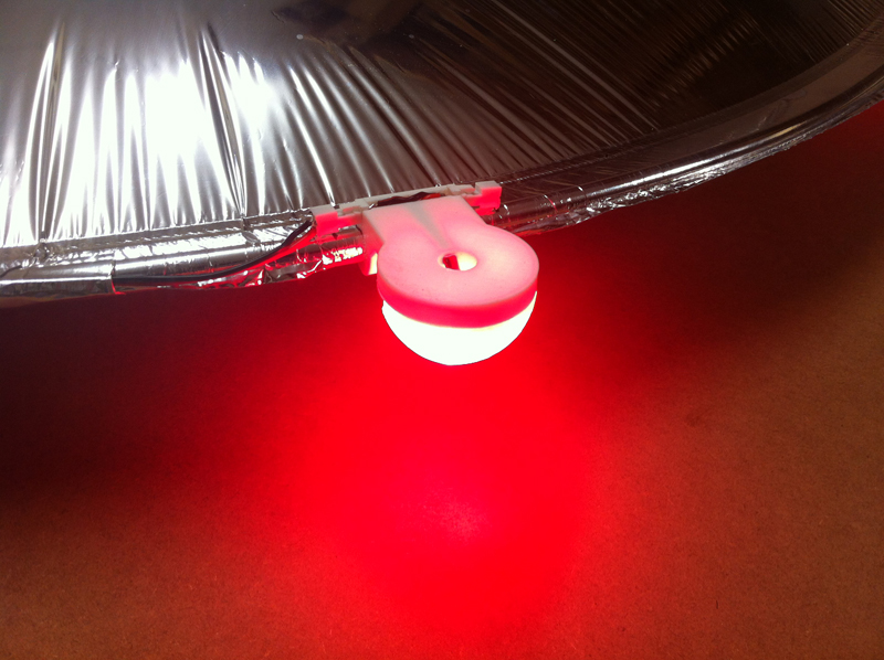

Getting closer on my flying saucer project. I got the high powered LEDs wired up now with the transparent diffuser domes that I talked about somewhere else on this forum. The picture was too cool not to share, I can't wait to get this thing spinning around up in the air. There's still the formidable task of reprogramming the AVR on a stock KK2 quad board in order to pull this off though, so several months before that ever happens.

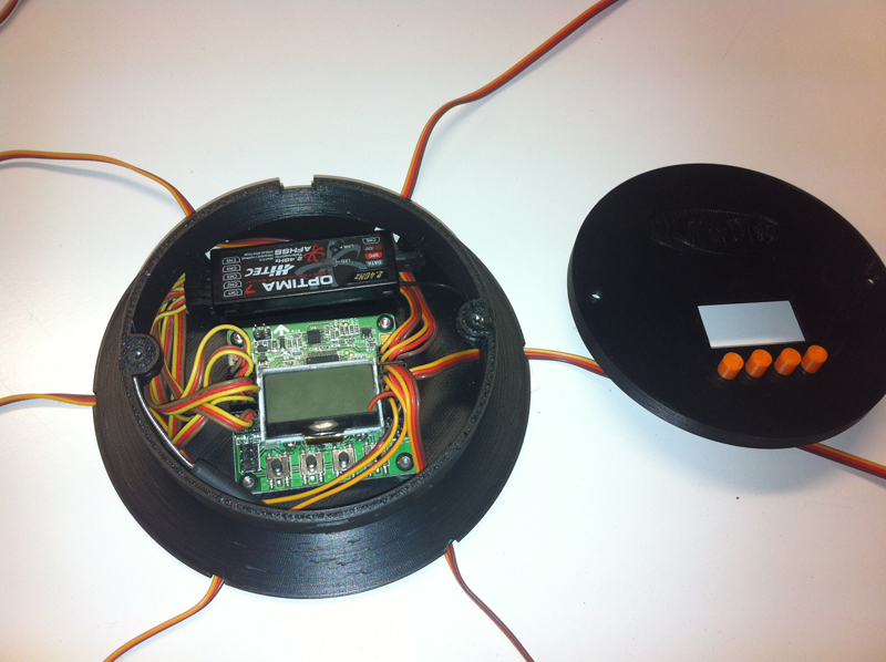

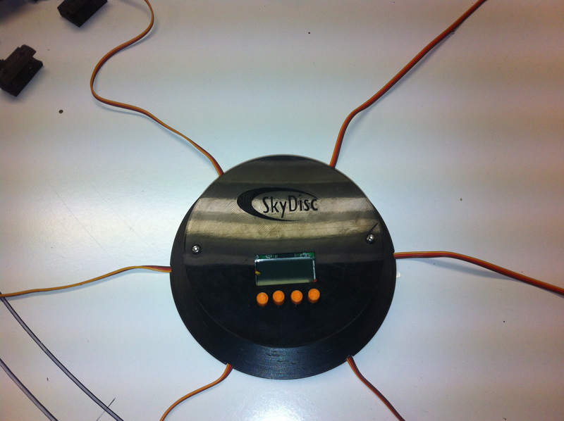

Here's the printed controller housing that sits on top. I call it the octopus.

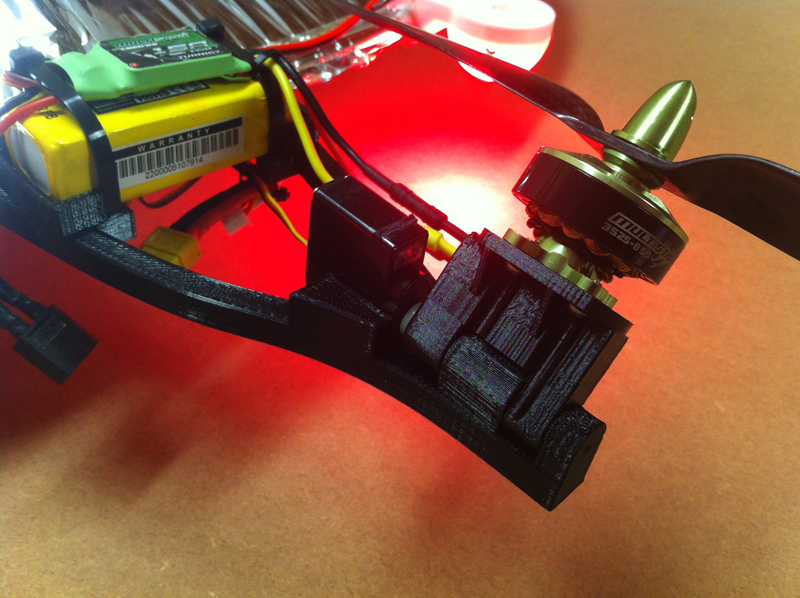

Post by pyronaught » Thu Jul 09, 2015 6:03 am
Getting closer on the saucer, hopefully this is the final design. Ditched the KK flight controller board and am using MultiWii now. All four rotors are tilt rotors with 180 degree range, printed in PETG and strong as hell. I took a hinge apart and put the pieces on an anvil while beating them with a brass hammer-- did not crack any of them. Even tried busting off the fingers, which you would think would break along the layer lines but they did not. Also pounded on the thin edges of the motor platform thinking that would crack off, but nope. That PETG is tough as nails! The diffusion dome on the light is PETG too, but the base is ABS. The lights clip onto the load ring and have pass-through connectors for stringing them in series.
The only thing left now is modifying the Arduino code that runs the Multiwii controller, since there are no stock multirotor configurations that work for this design.
