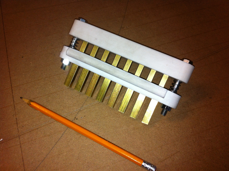

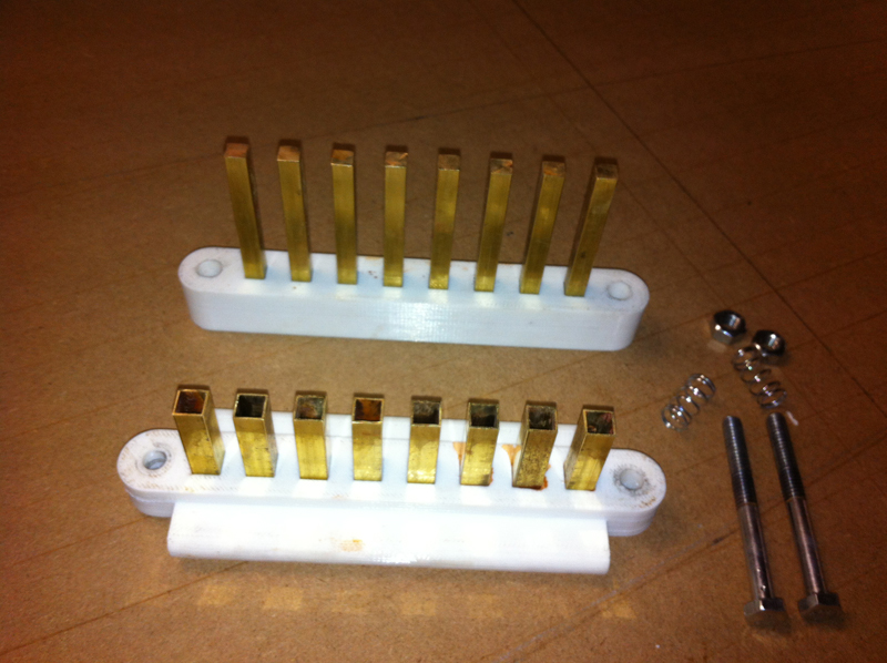

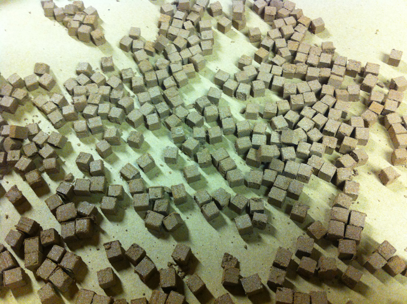

Granted there's a lot of hardware in this print, but the difficult parts that are normally machined out of aluminum are done in white ABS and are tough enough to hold up to the beating this tool takes. The pin plate has 1/4" solid brass pins that exactly fit into the hole plate, with springs that keep the two separated a specific distance. The brass tubes and pins were press fit into slightly undersized holes using an arbor press, and they are very snug and don't budge even though no glue or epoxy is used.
The way it works is you ram the tube end down into a bucket of damp pyrotechnic composition so that it fills the tubes, then you put the tube ends against the surface of a table and beat on the top piece (the pin plate) with a rubber mallet to compress the pellets. Then you squeeze the two halves together to eject the pellets, or "stars" as they are called in the trade. The process is repeated over and over until you have thousands of stars. Round tubes can also be used to make cylindrical stars, I'm just using square tubes to show off what 3D printing can do that would be pretty difficult to do with metal working tools. This might actually be the first square star pump ever produced :)

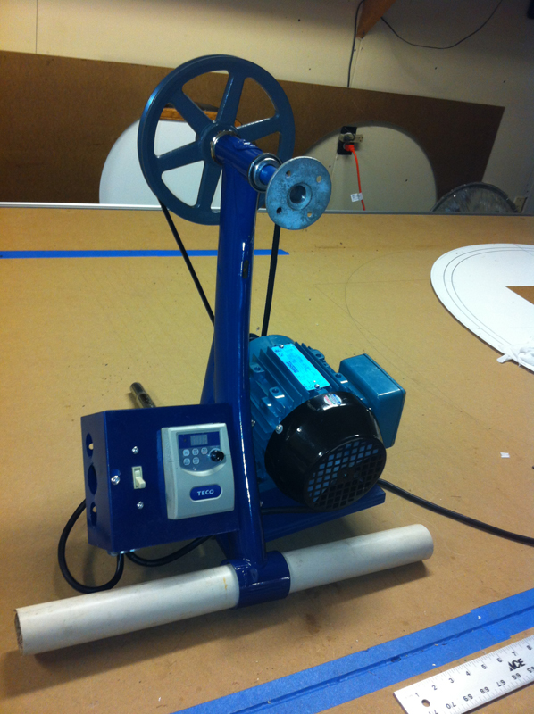

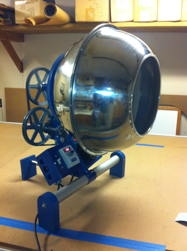

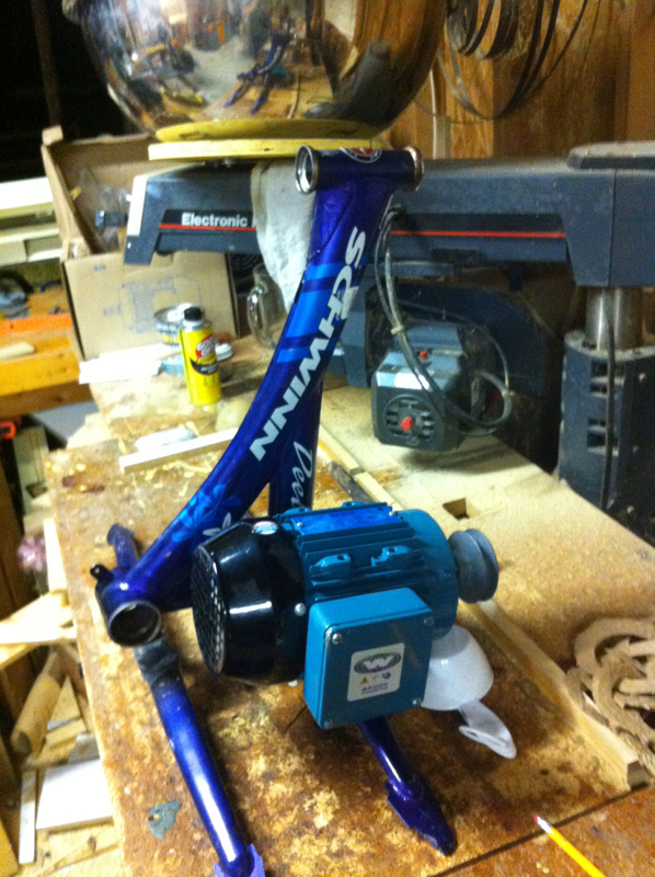

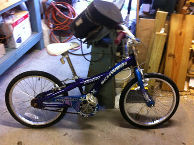

I've designed seven different rolling machines too. The latest one was made from a bike frame and two large stainless salad bowls seen below. I post plans for how to build these on my website at passfire.com. I try to stick with commonly available hardware store parts as much as possible and avoid requiring expensive metal working tools to make the projects more accessible.

Are you doing pyrotechnics for a hobby or profession? I love your roller as much for how it was made as I do the final result. It reminds me of the machines I have seen in candy factories.

The rollers that candy makers and drug companies use for coating pills do operate the same way and are just larger versions. Jelly beans are made in big drums using the same principle. Chocolate coated nuts of all kinds are rolled in big drums as the chocolate gets sprayed on, except they have big tubes that blow in cold air to harden the chocolate faster.

The stars just burn with a specific effect, such as a color or some kind of tailed streamer. They are arranged on the inside wall of the shells so that they get thrown out as shrapnel when the shell explodes, then their effect is seen moving through the air. For example, the cubes in the picture above burn bright red, so you would see red points of light spreading out in a spherical pattern. If I added flakes of titanium to the red mixture, that would add white sparks that get left in the wake as the star moves through the air, creating a silver tail. Metal powders increase brightness, while larger metal flakes create spark tails. Carbon particles such as charcoal or lampblack create thicker, dim gold tails. It's also possible to create strobe effects with formulas that burn in short bursts of light with delays in between. There's hundreds of formulas for all different kinds of effects.
