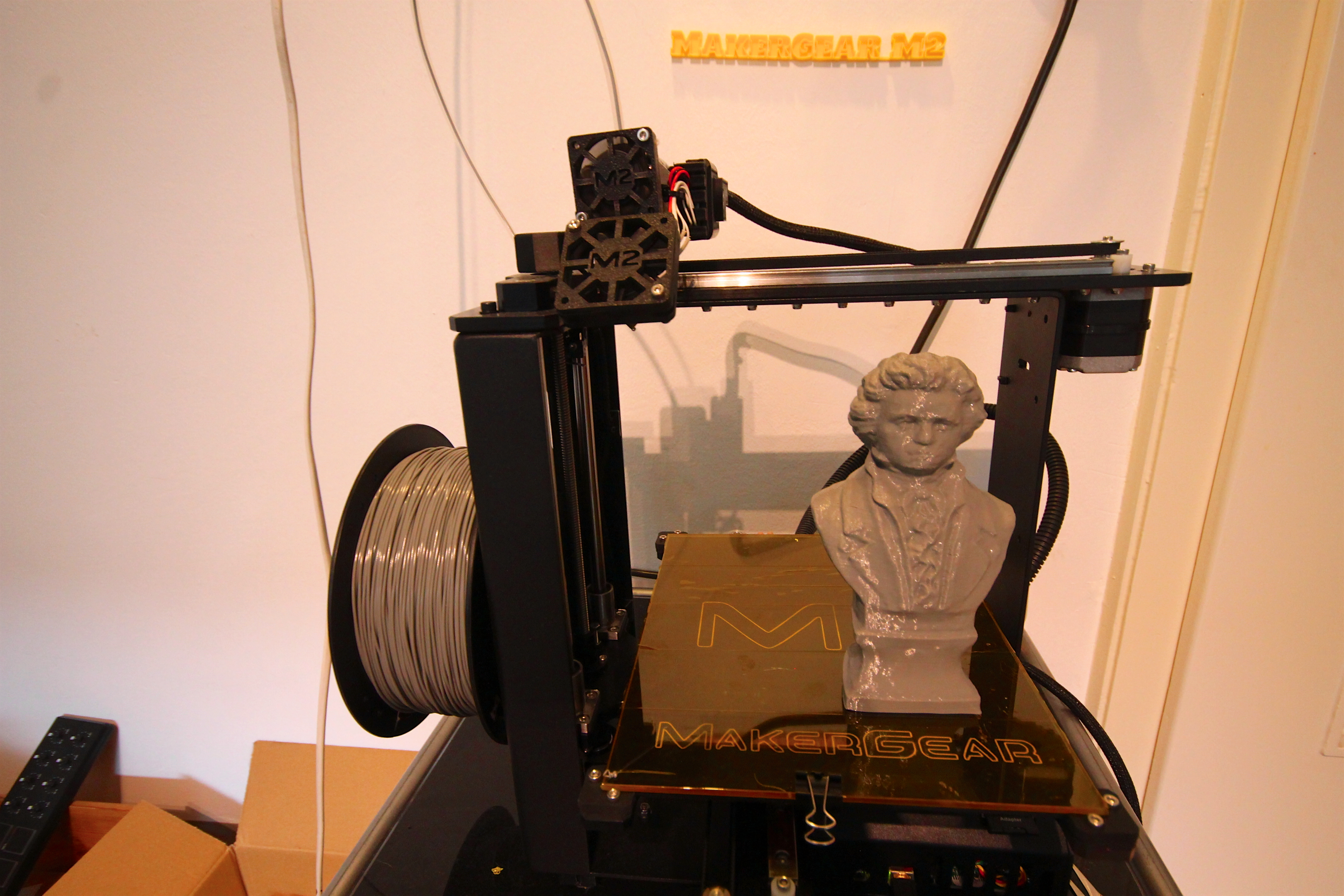

Ludwig van Beethoven Bust - one of my favorite composer
http://www.thingiverse.com/thing:191218

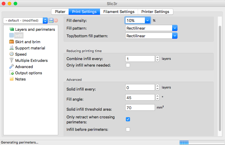

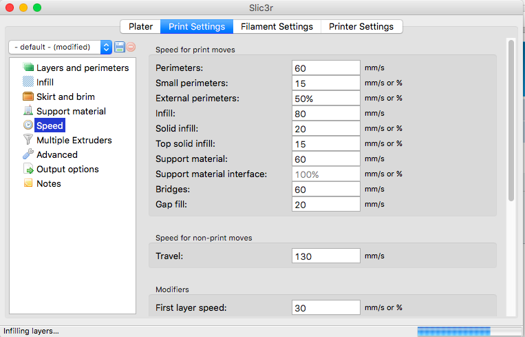

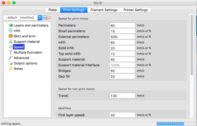

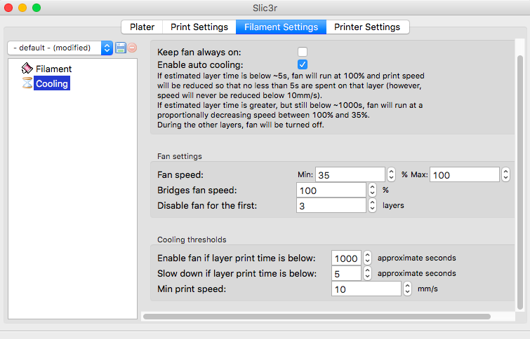

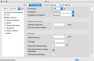

You should post some of your profile settings, looks like your getting good results.
Re: Ludwig van Beethoven Bust
I sliced it with Slic3r
1.75mm PLA
Extruder all layers 220°C
Bed all layers 60°C
1.75mm PLA
Bed all layers 60°C
