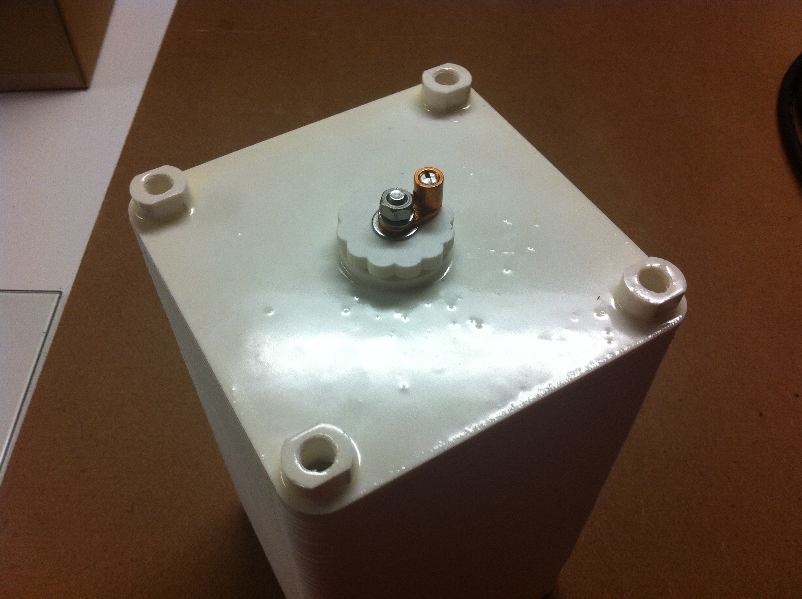

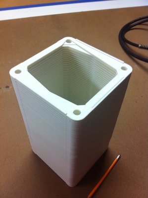

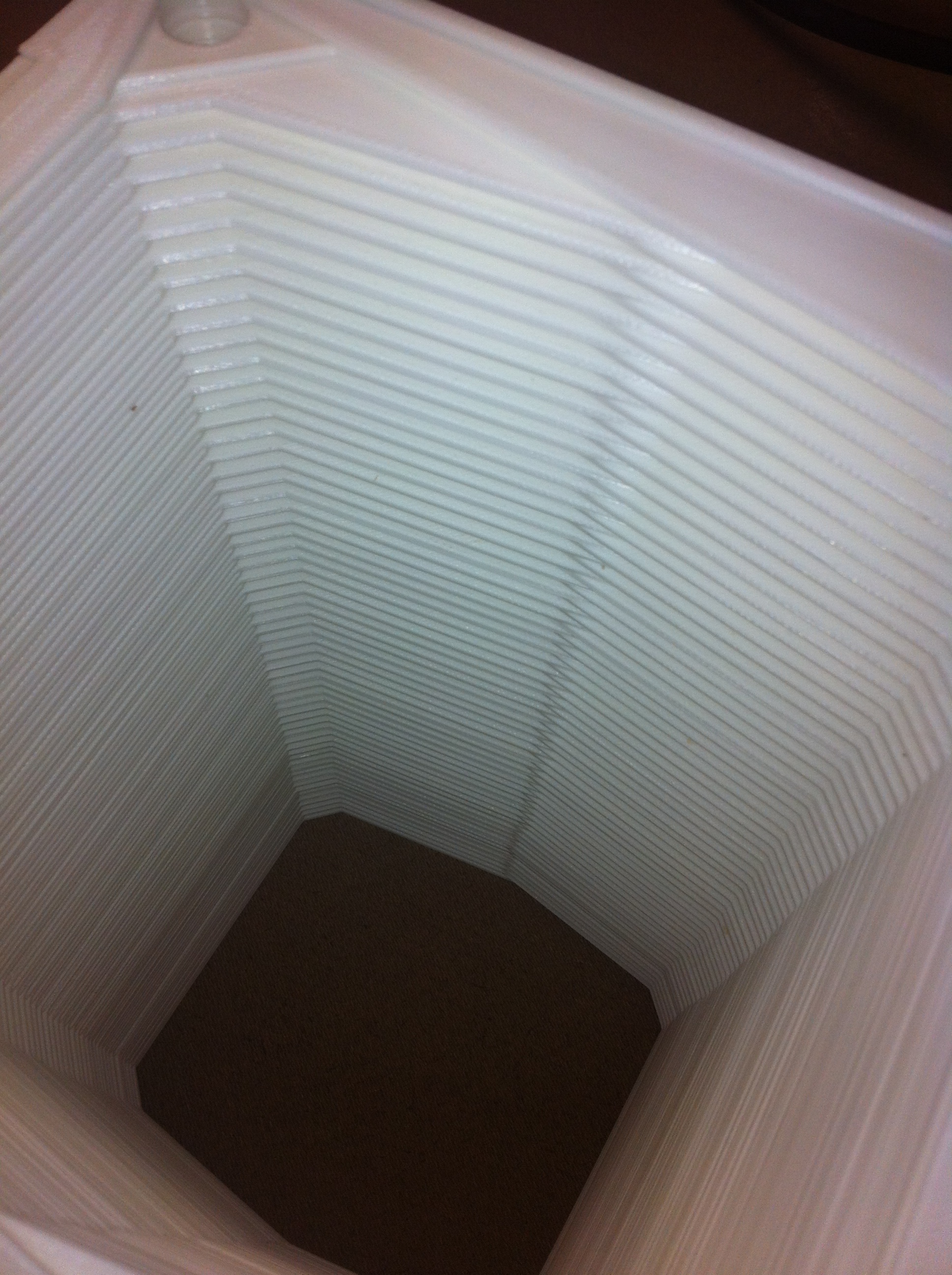

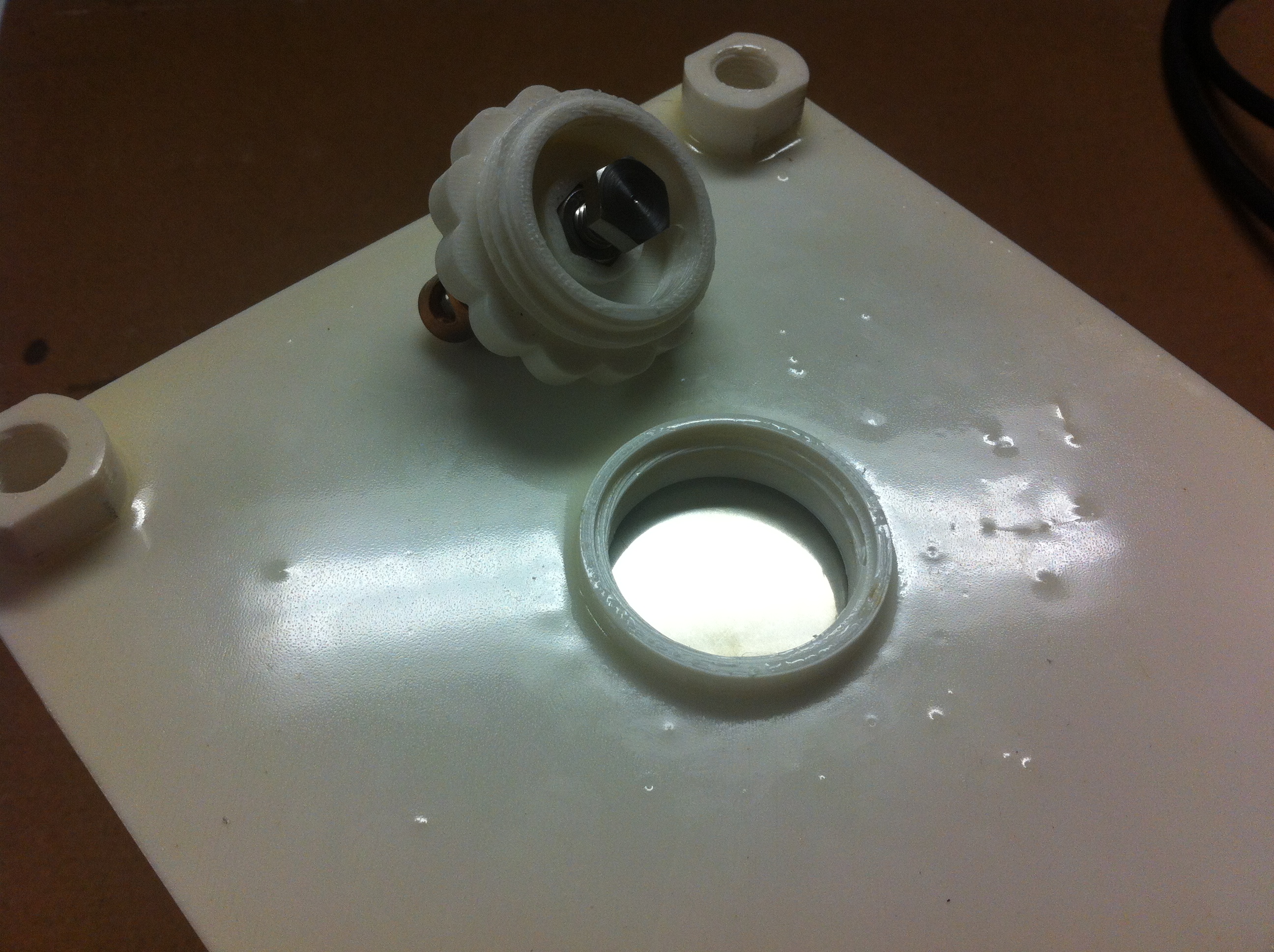

My last print of 2015 was the final frame to finish off this monster 120+ hour print job. Now I have all the pieces to build the big-daddy hydrogen generator :)

Whew! What a big print job.
When you get it all put together how much hydrogen can you produce per hour?
pyronaught
Posts: 684
Re: Hydrogen Generator
Post by pyronaught » Sat Jan 02, 2016 2:56 am
lem wrote:Whew! What a big print job.
300 Liters per hour, or about 10.6 cubic feet.
