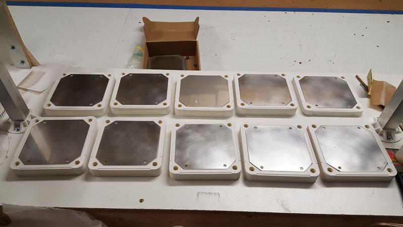

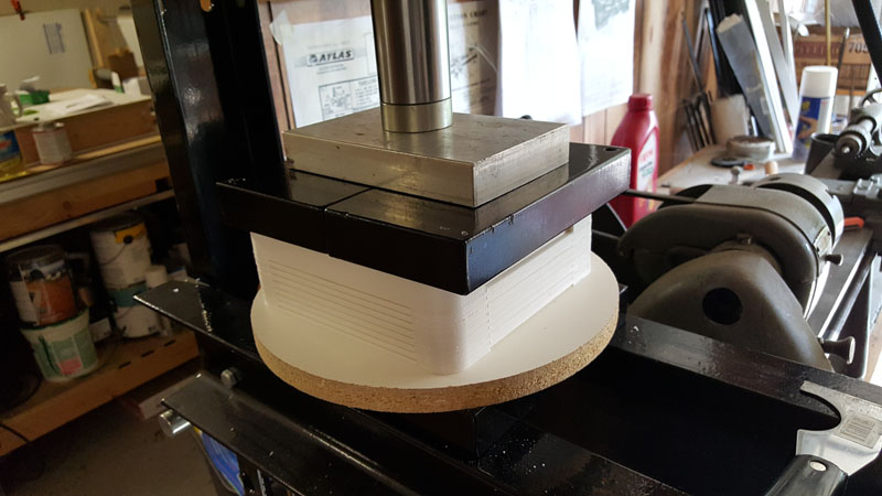

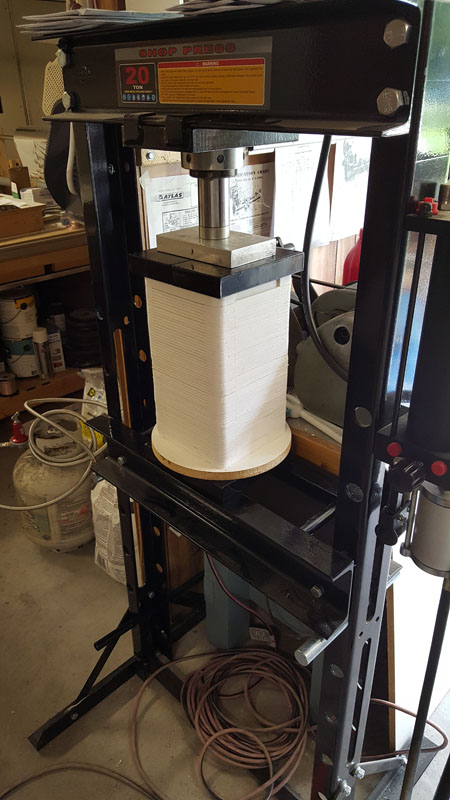

Six months after starting this project I finally get around to assembling that huge stack of printed electrolysis frames. It will still be a few more days before I find out if I made a usable hydrogen generator or a $400 door stop. It took three solid days to make all the screens, clean the plates and assemble that thing!
