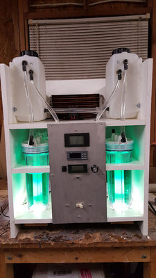

Post by pyronaught » Mon Jun 20, 2016 4:00 pm

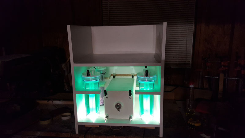

I'm building a compact, portable rolling cabinet for the hydrogen generator now. I've decided to go for a nuclear reactor type of look :)
I just put food coloring in the bubblers and then stuck LED puck lights under them, but you have to admit that it looks pretty cool! The effect is even better when the unit is running and you have all the bubbles rising up through the green glowing canisters.

Getting close to finishing this thing. Got all the plumbing done, control panel installed and cooling system installed. All the components are there, the only thing left is doing all the electrical wiring.
