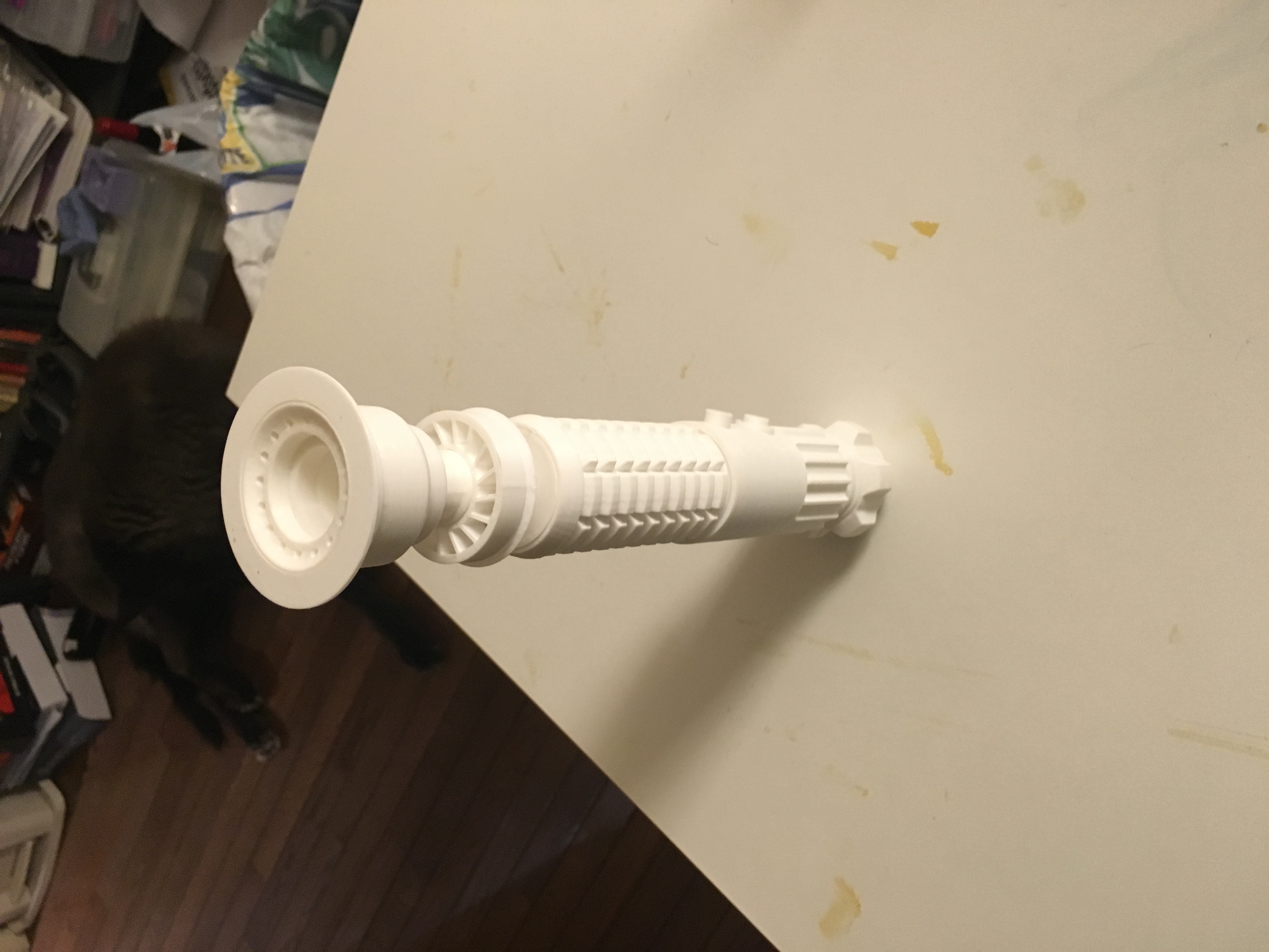

This is the 14-piece version I saw on Tested. Comes apart for easier finishing. https://ultimaker.com/en/blog/87-3d-pri ... nting-tips

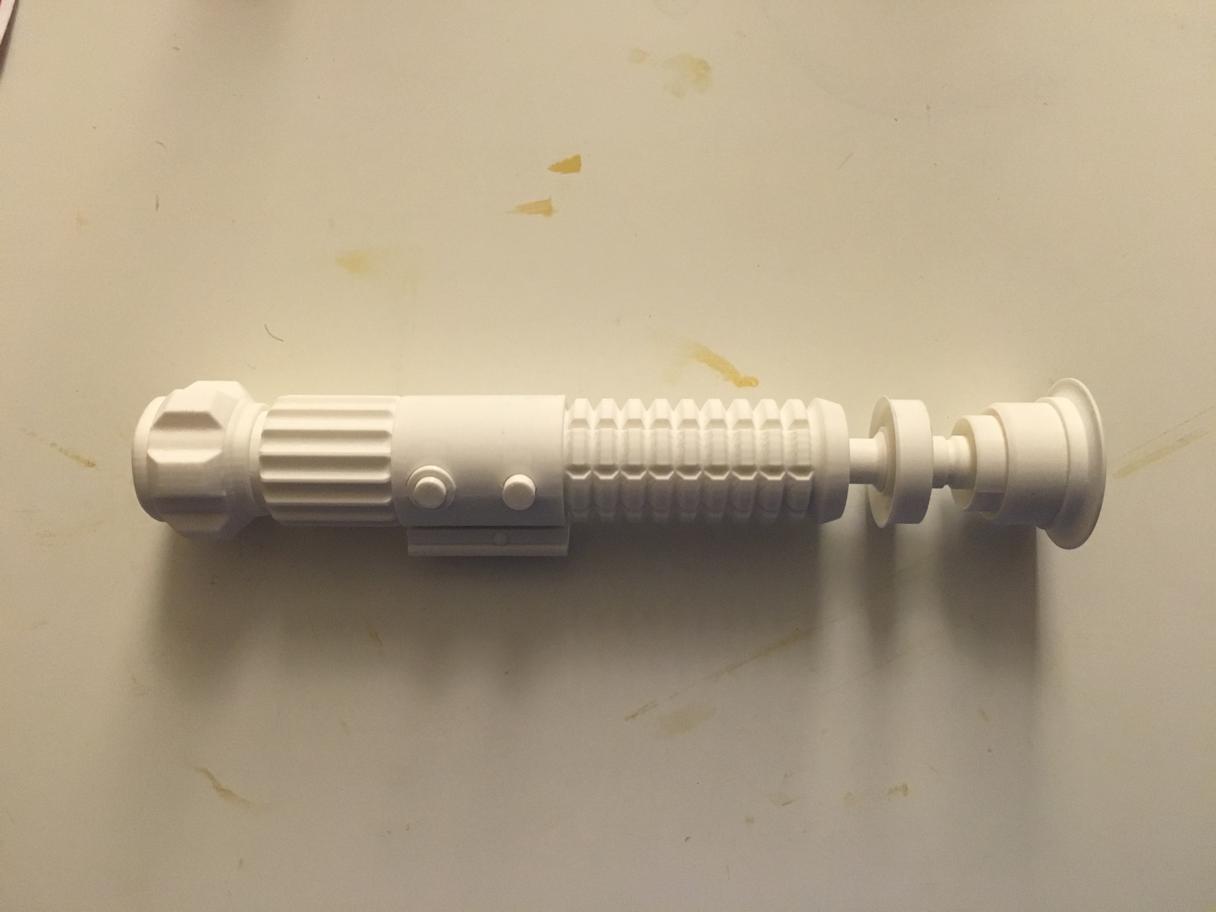

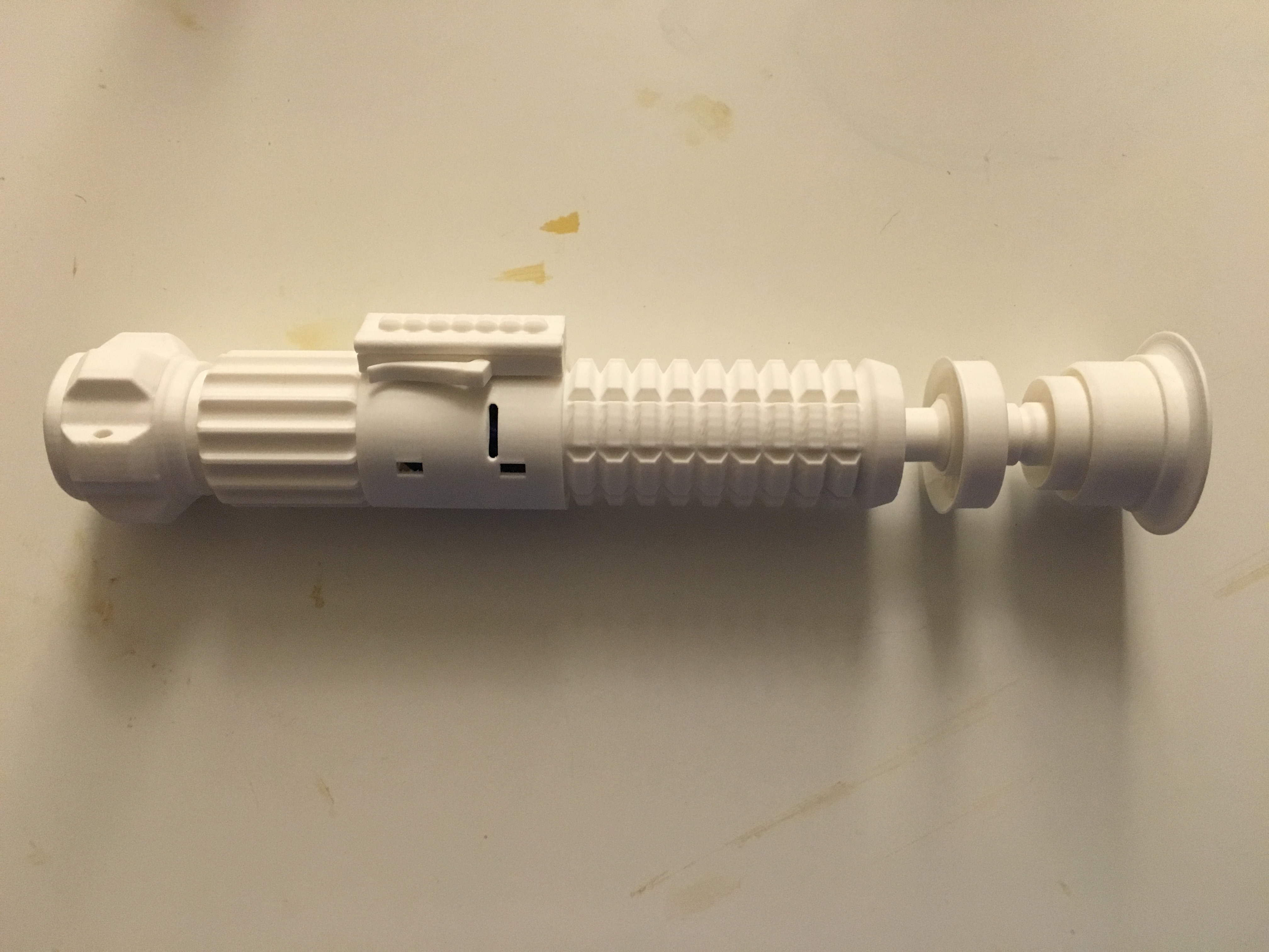

White PLA, not yet finished. Well designed, except every tolerance is too tight, filing is required for assembly. The connectors and switch/pin are very fragile; I reinforced with superglue for strength. The inner spring "core" which holds the buttons in place must be from PETG or ABS, PLA is too brittle.
