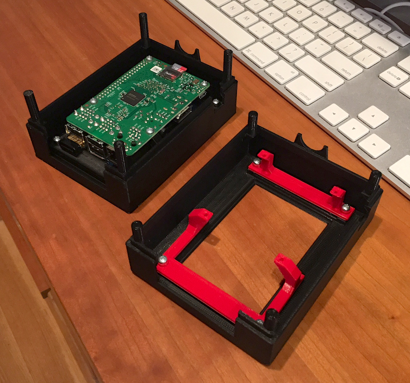

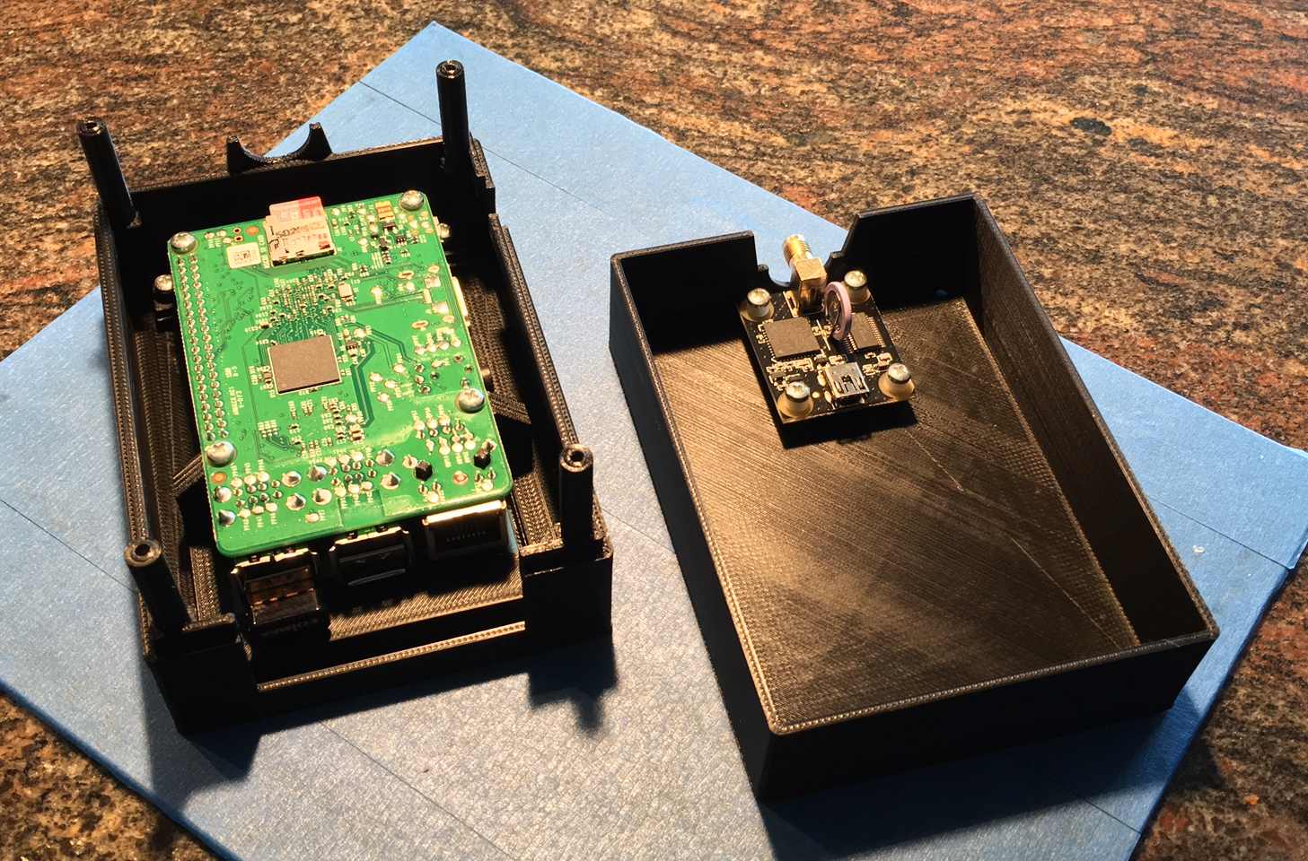

The print is composed of 4 pieces: the front and back shells, plus two pieces which serve to hold the LCD touchscreen in place and support the Raspberry Pi (which mates through a connector to the LCD screen) in the proper place. There's also a 3-axis accelerometer/compass/gyro board (currently mounted on the back of the LCD display) and a GPS receiver in the case. In one photo below the second revision of the shell has the support pieces printed in red filament.
First and second revisions... second revision with red mounting supports
First revision front and back with parts mounted inside

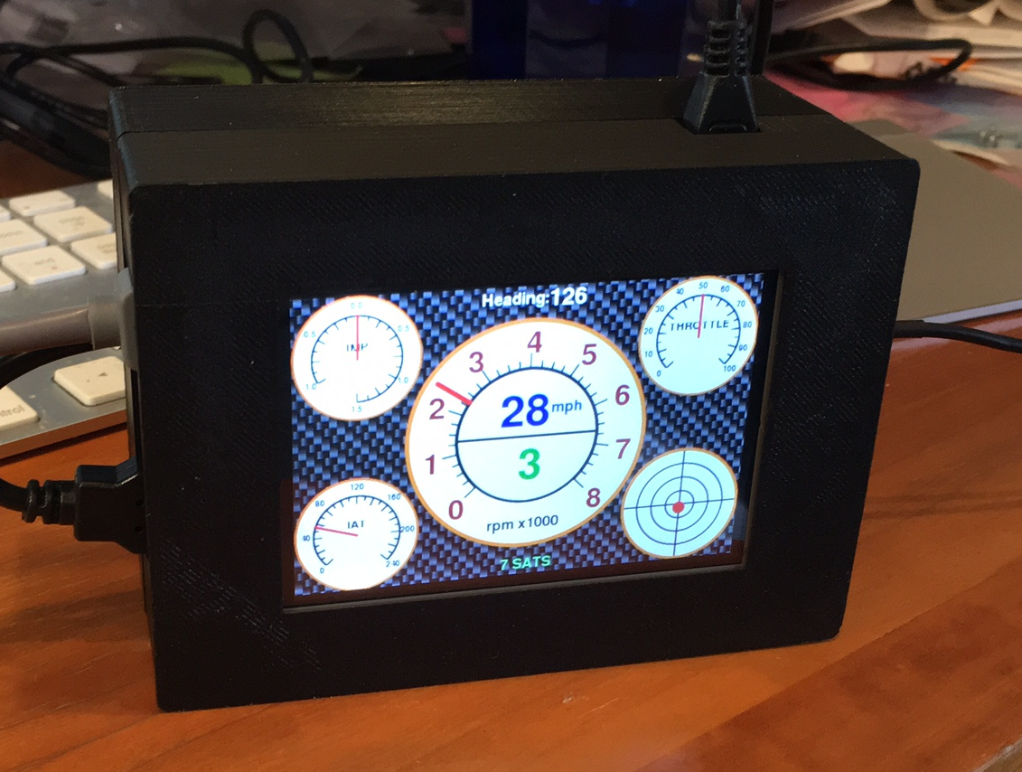

Logger program running

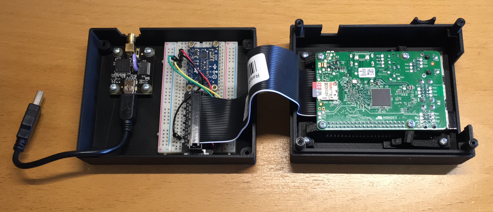

Revised version of the enclosure: now with the breadboard installed (and 3-axis accelerometer/gyro/compass moved there) and reoriented GPS receiver. When closed, the box is 4.5" x 3.5" x 2.25"
