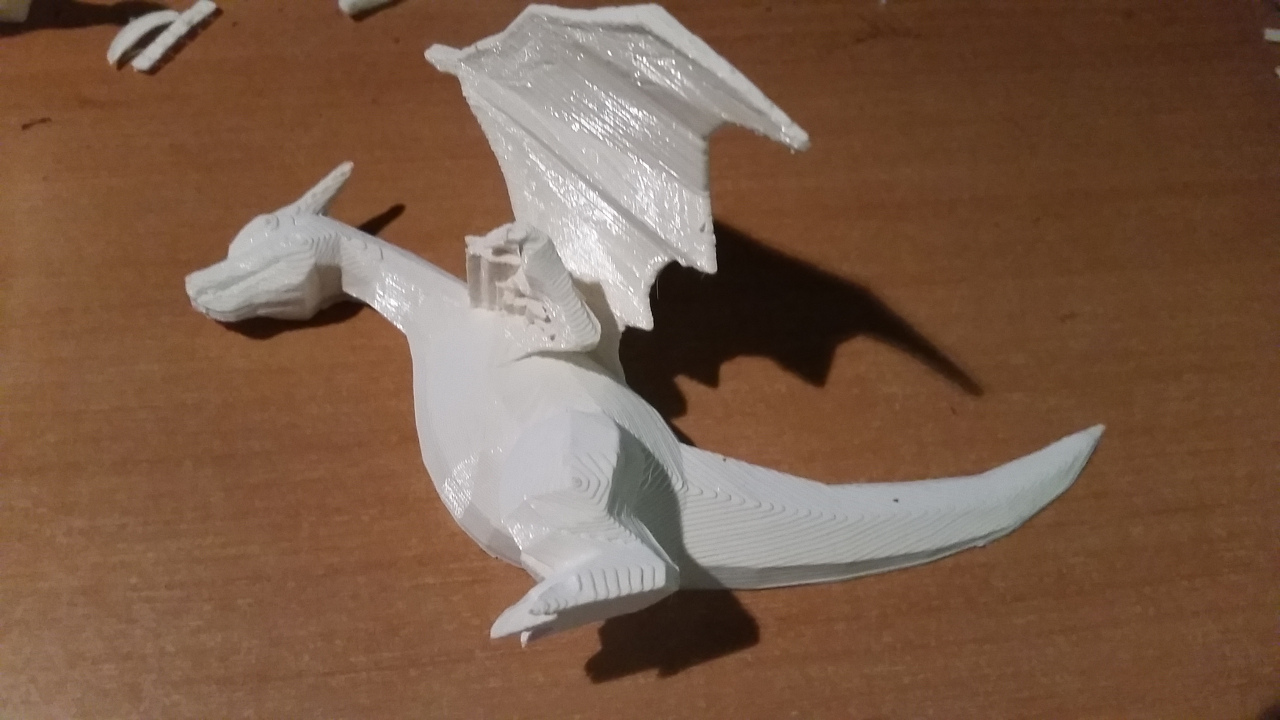

Yeah, I had cut mine in half for one attempt in ABS - got the upper half (wings and head) OK [slightly frayed at the edges of the wings, but not too bad]. Bottom half screwed up with tail rocking out of place. Probably should have tried cutting the tail off too - might give that a shot if jsc's model doesn't help.ednisley wrote:Thingiverse seems to attract models that are artsy and impossible / absurdly difficult to produce with consumer-grade printers.
I'd amputate the wings & tail & maybe the head, print the pieces aligned in the obvious orientations, then glue everything back together. Might be faster & less frustrating than invoking heroic support structures ...

I have a .25 lift at the moment and have tried all of the supports at some point or other (not all with this particular model though - ended up rectilnear at the time, but may dabble with that again).jsc wrote:I printed a Charizard. I don't think it was exactly that one. I don't remember having issues with the tail or supports, but the wing on mine was so thin it would disappear at any reasonable scale when sliced. I beefed up the wing membranes with Meshmixer (model attached).
It sounds like you may be having some bed adhesion issues. Try:
1. Using some adhesion aids on your bed. Glue stick or hairspray work very well; if you're not using either, give it a shot.
2. Calibrate your extrusion.
3. Add a small amount of extruder lift on retraction (.1 - .2mm) to ensure you are not contacting any over extruded bits. Any contact at all on a support will eventually knock them over.
4. Slic3r comes with several different support styles. Try them all!
I have callibrated the extrusion with the 10cm straw and the pen approach, but admittedly, it was with another filament - could try that again I guess.
Adhesion may help with the tail I guess - worth a shot - thanks for that and the modified model.
FWIW, I tried scaling the model I had down by 0.5 and slicing as I mention above, but that didn't work - suddenly had some supports missing and parts of the wings in midair . Not much point trying that then .

Also worth a shot - thanks for the suggestion.Bratag wrote:[quote="charles.yates"Split the model right down the center and print each half laying flat - way less support and more area to apply the support to where it is needed. Then just glue them together.

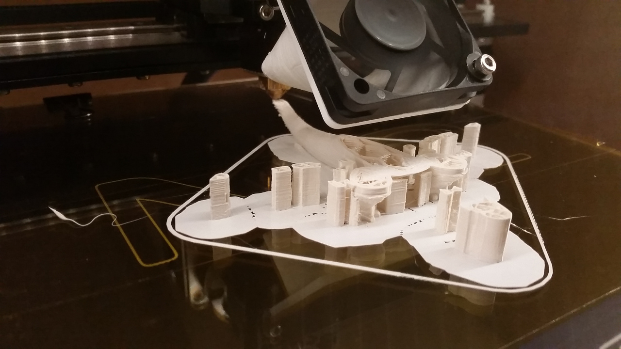

This was my first attempt .

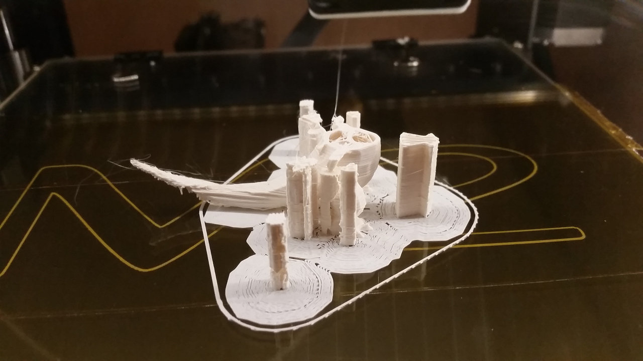

After checking some of the things which jsc advised - improving adhesion (I put down new kapton as it's normally been enough), calibrating the extruder, and using his model, I've arrived at:
Many thanks for all the tips guys .
I have to say, I'm not too interested in the model itself, but I am interested in getting the printer as good as possible, so really appreciate the help from all of you.
Re: Hitman
Is that... better? It's hard to tell what's going on. It does look like you're over extruding somewhat. Your support walls shouldn't have those striations and weird bulges.

Definitely better, yeah - it did complete at least , but the wings came out frayed (left and right extremities completely gone) and a lot of the misplaced filament ended up collected around the mouth . I left it running when I went to bed, so I didn't see precisely what happened.jsc wrote:Is that... better? It's hard to tell what's going on. It does look like you're over extruding somewhat. Your support walls shouldn't have those striations and weird bulges.
